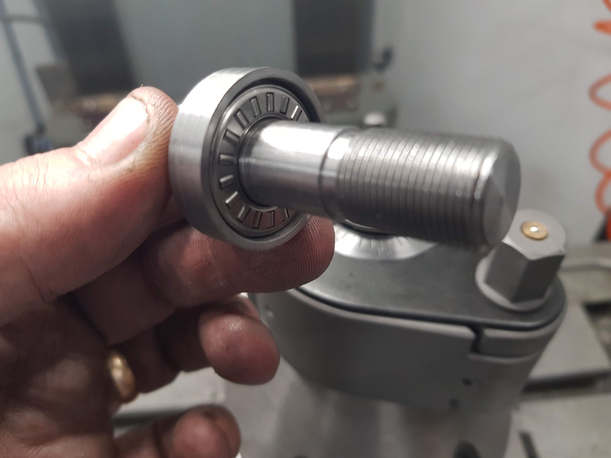

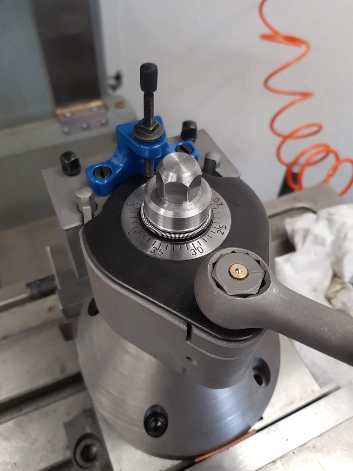

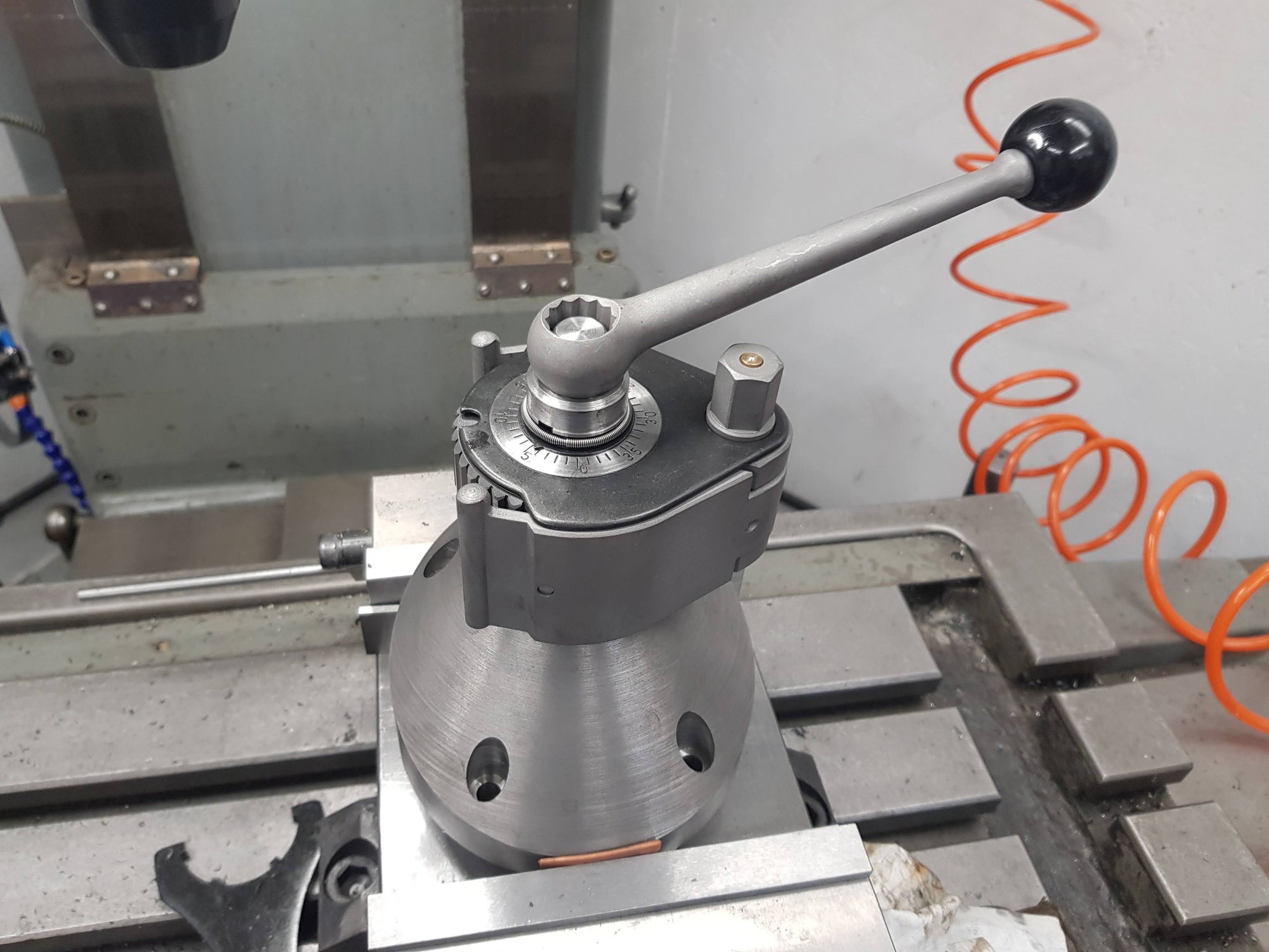

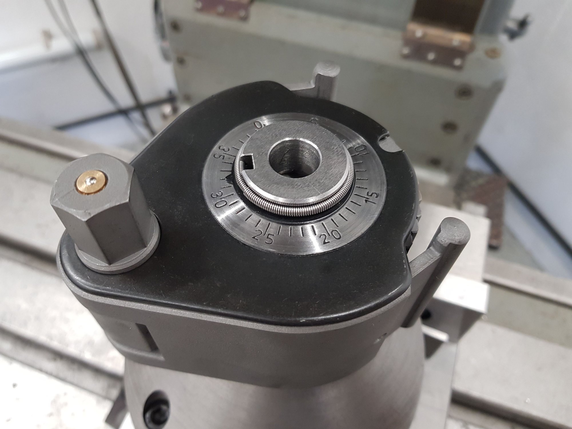

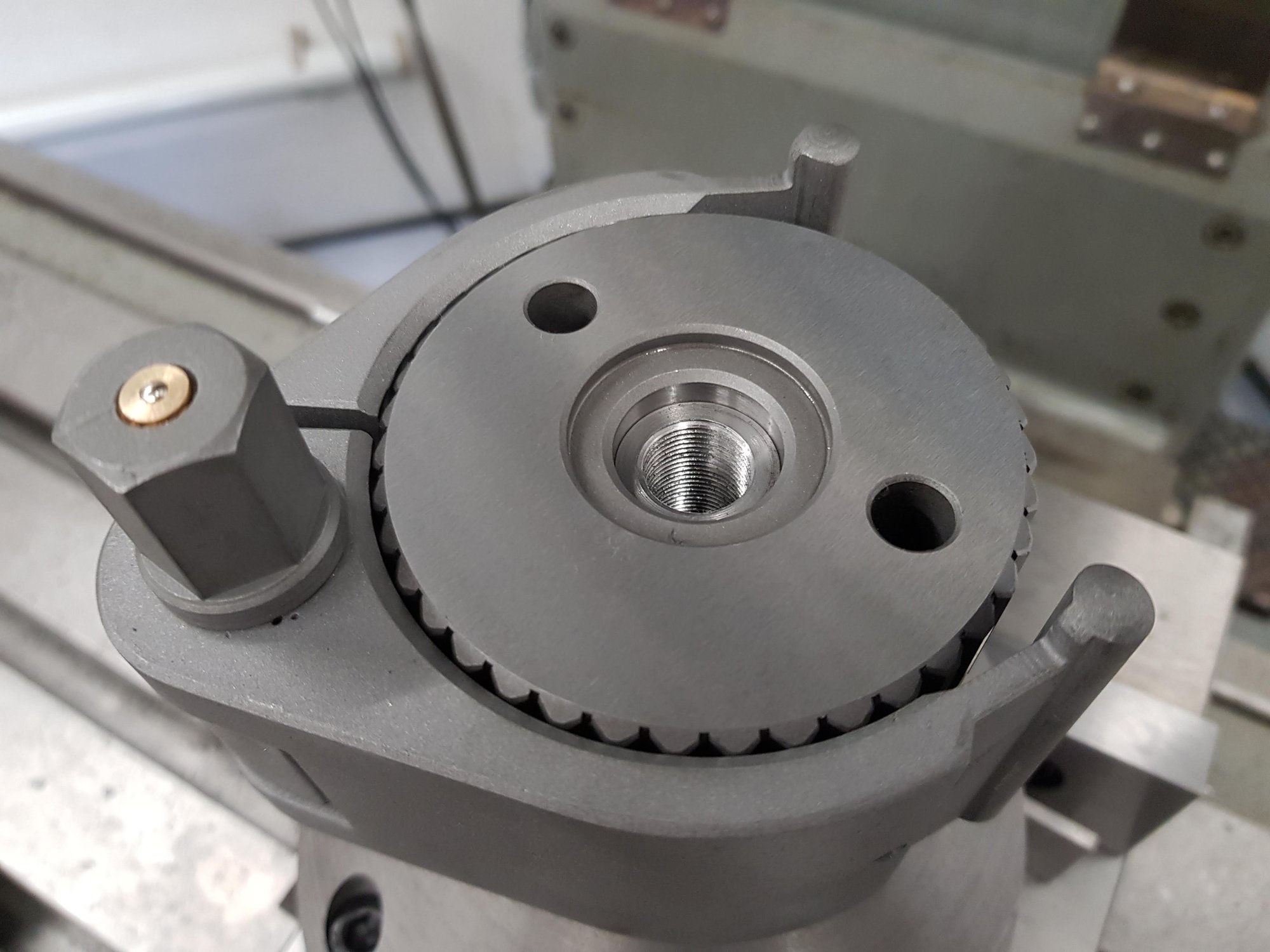

Out of interest, what size is the hex for the E type handle?
About 16.85mm ;-)
I measured the hex on the clamp and it was 16.75, so I assumed the spanner would be 17mm. Machined my hex to 16.95 and the bugger wouldn’t fit so I had to give it another light pass.
