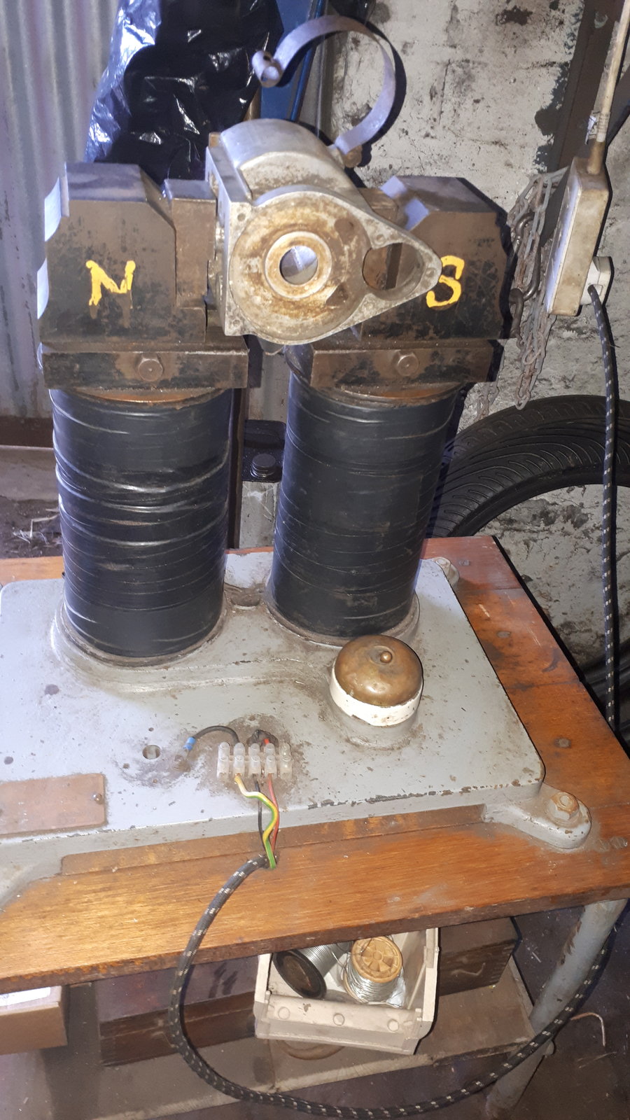

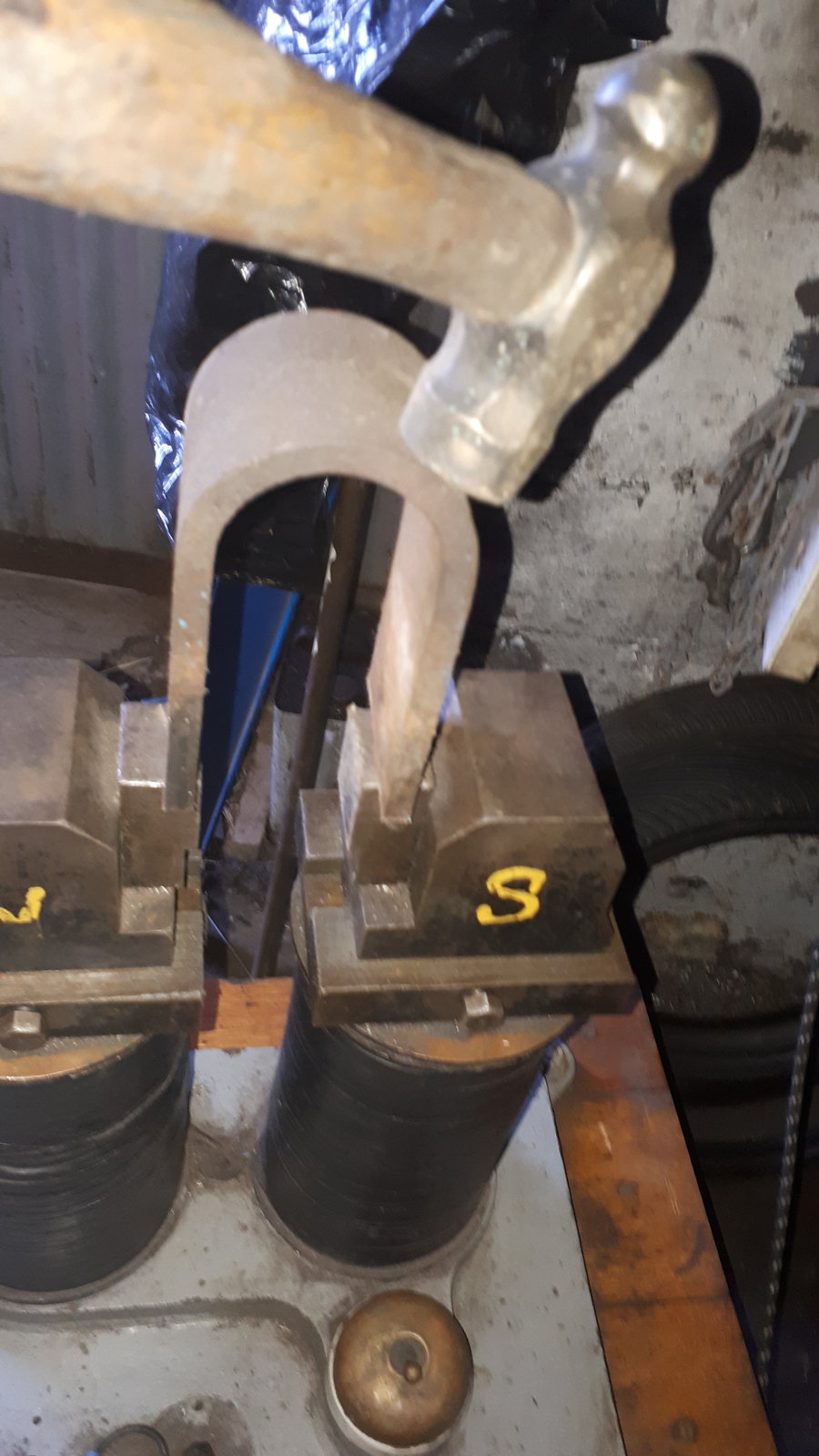

I think that the rotors can demagnetise if they're out of the pole pieces for any length of time.

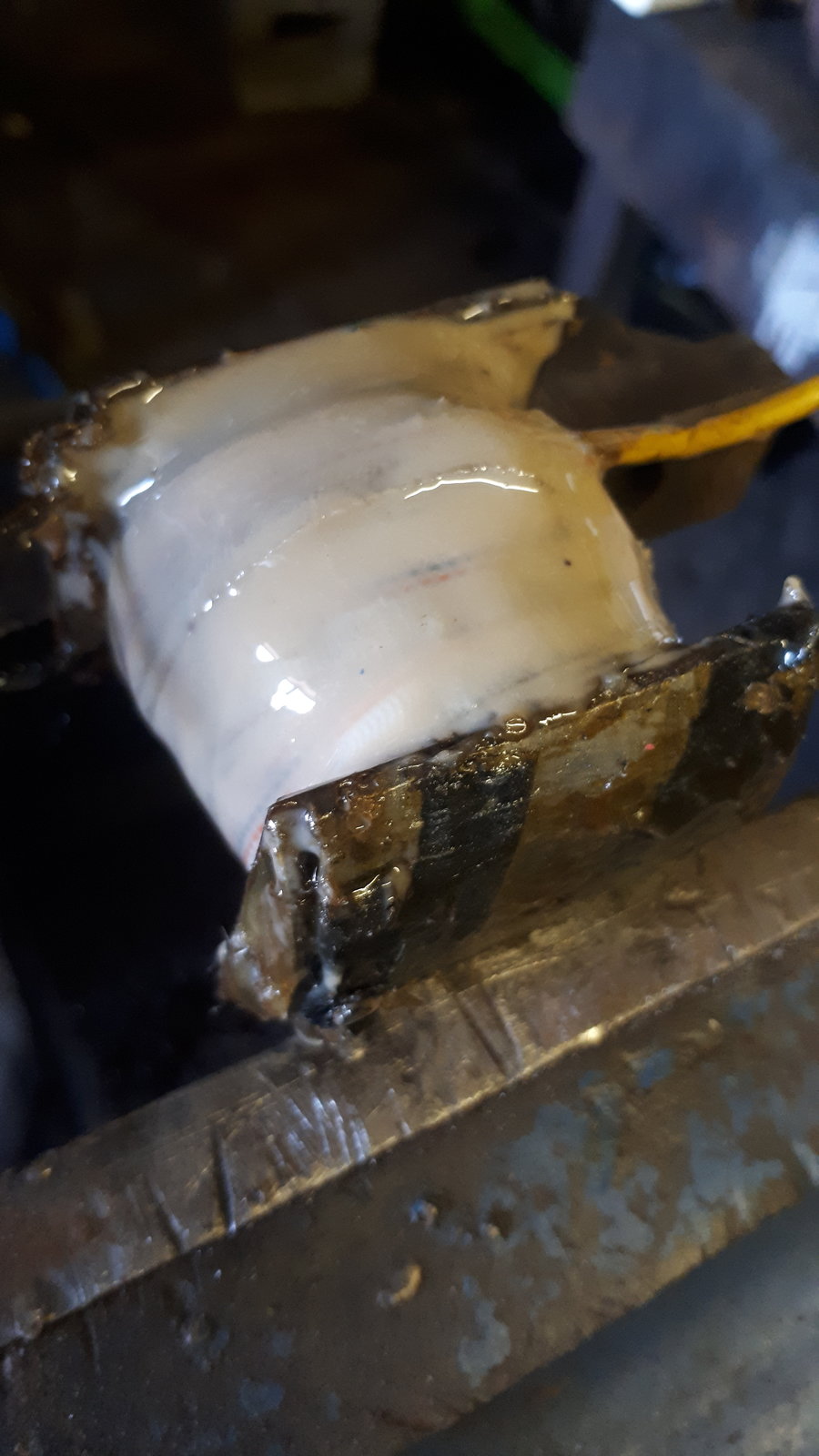

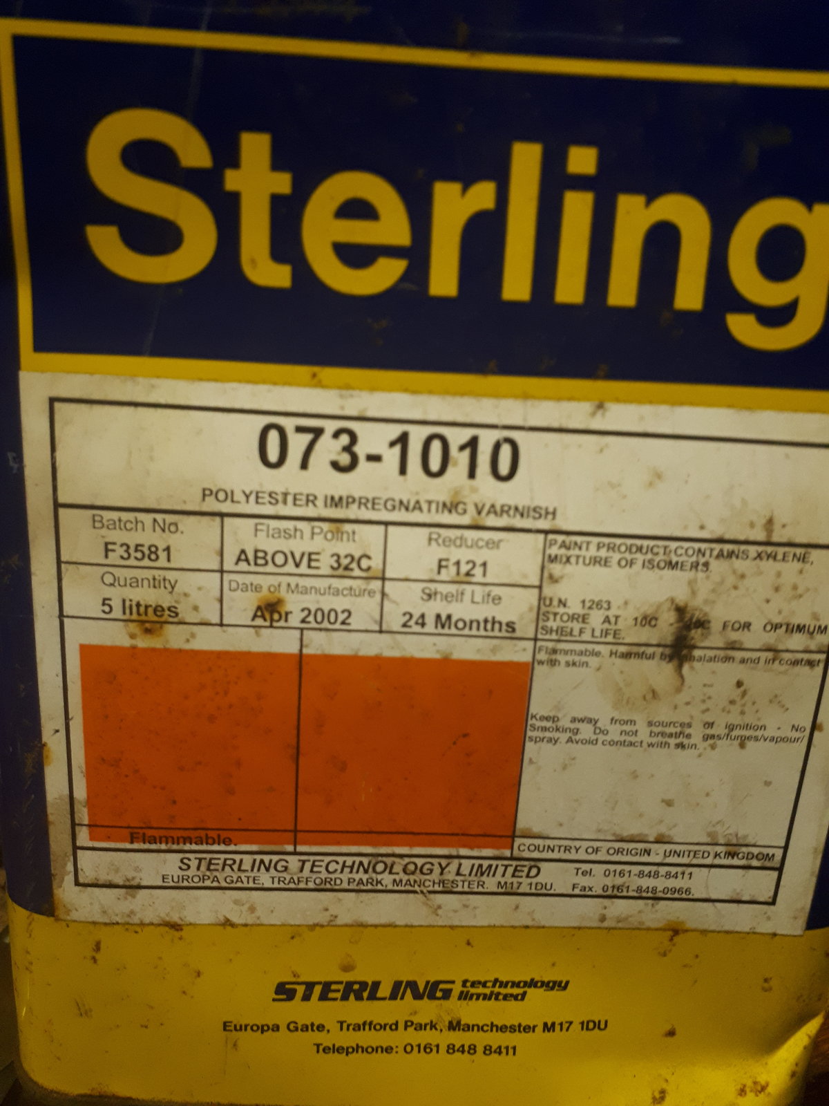

varnish is a heat setting polyester
Which resin do you use? I've a 50 year old motor and I'm thinking about trying to get some resin into the windings to help beef them up a bit. It would just be poured on since I don't have access to a vacuum
you could warm it up and pour air drying anti flash over resin thru it ,the red stuff messy job ,
motor guys wouldnt be keen puttin a old motor in there bath and contaminating[ it
the varnish i use is heat setting polyester it was made by a company STERLING no longer on the go
but a new company WES do all the sterling range and all sorts of coatings

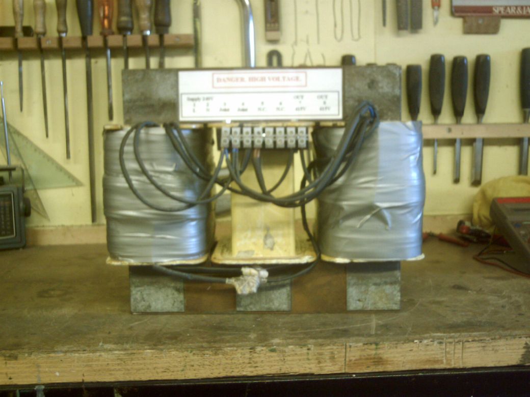

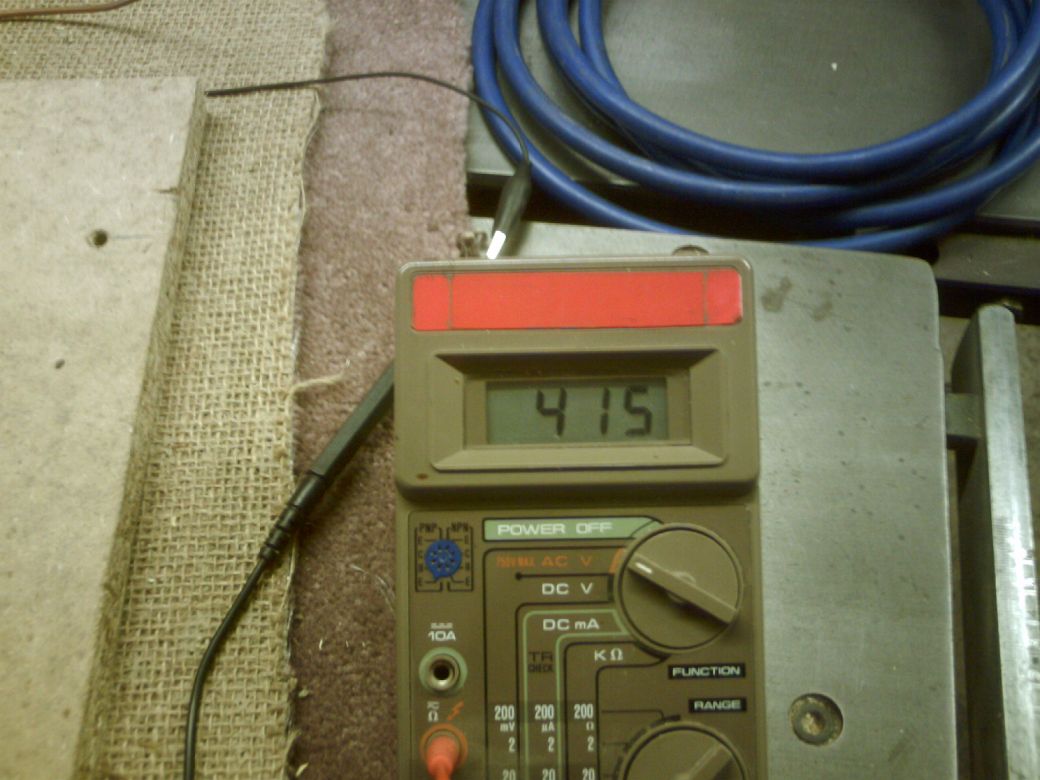

The winding wire I used was enamelled copper and I had a big stock of industrial sized bobbins of many gauges; very thin transformer insulation tape and also special 3 thou thick brown lamination paper was was used; If my memory is correct a small Bush 90 output transformer needed around 3,000 turns of very fine wire which was easy to break. It was great fun but years ago I stopped restoring vintage radios after restoring my only vintage TV and having done this I felt all the challenges were now behind me so quickly lost interest and sold all my winders; test gear and most of my 70 plus collection of radios. The last transformer I wound was huge by home workshop standards it weighing around 75kg; I wound this using conduit wiring to give 3 phase on full power in my workshop to my big industrial machines; over the years I've down scaled and sold most of my big machines and sold the highly dangerous transformer to an electrical engineer otherwise I'd have scrapped it because it would prove lethal if tinkered around with; I installed 3 phase using the home wound transformer for just under £120.
Sorry everyone; I know installing 3 phase is the wish of many home workshop owners but I've been quizzed and doubted too many times about just how good my 3 phase installation worked; I didn't invent the method and I always made it clear the method was indeed unique but on other forums I became fed up of a number of "experts" who had never tried the method knowing better than me who had used the transformer for years and the guy in America who invented the transformer method which I can honestly say works as many visitors to my workshop could agree having seen me switch on my 3 phase industrial bandsaw and 3 phase extractor just as if 3 phase 415V was installed from the electricity company.

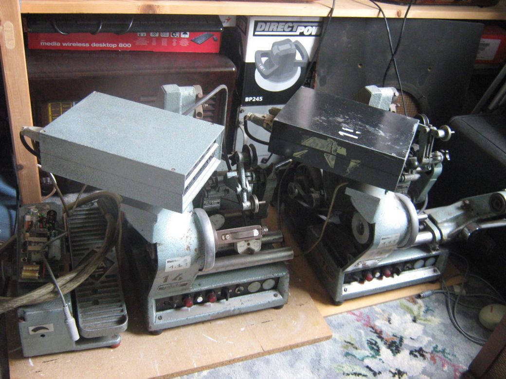

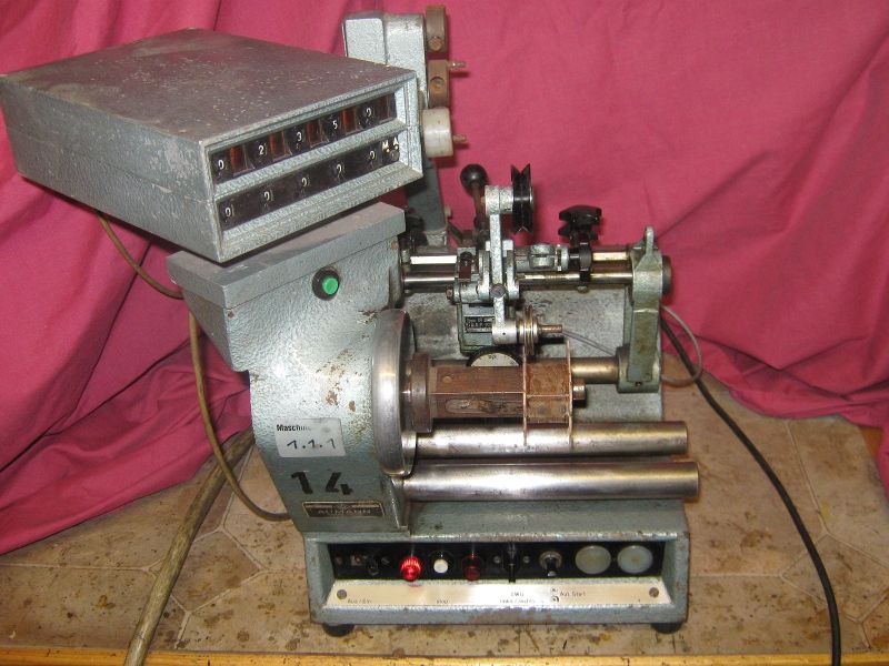

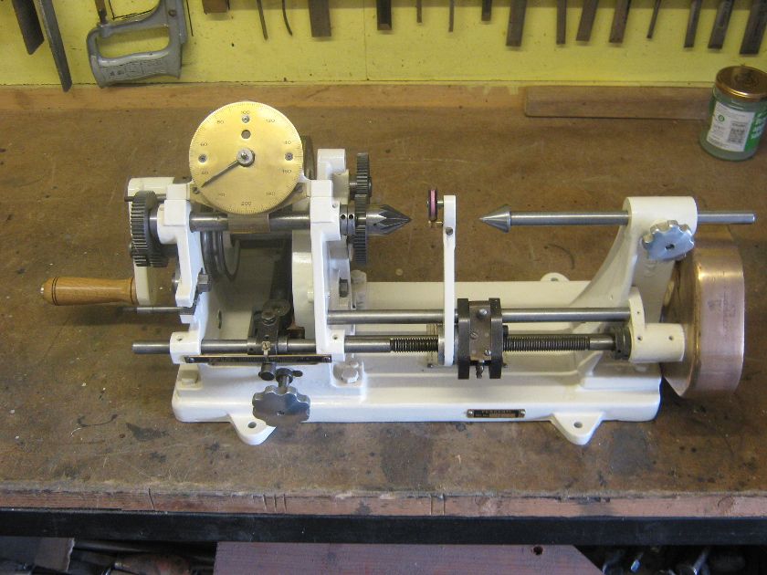

The two German Aumann winders I owned.
A close up.

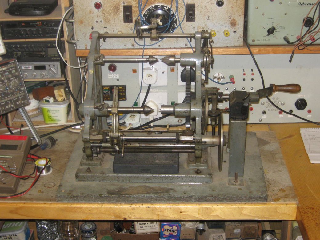

The AVO hand winder I used a great deal.
The AVO wave winder I fully restored and was honoured with best restoration in 2009 by The British Vintage Wireless Society (BVWS).

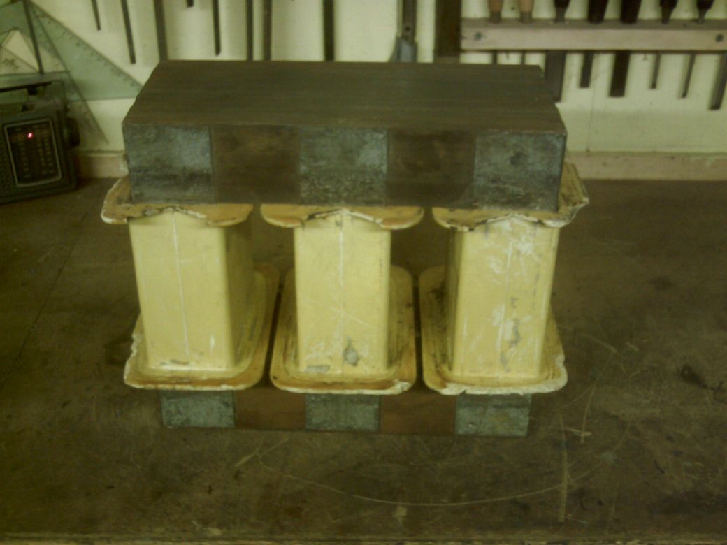

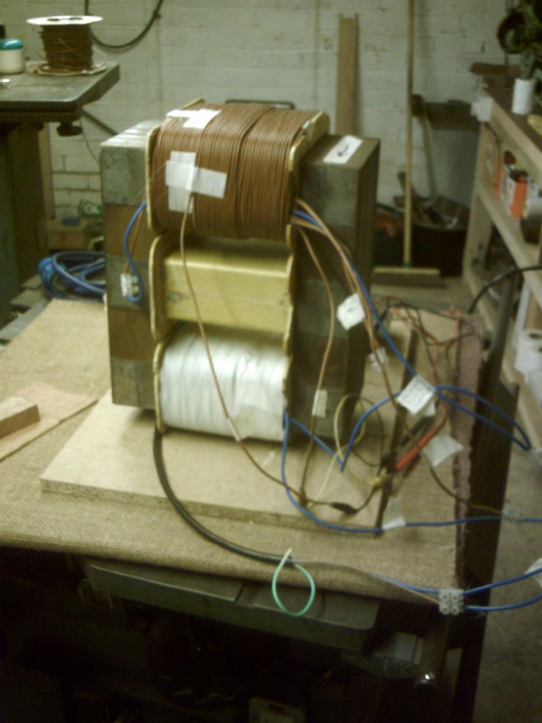

This was the reading from my home wound 3 phase transformer; it doesn't get better than this and I used the transformer for years without the slightest problem.
The completed 3 phase transformer ready to be installed into my workshop; boy it was heavy.
The scrap transformer with its original windings removed now ready for new windings.
Here's the transformer on test hooked up to our mains supply; lethal for a novice to even attempt.

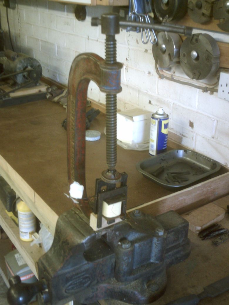

A method I used to insert tight laminations; it worked a treat but great care was needed to drive the laminations home without damaging the former or windings. What fun I've enjoyed over the years and am still learning lots of new things now aged 72; during the last few months I've learnt metal spinning; tig welding (aluminium) and some panel work. I'll have a go at anything which catches my interest; I'm never bored.

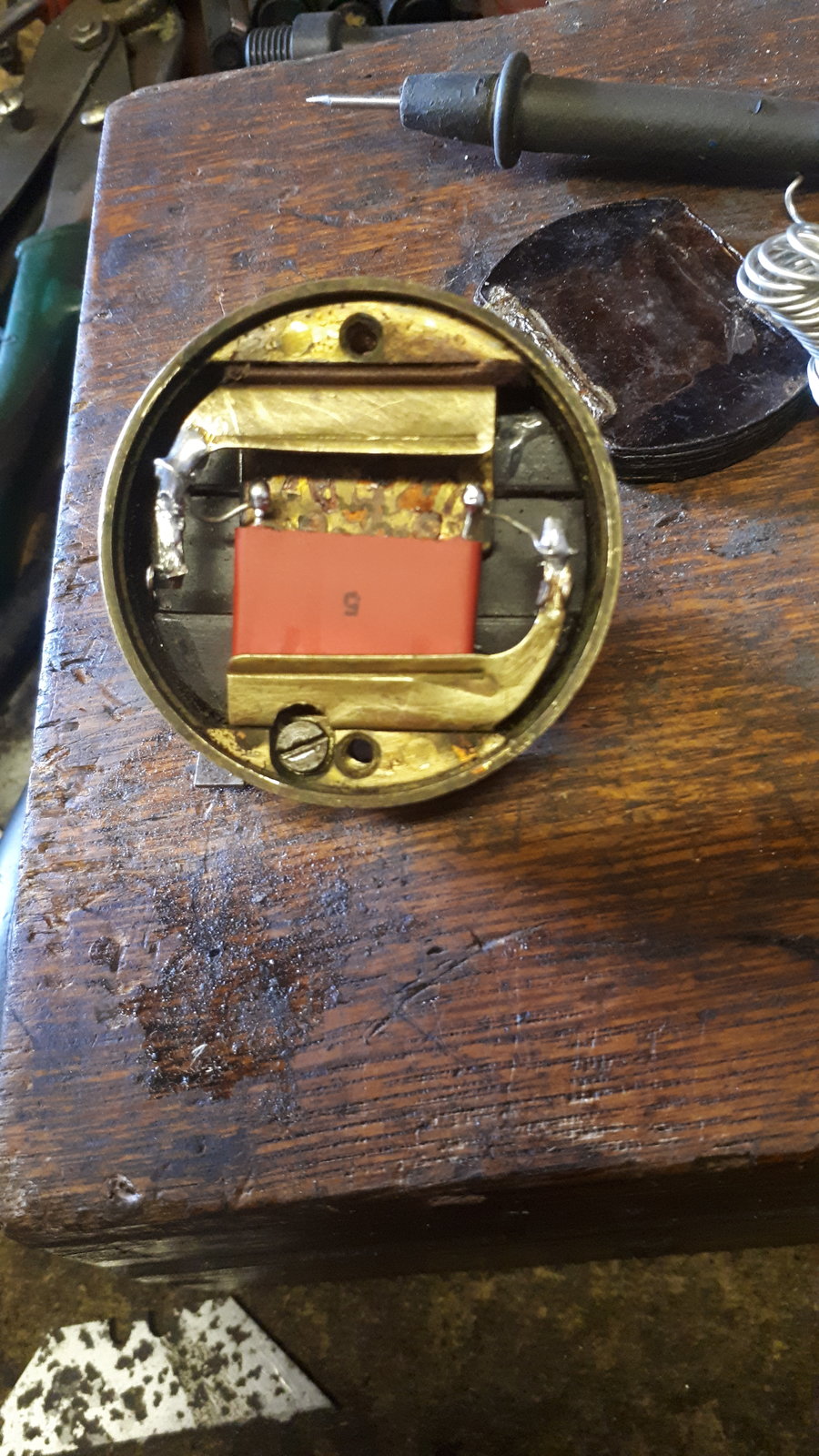

Well done zeppelin builder with your magneto repairs which I find interesting.

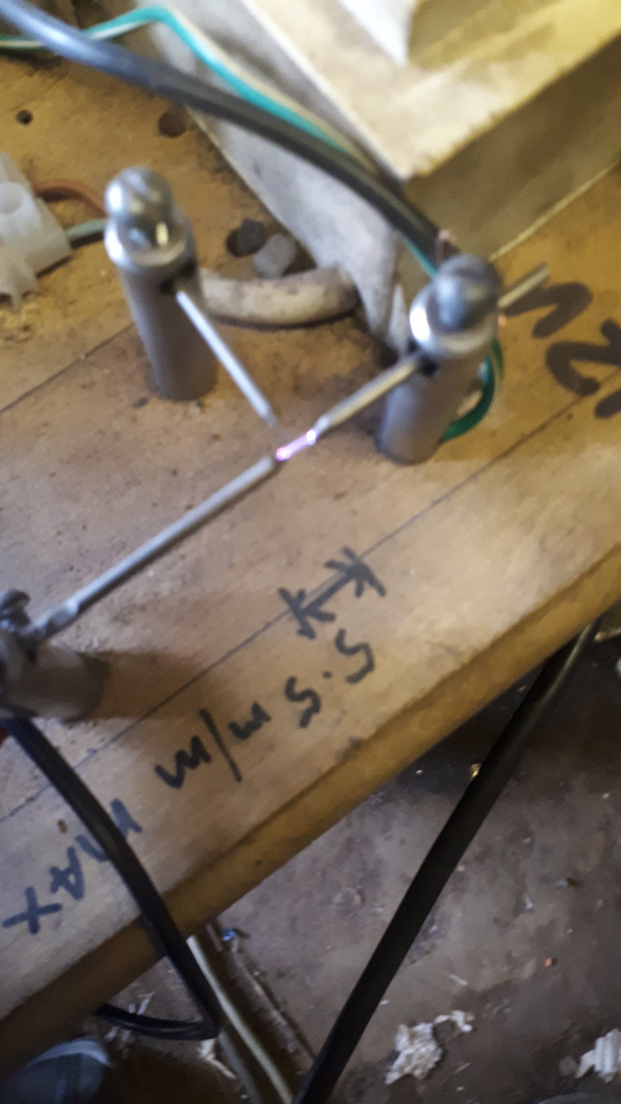

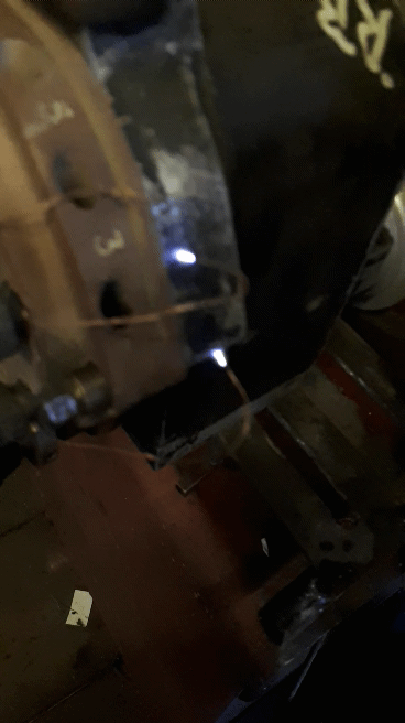

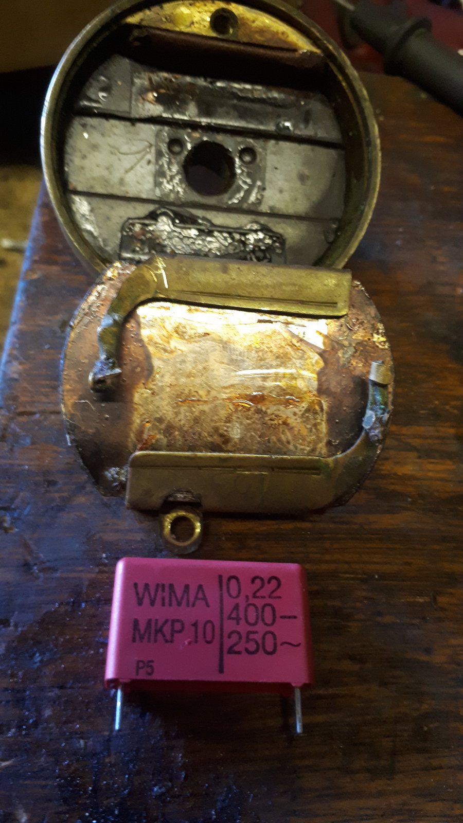

clean the points first !I just kicked my bike over and not a sausage from the mag.
I am going to show it the above pic and hope it encourages it to show a bit of life.

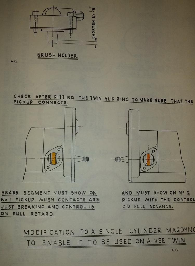

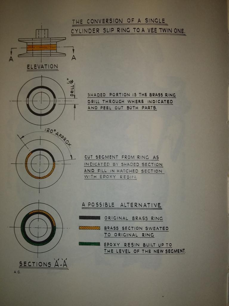

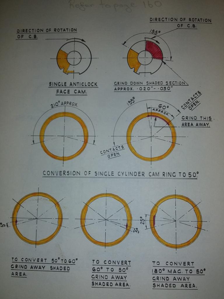

heres some usefull info from an old brough book for fellow View attachment 230060 View attachment 230061 View attachment 230062 View attachment 230063 View attachment 230064 View attachment 230065 v twin nutters
I converted the Mag/dyno for my 1929 Matchless model X from a single to a twin, a covered wagon type, has been starting first kick for 16 years until last year when I suspect the condenser failed, but it got me home, just, a few years after I had done it I was speaking to a magneto guy and he said that as the singles only had one magnet and the twins two it would never work, well it did! fyi I have found a few single covered wagon mag/dyno bodies with two magnets, maybe a sport version?
