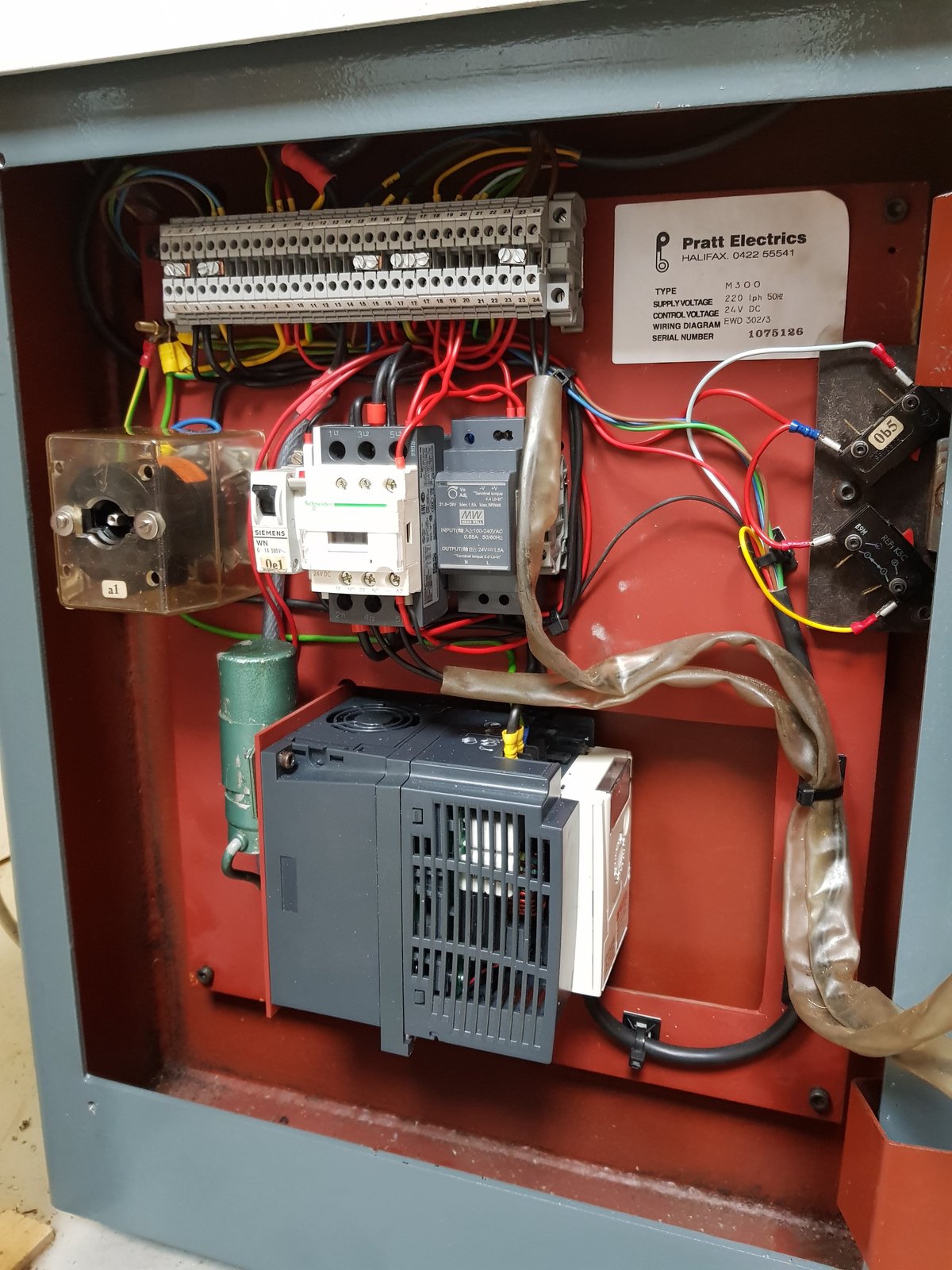

Here is my panel, I replaced the terminal blocks with some Weidmuler ones from RS. Schneider VFD from Inverter Supermarket. Old capacitor to provide pseudo three phase for coolant pump. 24 V contactor for emergency stop (along with a 24V power supply that provides power for the control circuits, and will power some LED lighting. I wanted the VFD in the panel, as once they are programmed there is no need to see them. To get it to fit I cut a section out of the panel and welded it so that I had somewhere to fix the VFD. You obviously need a VFD narrow enough to do this, as well as a VFD that doesn’t need side ventilation.

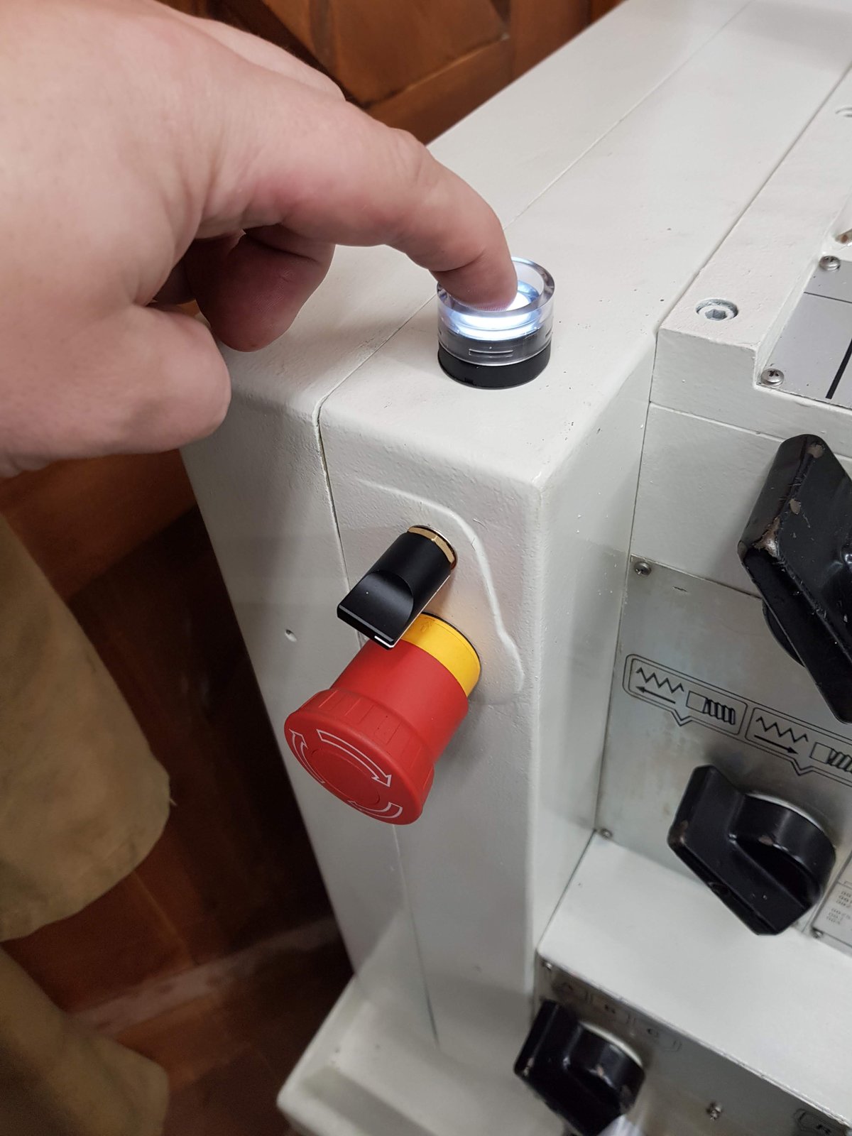

Original estop button replaced, and pot added to allow speed control of VFD. Pilot light replaced with a light/ momentary switch. The momentary switch is used to latch the contactor on to power the VFD. So if there is a power cut or you hit the estop, you have to press this button to re-energise the VFD. There is also some start protection built into the VFD. Foot brake switch is wired to the VFD to trigger a coast stop. If you hit the brake, you don’t want the VFD fighting the brake with a ramp down time.
