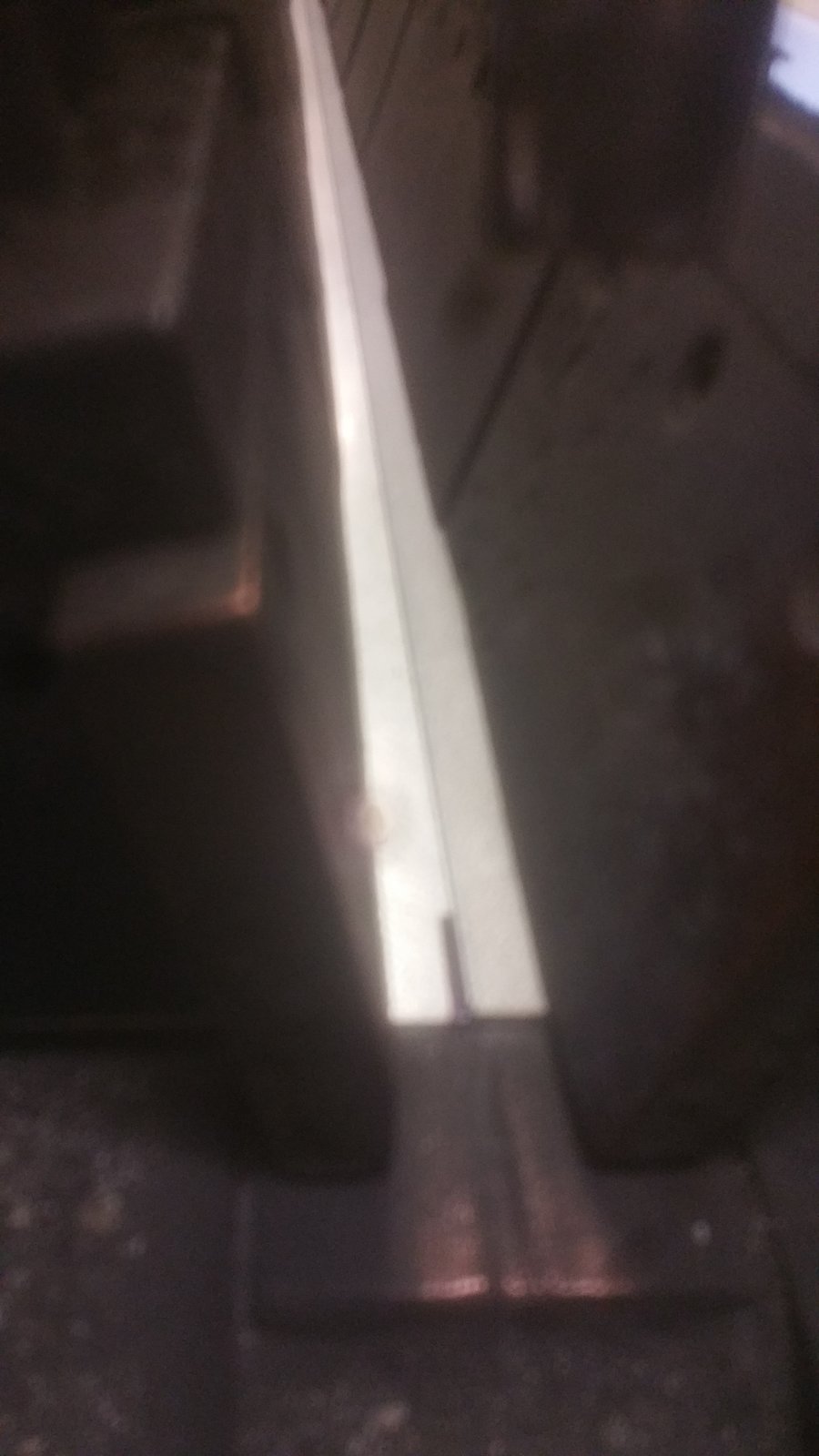

Is this your burn back
That is your arc length correction. Which is what I mentioned earlier. It’s a fine voltage adjustment.
At the moment you are set on 118% which means that your voltage is 18% above the actual synergic line. To bring it back in line with the synergic line adjust the knob until it displays 100% as 100% means that it’s bang on the synergic line again.
my suggestion would be turn it back to 100%, then adjust the knob on the left until you have the power setting that your happy with. Then use the knob on the right to either add or take away a little voltage to optimise the welding setting
