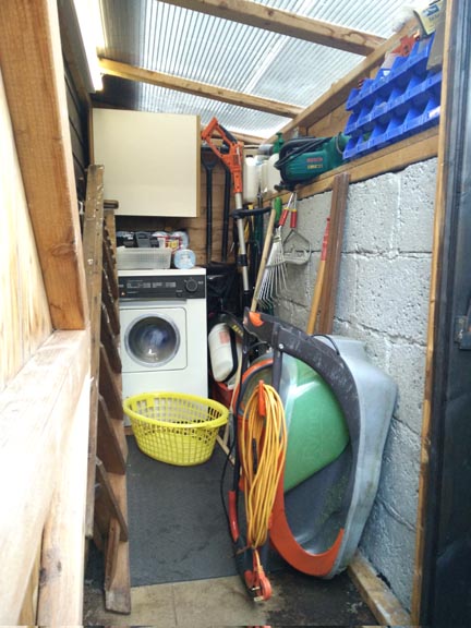

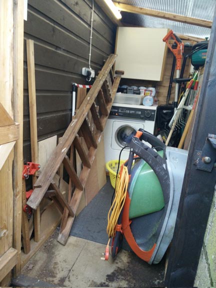

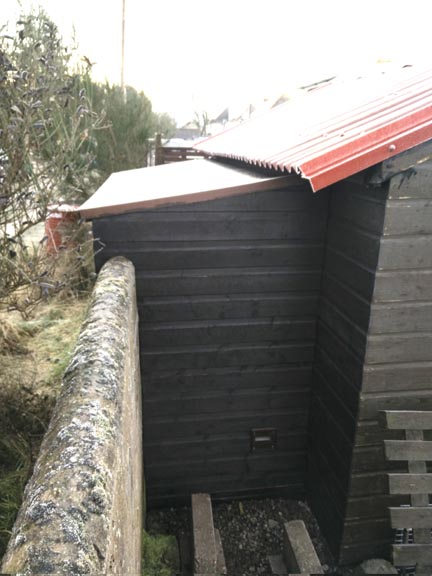

It measures 8' x 3'9" front to back, roof is 8' x 4' tri-wall polycarbonate sheet [bronze finish, although you can't tell from the pics] like this https://www.roofingmegastore.co.uk/...type/multiwall/triple-wall-polycarbonate.html
The staining you can see just inside the door is mostly off my feet, off the mower after washing, or rain driven in past the wall & upright/door jamb. I have a few tins in the wall cupboard and they've survived over the years. The small blue 'linn bins' you can see have screws, springs, bolts, nuts etc and no problem with them going rusty.
If you're concerned about damp, run a power supply through from the garage and make a wooden box to hold the tins & leave one of these [other suppliers are available] running all the time - safe, and cost next to nothing to run. I used to have two when working at the golf course, one to prevent a water supply in a metal shed/workshop from freezing [tea is important] and the other in an old wardrobe to store chemicals. Did the job just fine.

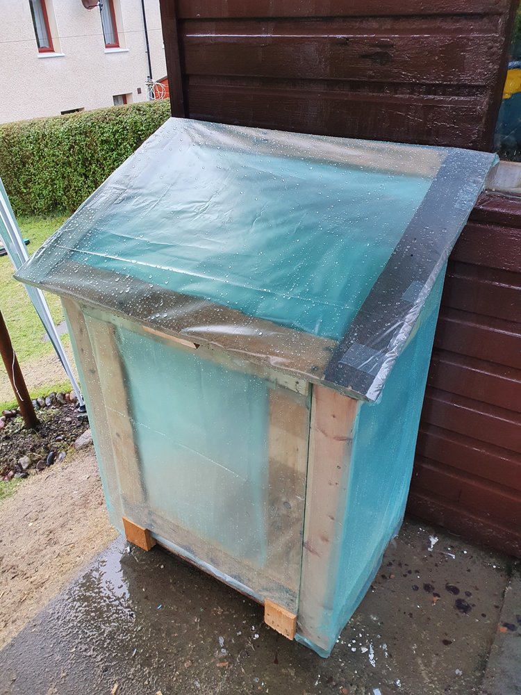

You mean like this there's a thread on the build I did somewhere.I'd be looking at something like this, maybe made from pallet racking?
Polythene sheets, covered in Yorkshire boarding/palisade fencing to provide weatherproofing
You mean like this there's a thread on the build I did somewhere. View attachment 283373
 )Fort William is far wilder than Yorkshire. Still going survived untill now from December.Sort of - but pallet *racking* (the steel stuff) to provide the framework.
Then poly to provide the waterproofing.
Then boarded on the outside to provide wind resistance.
A bit less "temporary" than yours.
(I don't know what the weather's like in the Highlands, but that wouldn't last 6 months in Yorkshire weather)
