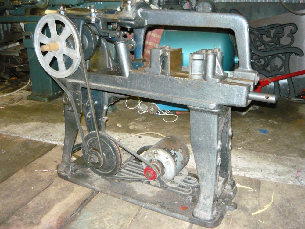

best way to measure belt length is using some string if your just going to use a jockley pulley to tension it . wrap string round pulleys and get the jockey wheel and pull in the string till your at your desired length then just measure or take string in and match belt to length. heres the tensioner on my saw but its only fixed under tension. yours will need to be slacker and use a lever to tension belt
