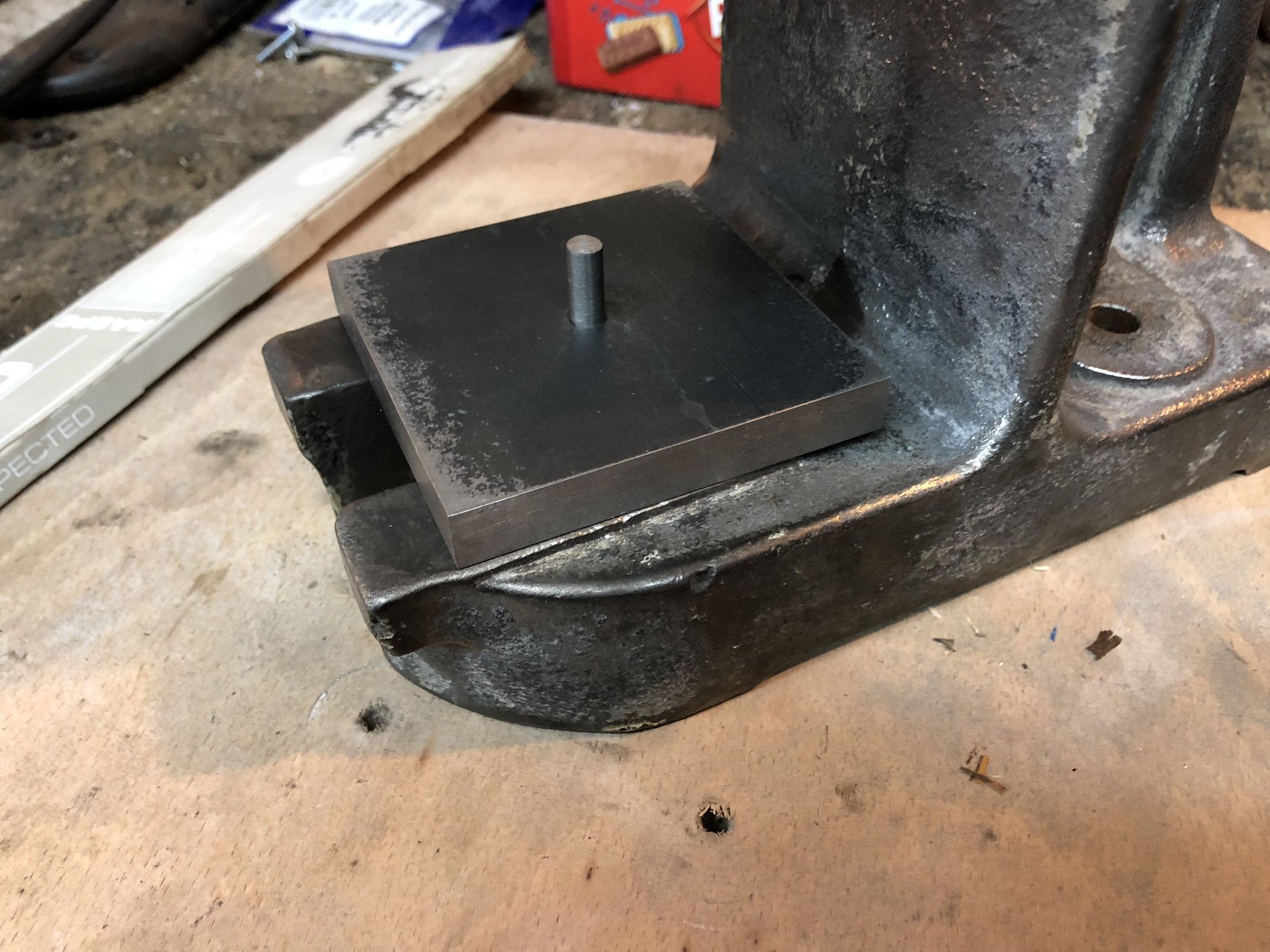

Are you reinventing the (daisy) wheel here? Surely you only mount the daisy wheel when you have a specific need for a certain size aperture for pressing stuff in or out. So long as the centre of the cutout is aligned with the centre of the ram you're golden.

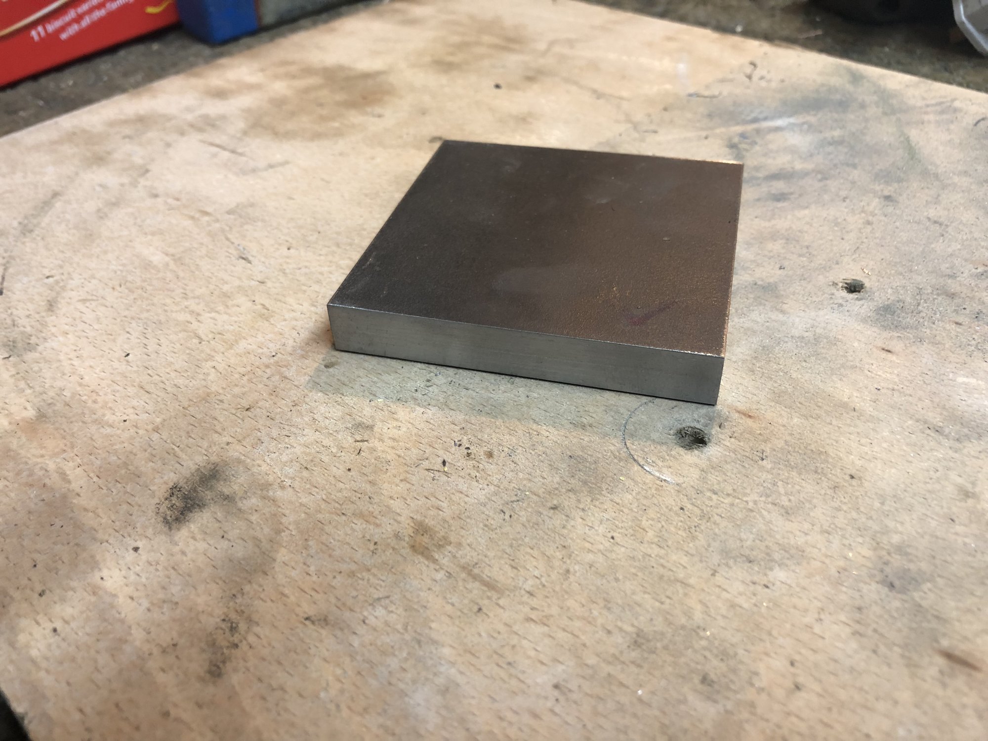

A bigger wheel would to the trick. Or don't put the pin in the middle and place the wheel wherever it suits you.However now that I’m making progress I don’t like the way the “wheel” will sit back from the edge. So a little rethink is required.

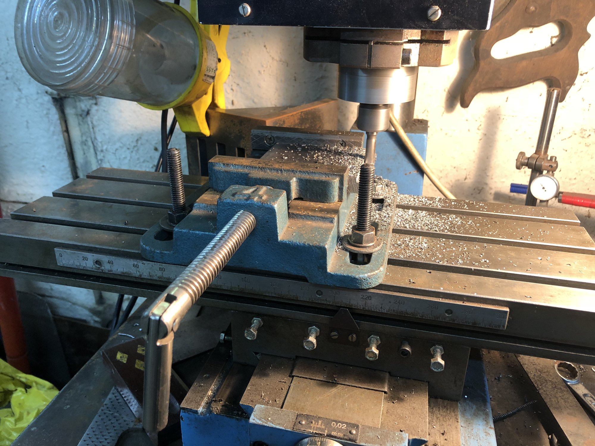

This is part of the next plan, I was trying to use the original pin locating hole to mount a larger wheel. This ain’t gonna work as I realised today. So this one will just be a plain wheel.
When I get some flat bar I’ll make a “wheel” with slots but it ain’t gonna work with the pin.
Next time more planning and evaluation required
