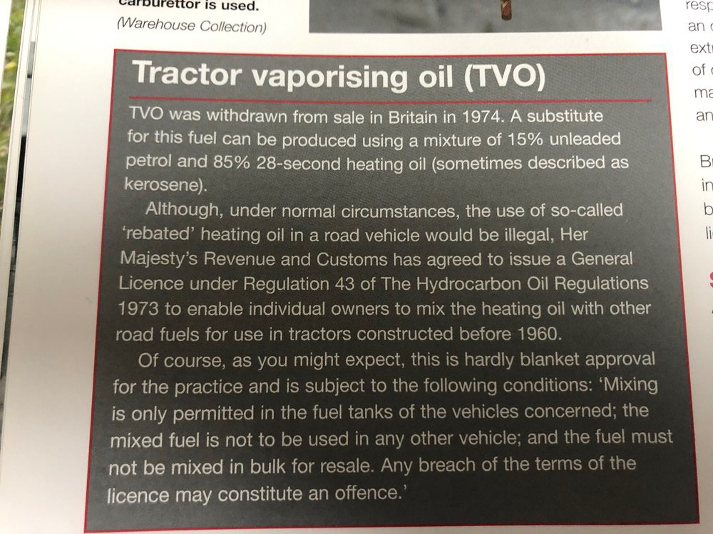

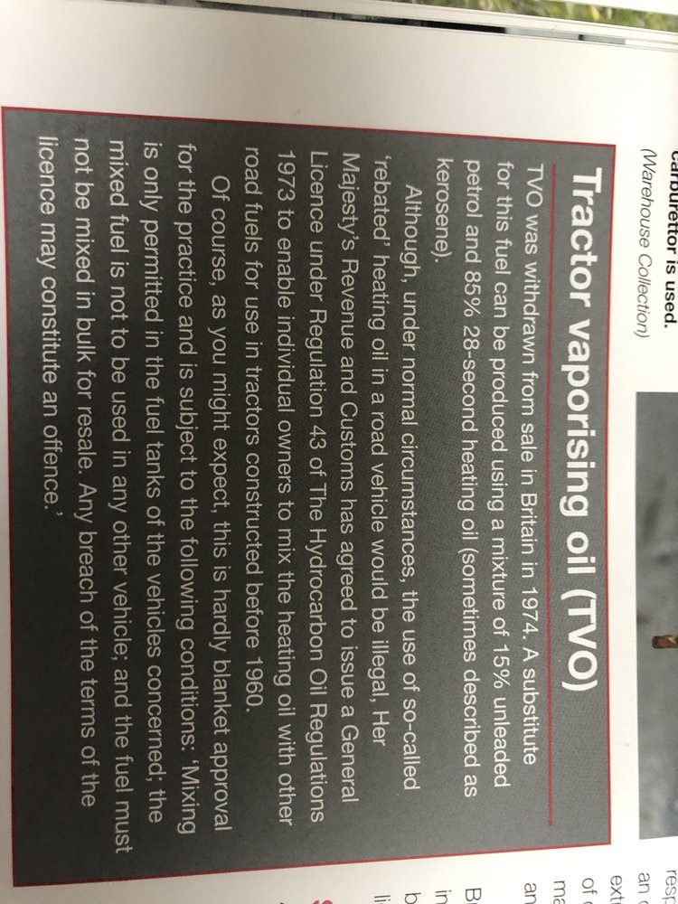

From the Hayes Book on the Tractor.Is that the same as 28 second heating oil?
