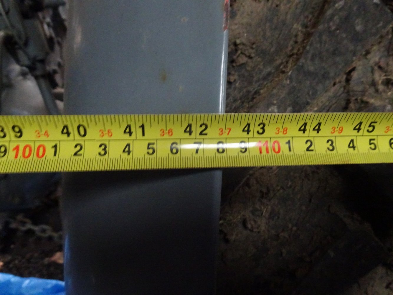

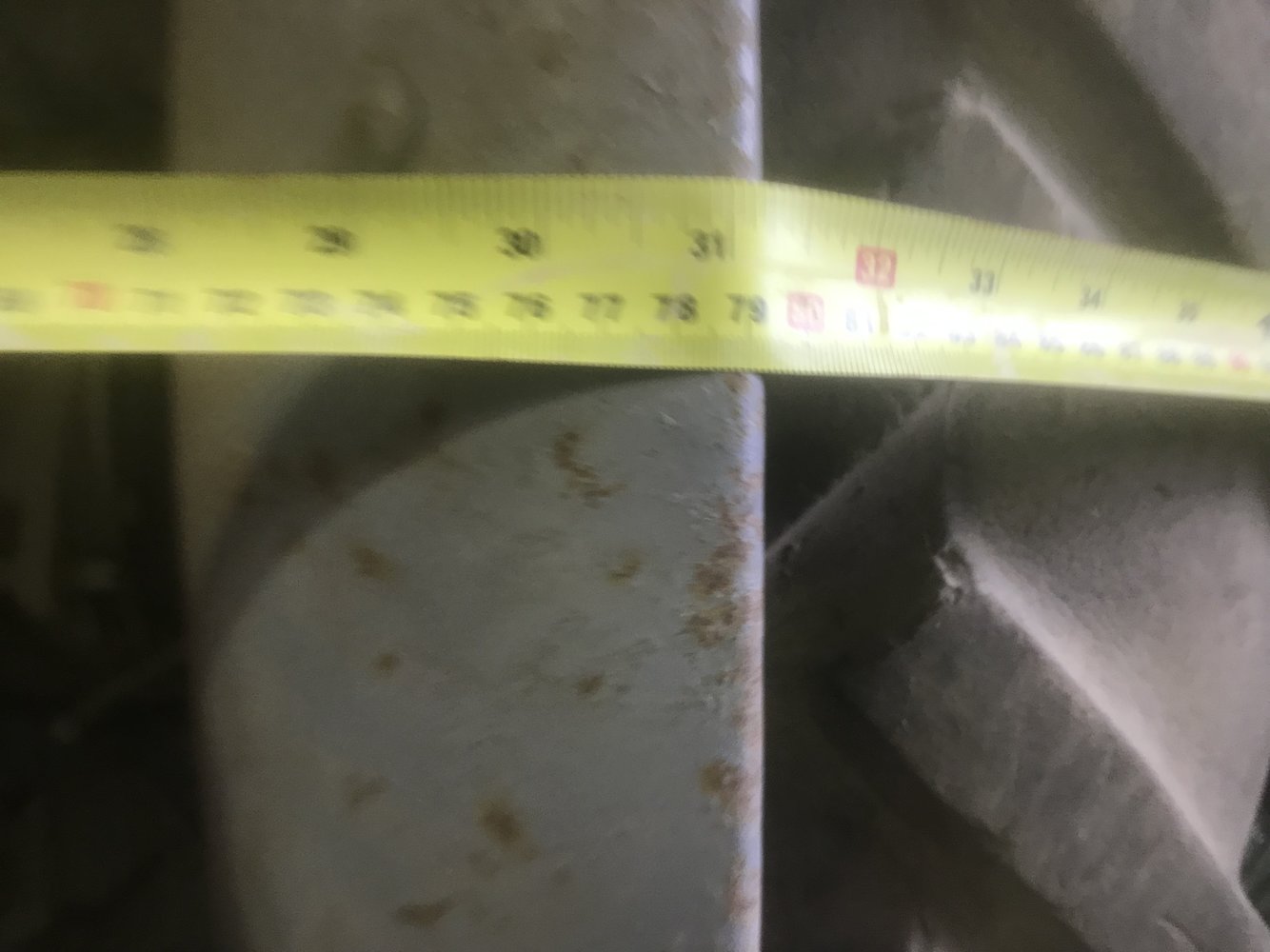

Sorry it’s a bit cramped in the barn at the moment,
this is the orchard spec one
Heck of a difference, mine's about 11" wider...
Boasting again
So now the original dust/dirt cover will fit properly![]()

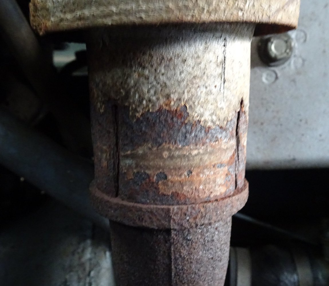

The only thing I'd warn you of is the dangers of TVO - it can kill an engine far too easily. They need to be REALLY HOT to run well on it, like ploughing, not small runs. It partially burns, and bypasses the rings and ends up diluting the oil. Not a big problem in itself, but the cam runs directly in the iron block (no bushes or bearings) and starves of oil... then the oil pressure drops and no oil gets to the valve gear. It is far better to unbolt the heat shield from the exhaust and run on straight petrol.
You dont get the smell, but it will live longer...

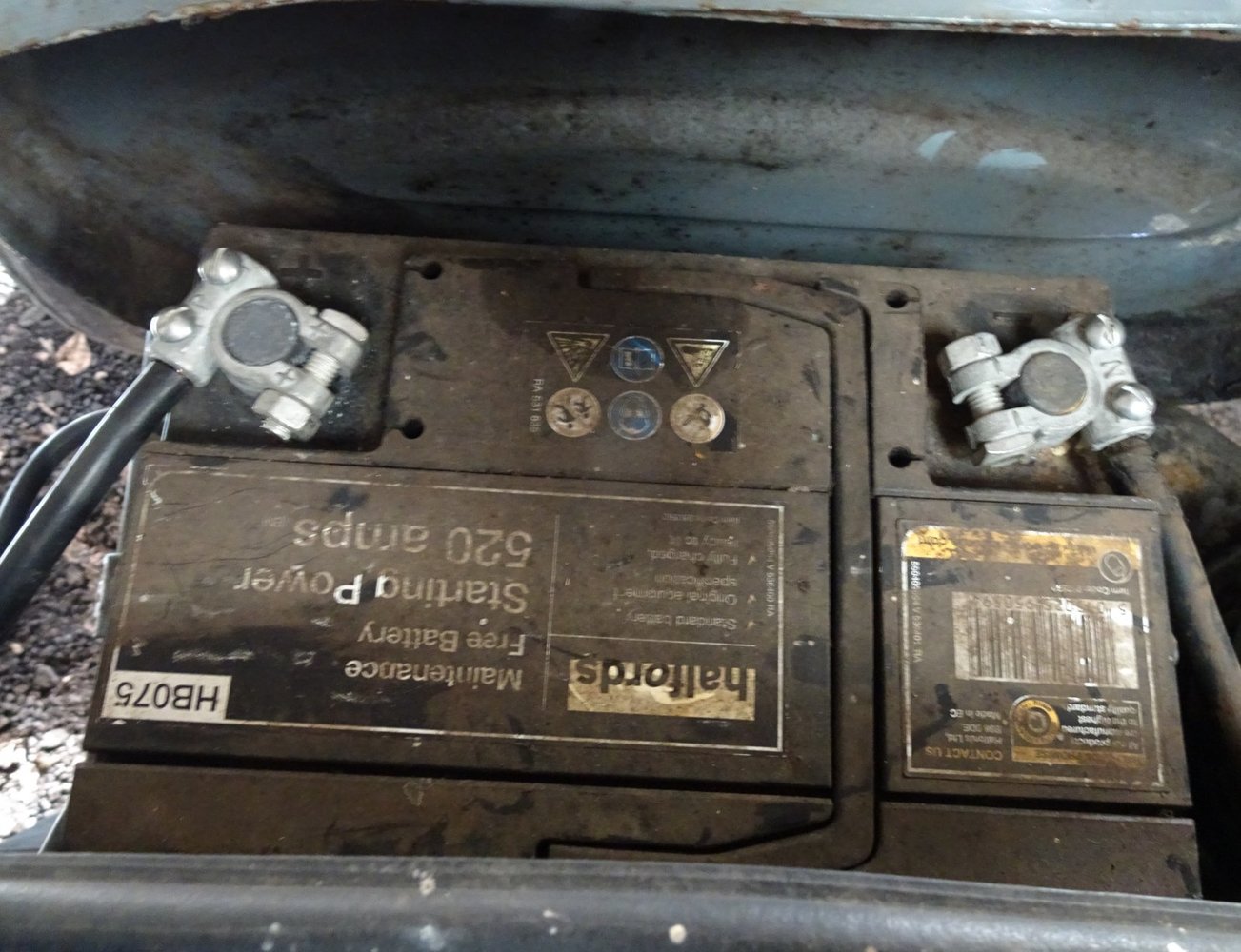

Also. is it still 6v or has it been changed to 12v?

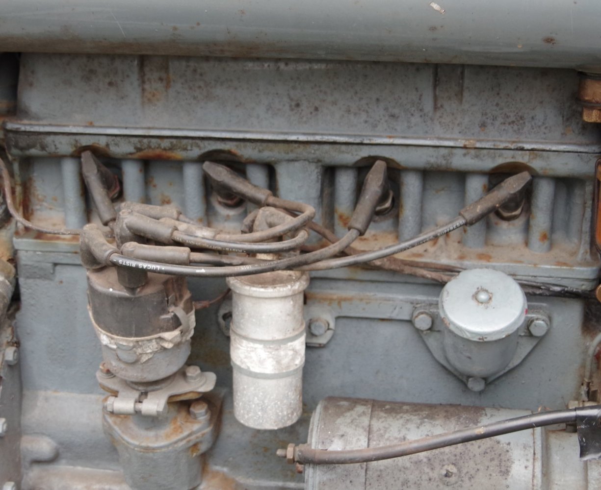

I'm more familiar with NGK, I have BP6ES in mine, my plug chart shows Champion N10Y as an equivalent, but it might be outdated info. First I would check if it is an original TED or a TEA petrol converted - lots of kits were available at the time, even a factory one. Main difference is the head - a TED is long reach plugs but a TEA is short reach. A TED head has a block cast between spark plugs 2&3.Thanks for the TVO tip, it will only be used for pulling a wheeled flail mower and some small chain harrows round the paddock for less than an hour so it sounds like sticking to petrol is the best idea?. The heat shield only had one bolt in it so I have ordered another but it sounds like I'm best leaving it off.
Can you recommend a spark plug for the TVO engine?, original would have been Champion N7 and cross reference charts show N4C as suitable?

I'm pretty sure it's an original TED,I'm more familiar with NGK, I have BP6ES in mine, my plug chart shows Champion N10Y as an equivalent, but it might be outdated info. First I would check if it is an original TED or a TEA petrol converted - lots of kits were available at the time, even a factory one. Main difference is the head - a TED is long reach plugs but a TEA is short reach. A TED head has a block cast between spark plugs 2&3.
TBH they're not that fussy on plugs, you have more problems with poor quality condensers and rotor arms. Also if its running a 12v battery some of the ignition system may still be 6v.
Suggest you get condensers and arms from Distributor Dr (http://www.distributordoctor.com/) directly - better than most other dealers

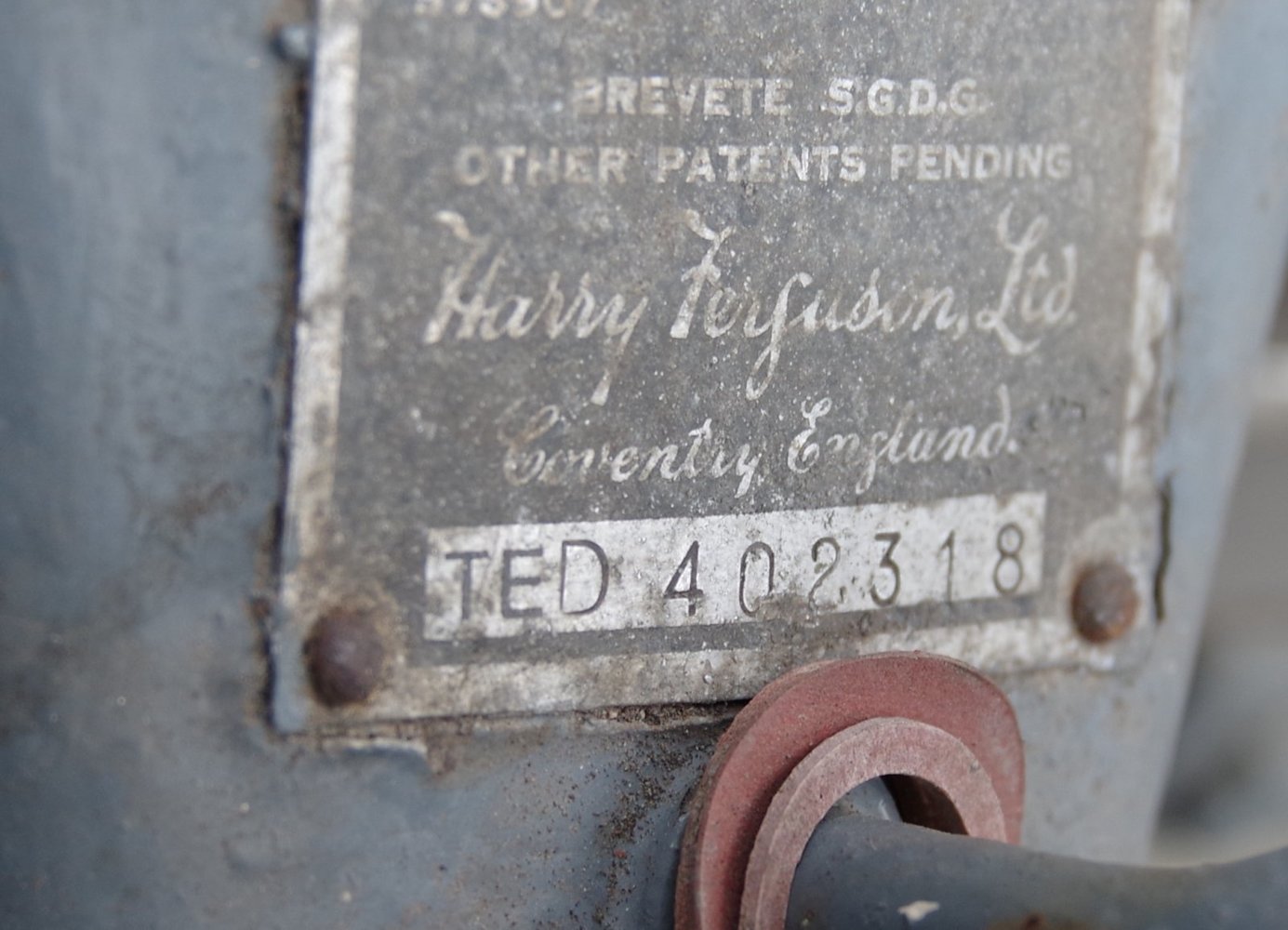

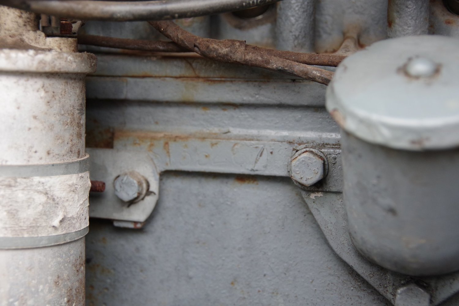

yep... definitely a TED....
but.... that serial number doesnt match that tractor.....
the number dates to 1954, the tractor is 6v and dates before 1951. Not a big deal but it might be a problem with paperwork.
the number on the original docs is the engine number, should be stamped on the engine between coil and oil filler, check if it matches.

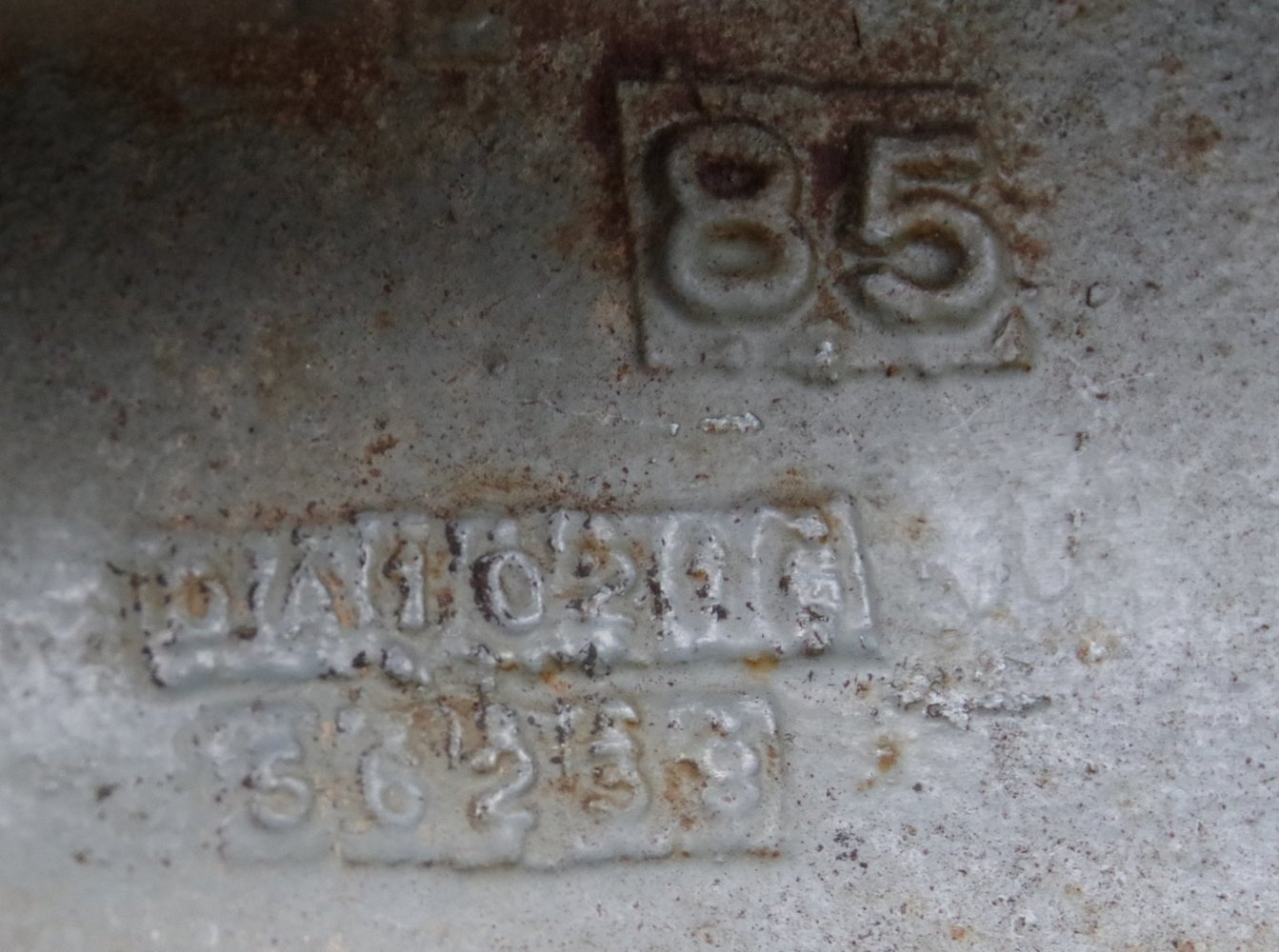

Also on the rear axle casting rhs near the rear dipstick is a casting code which will date the build
