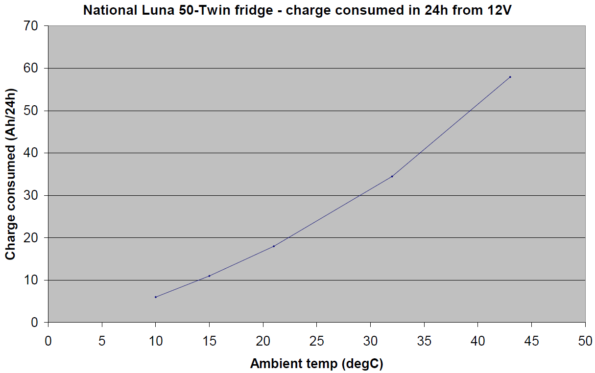

That really does add up over time! (Looks like about 25A if the temp is 25c over 24- hours).Here's some manufacturer's data plotted for the National Luna 50L fridge:
It would be interesting to see how it compares with sg66's measurements.
Still over six days running the fridge only, at 25degC ambient temperature, off the 230Ah lithium battery from 100% to 30% capacity.That really does add up over time! (Looks like about 25A if the temp is 25c over 24- hours).
Am I working this out right???Still over six days running the fridge only, at 25degC ambient temperature, off the 230Ah lithium battery from 100% to 30% capacity.
