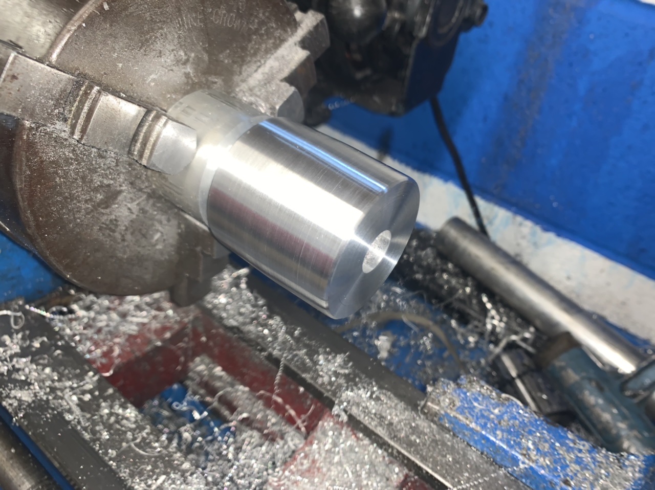

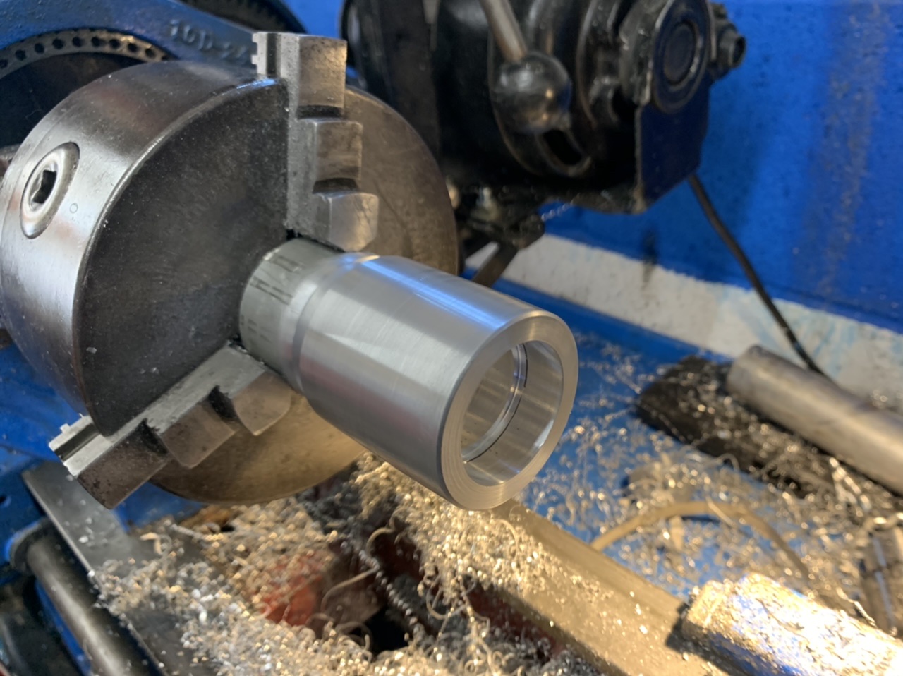

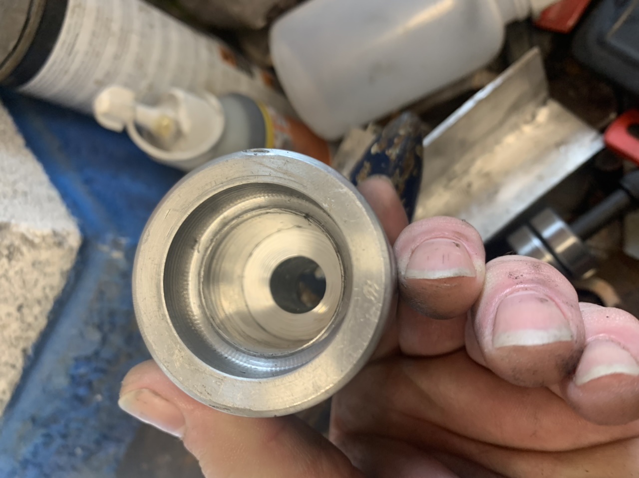

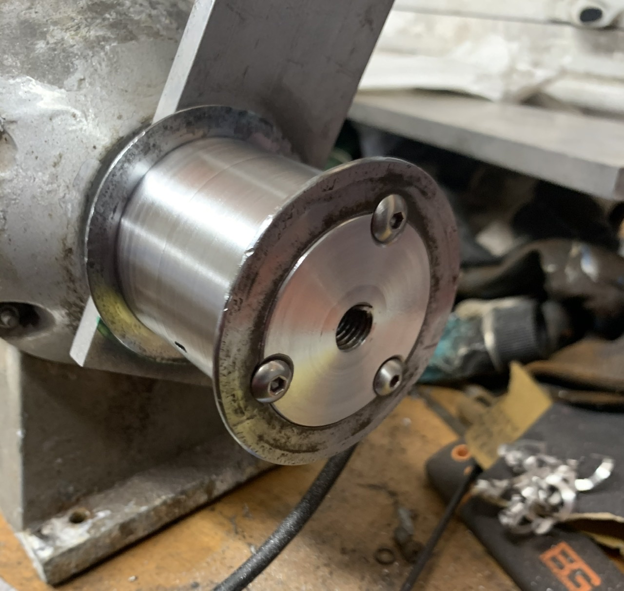

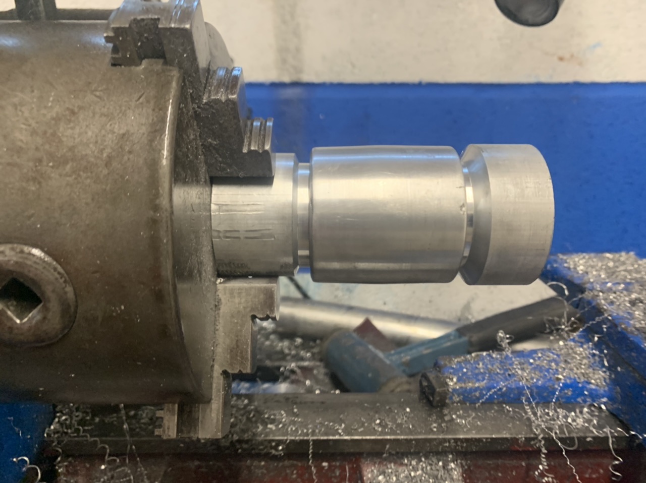

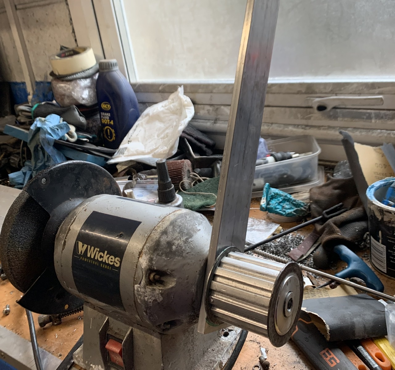

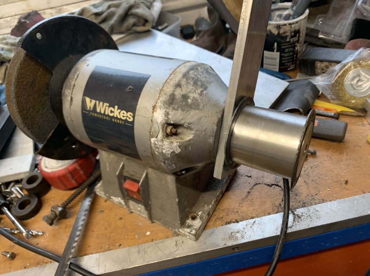

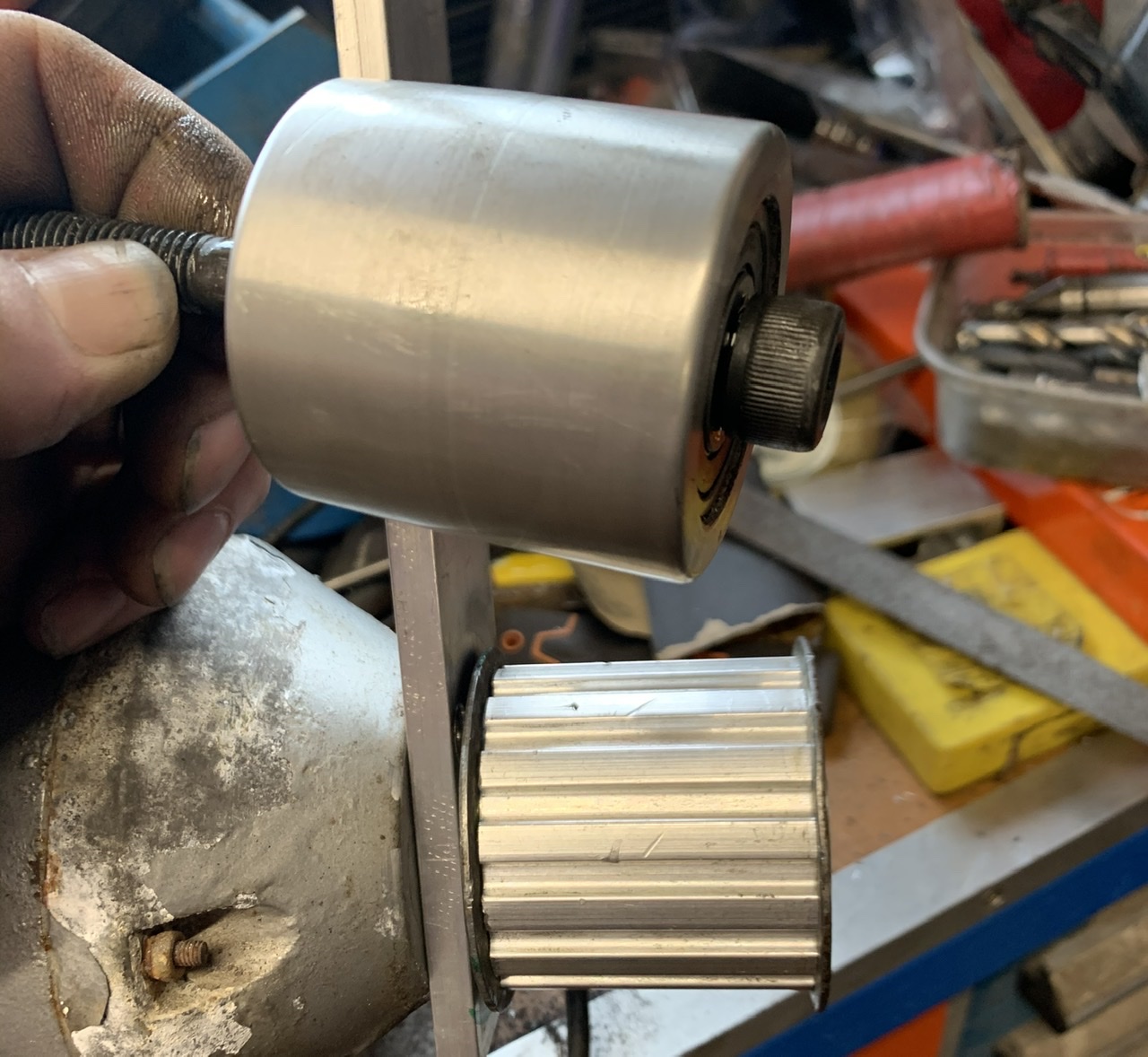

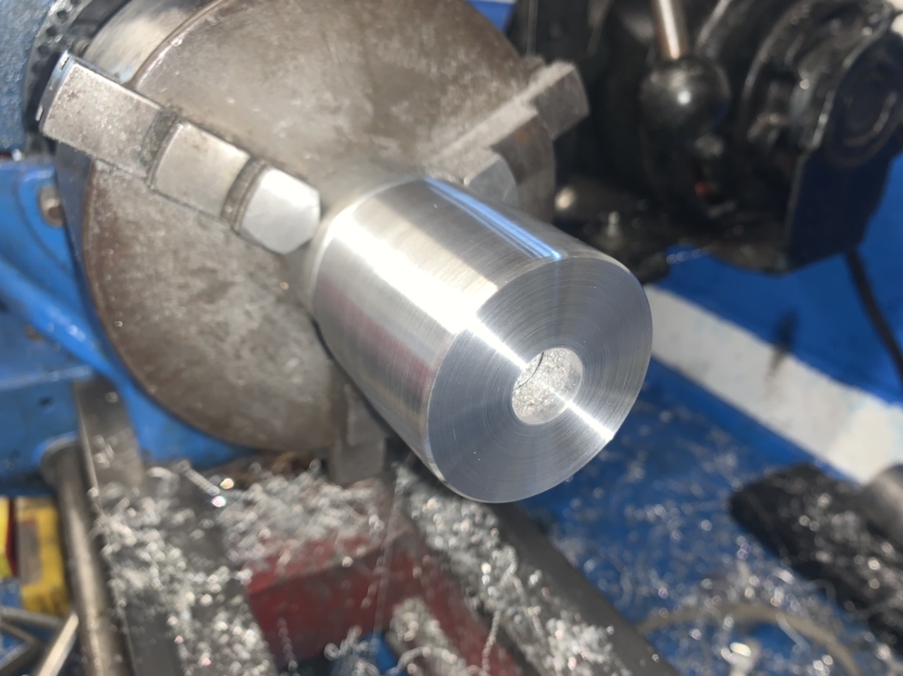

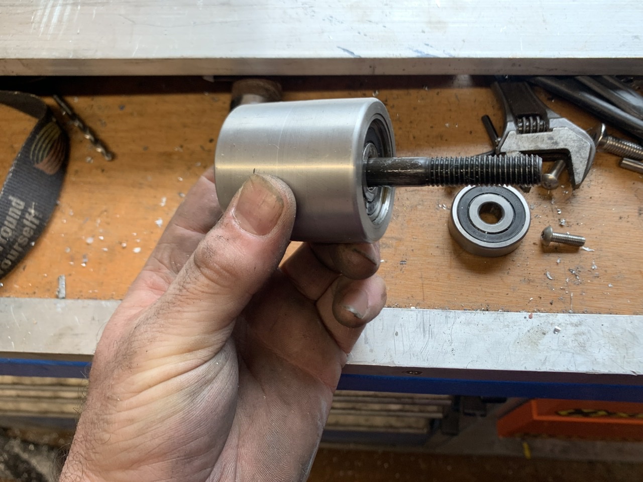

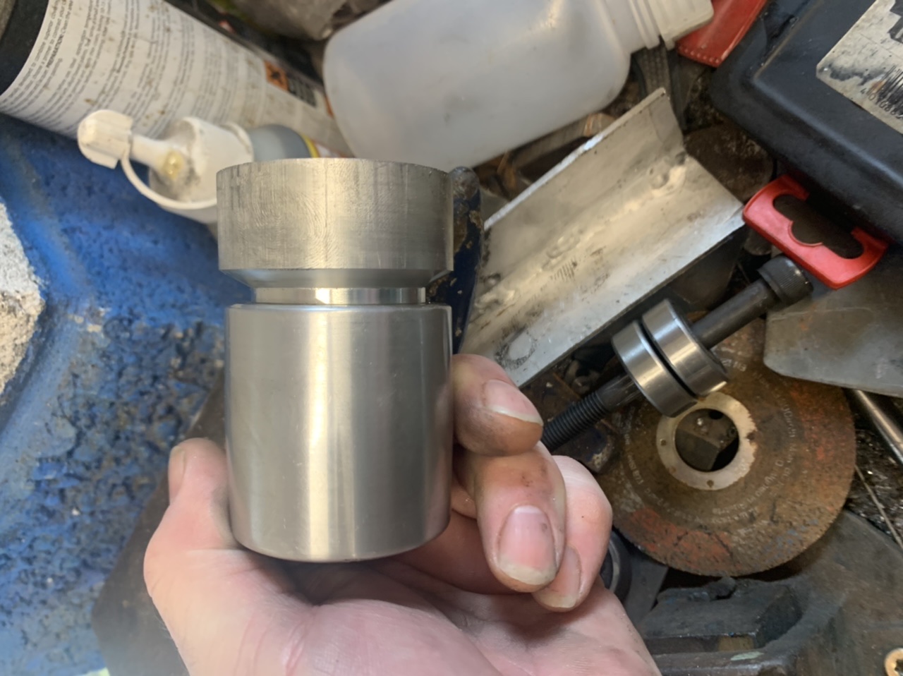

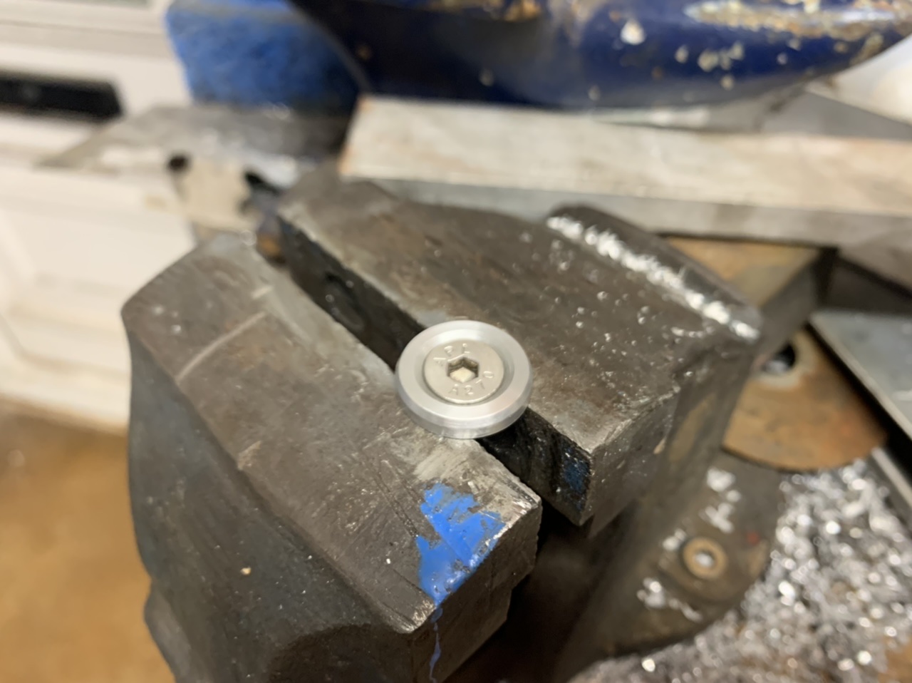

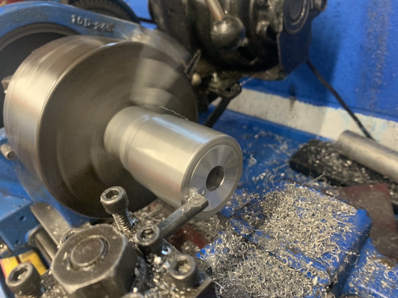

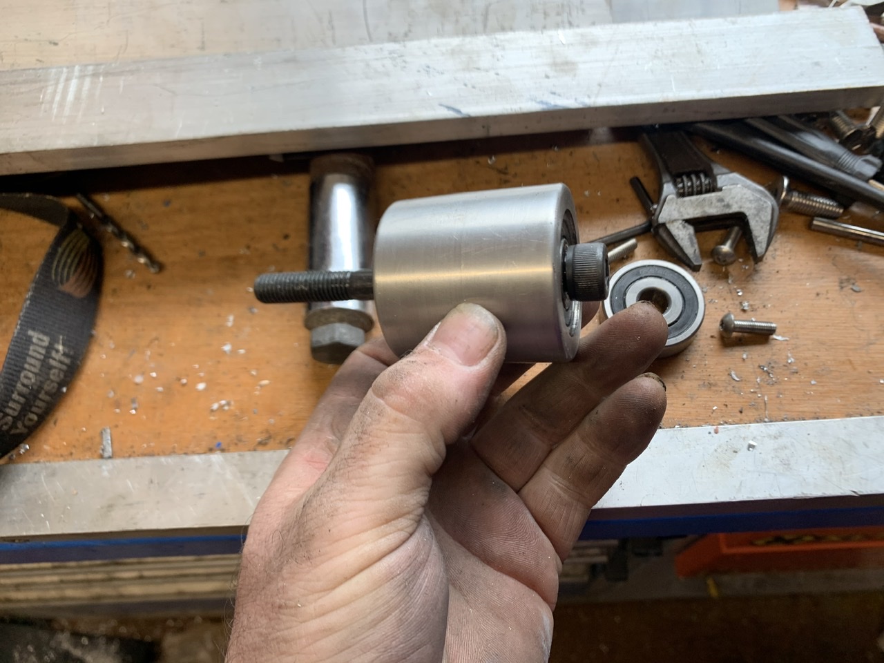

Made 2 x inserts at 38mm, bored out to 38mm, put a thin line of high strength loctite 638 bearing retainer around the circumference and pressed them in before parting and facing off one end. I need to bore it out to 35mm again now for the bearings.
View attachment 221037 View attachment 221038 View attachment 221039 View attachment 221040 View attachment 221041 View attachment 221042

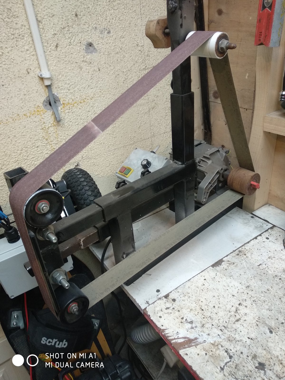

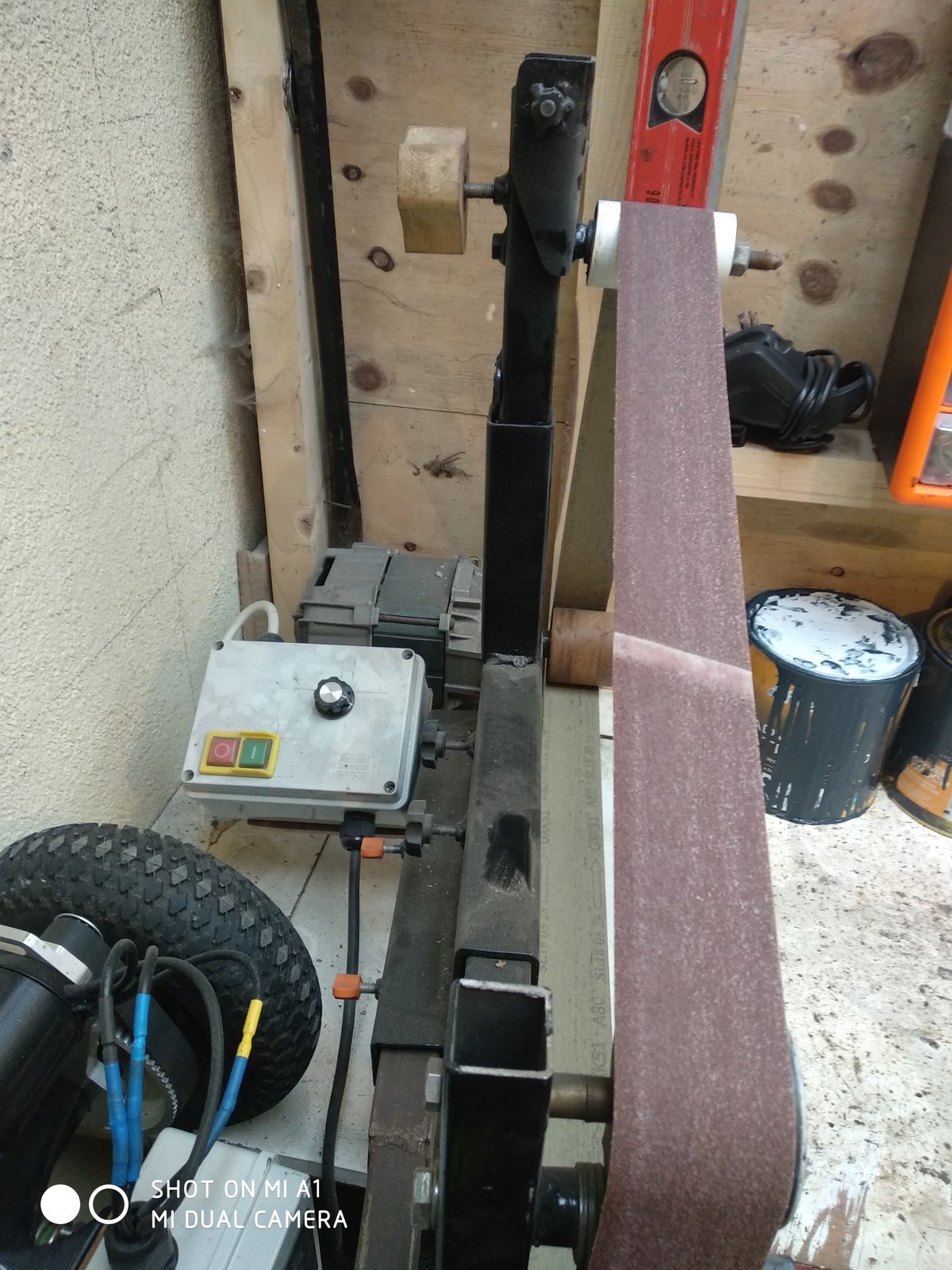

I have made 3 linishers to date. One being a replacement for the first one, and at that time I had 2 workshops, 50km apart. I use an uncrowded rubber front contact roller, so you can grind on the wheel. You can get the grooved contact wheels as spare parts, or from Aliexpress.
The linisher is such a handy machine for deburring cut steel etc
