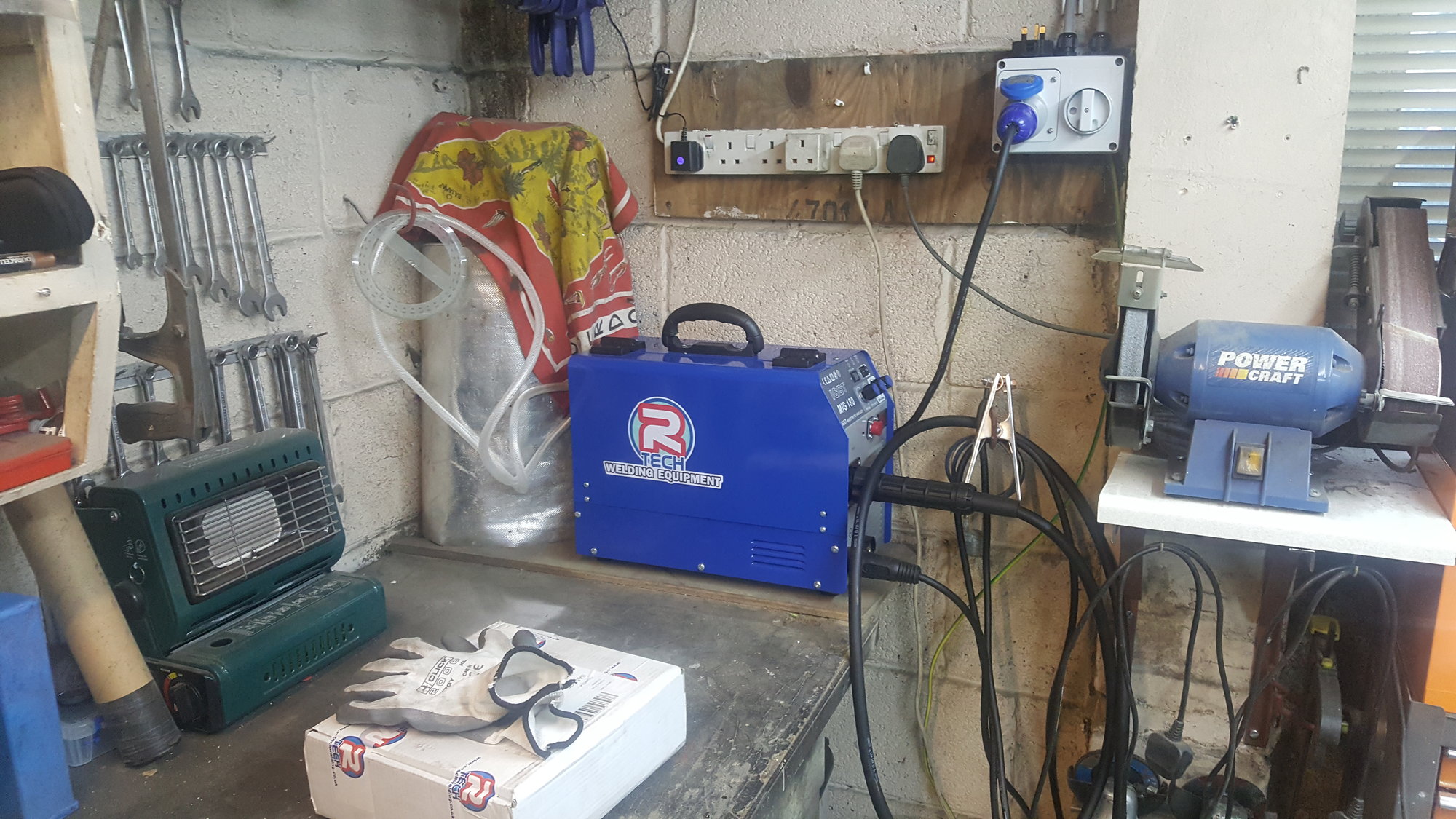

Right, never done anything like this before and not seen anyone else’s build but I found a pulley in work and had a brainwave so purchased a bundle of belts on the bay.
I rung my old man and asked if he had anything I could use to drive it. Someone had given him an old 240v 300w Wickes bench grinder which was missing its RH wheel and nut, so I promptly stole it off him and a plan was formulated. Not sure it will have enough guts but so far there’s no costs involved. I like free!
I have some flat ali plate here which should suffice with some wide strengtheners across the bed and a flat bar as a bed under the belt.
So I made a start on the frame.
