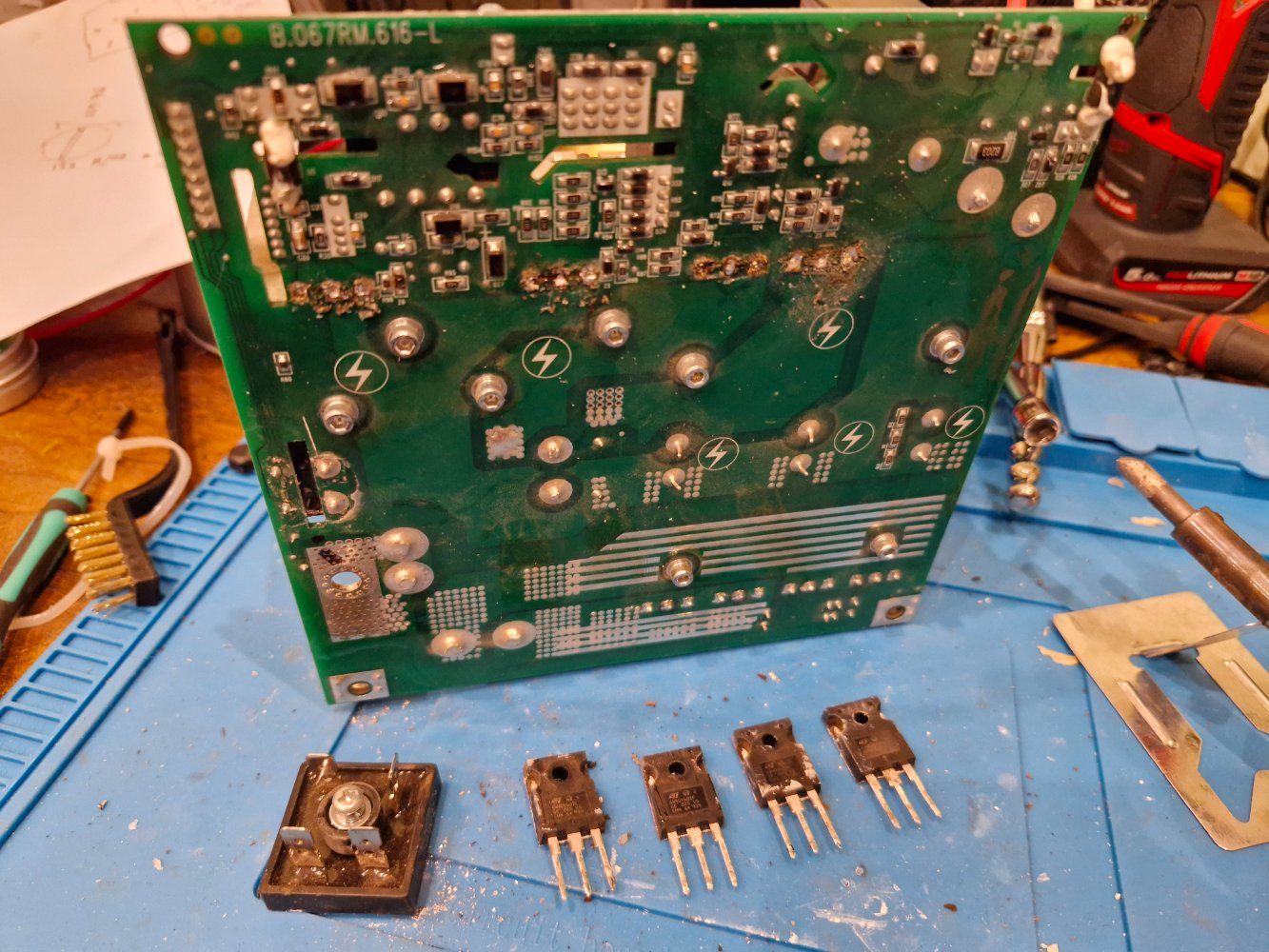

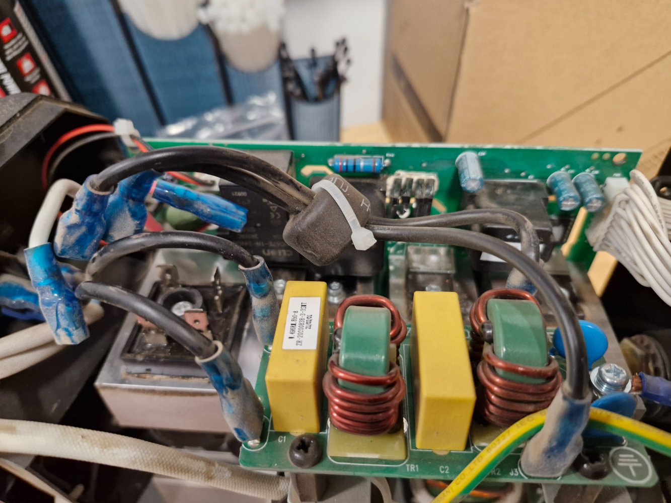

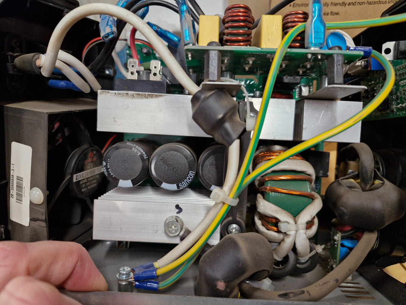

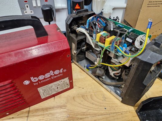

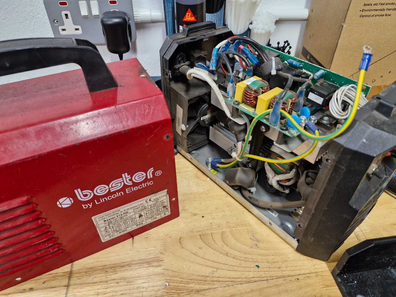

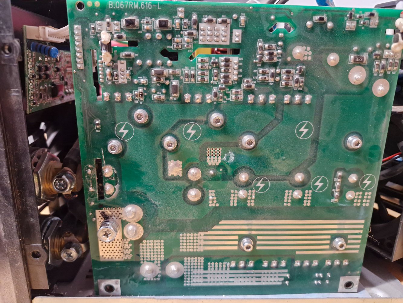

I got a better look at this Lincoln today. I discovered no AC at the main board. The 4 pin diode bridge rectifier was bad.
I wanted to check why so I checked the IGBTs which are a common failure on modern inverter welders. Sure enough 3x of them on one row tested bad. There are 8 total, I removed the top row of 4x and I will replace that row. The bottom row all tested good so ill leave them alone. I tested the small components connecting the blown IGBTs and they appeared OK too, not open circuit.

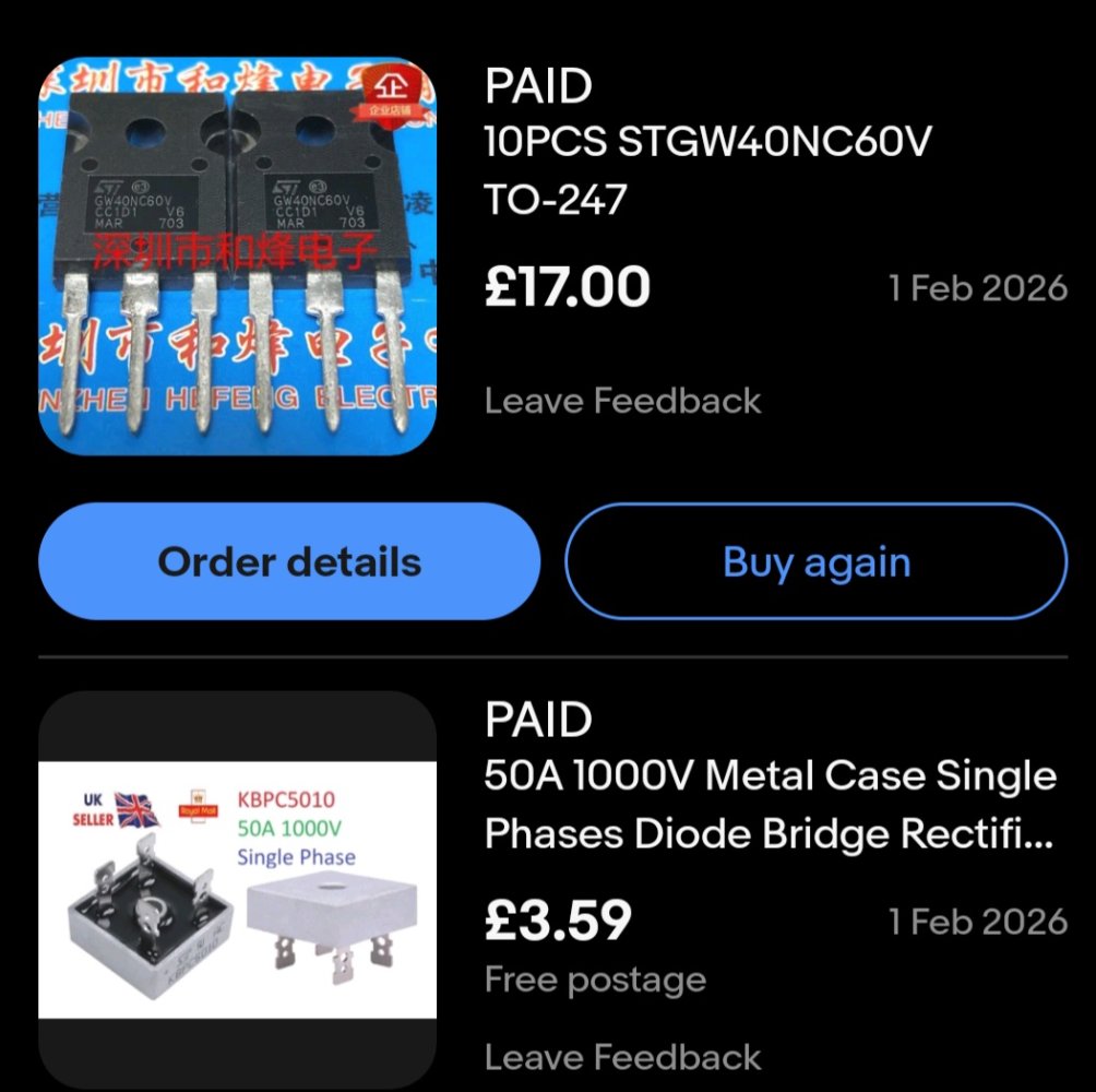

Parts ordered, cheap enough too. 10 so ill have some spare.
When IGBTs go short-circuit, they often conduct high voltages from the collector/emitter circuits through to the gate. This destroys the gate driver circuitry. You need to trace the circuit path from the gate of the IGBT module back to the control logic, and check it. There may be Zener diodes, resistors, a dedicated driver chip or a pulse transformer involved.
Another problem can be that installing a new IGBT with the gate driver still damaged can self-charge the capacitance of a floating gate. The IGBT will then conduct fully on, and blow itself up again. Therefore you would need to...

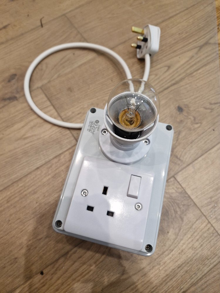

Big progress since. I made one of these boxes to limit the current for safe startup-
(Bulb wired in series) The bulb limits the current to prevent damage. With the shorted IGBTs removed and new bridge retifier it now starts up. But as I have a 60w bulb it keeps cycling on and off as its being starved of current too much. 200w bulb ordered next.
But there is life in the welder for the first time which is great.
When the 200w bulb arrives I should be able to power it continuously and test the gate signals are present before soldering in new IGBTs.

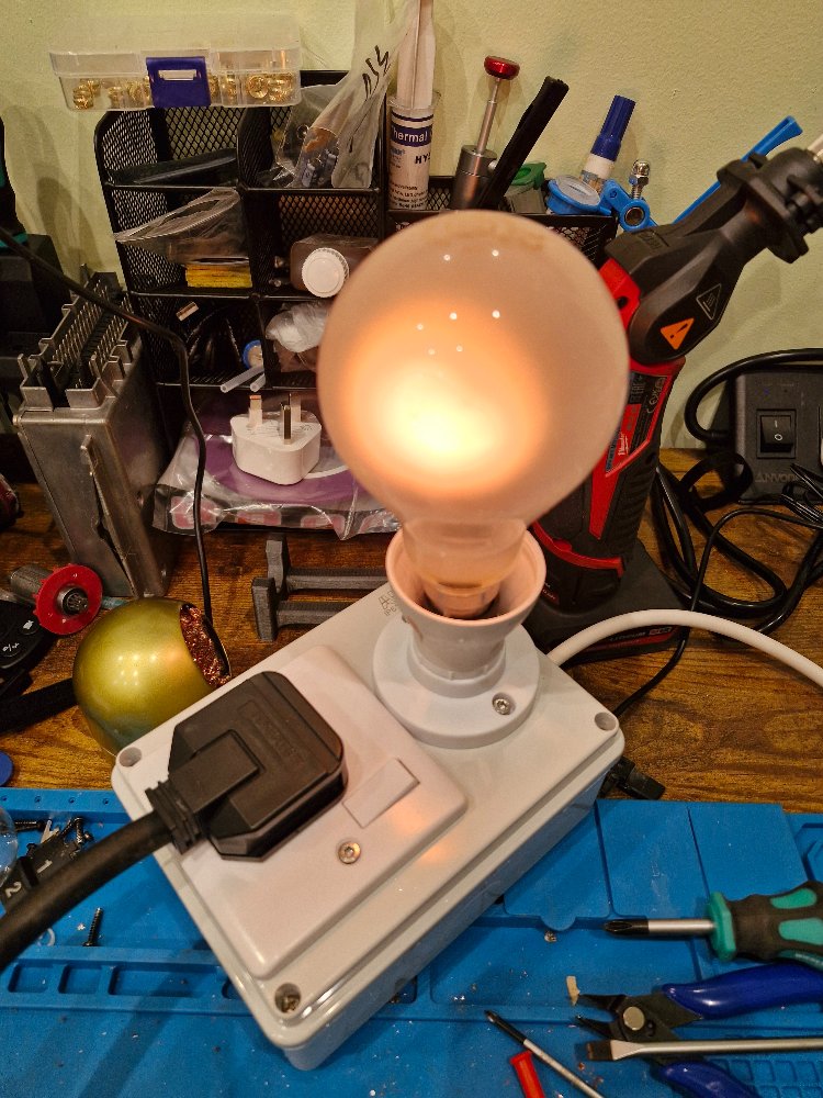

Update. The 200w bulb arrived yesterday. So I powered up the welder again. This time it ran and the bulb low glow at first -
At first OK, then about 20 secs in the bulb started to go bright and cut the voltage to the welder that it "browned out" . I could see a little puff of smoke from the welder board. Oh dear.

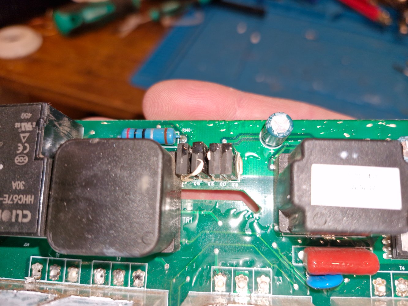

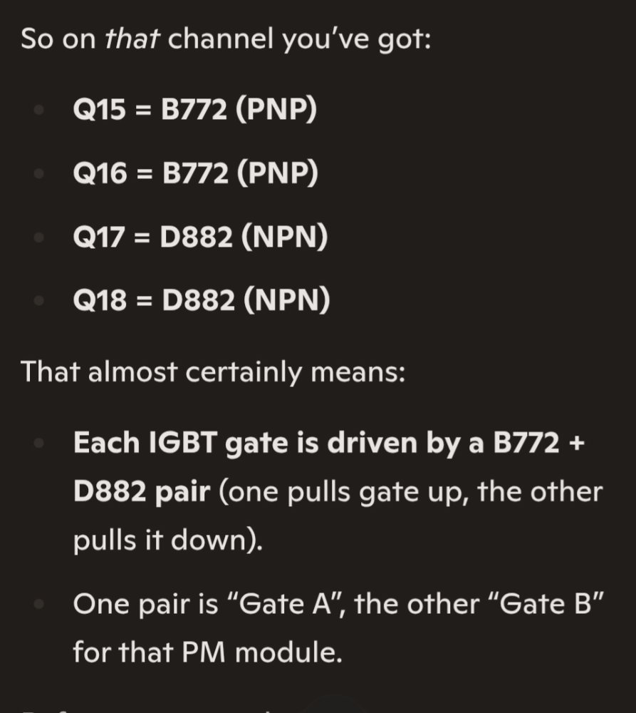

I got my thermal imaging camera and the item Q16 below was hot
These 4x items are 2 pairs. As follows:
I have a cheap kit ordered with those in it. One or two tested bad but I will replace the set of 4x. Then power up again no IGBTs and see if that issue is cleared up. Before measuring gate signals.
