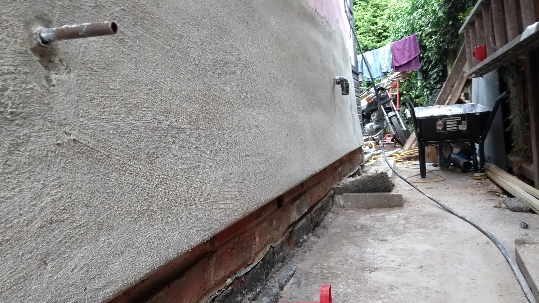

Our house needs a fair bit of work and one issue is there’s still loads of old horse hair plaster. Chatting to someone who specialises in lime plaster he’s quoted me £140 + vat per m2 which would mean a small room like our hall would cost in the region of £2.5k.
How difficult would it be for a competent and keen diyer to tackle a job like that? I’ve done a small bit of rendering and skimming in the past and have had ok results though I know I could have done better.
The house is 1890s and built on clay. No foundation and no dpc.
