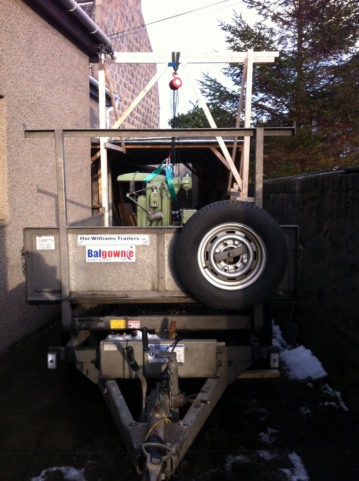

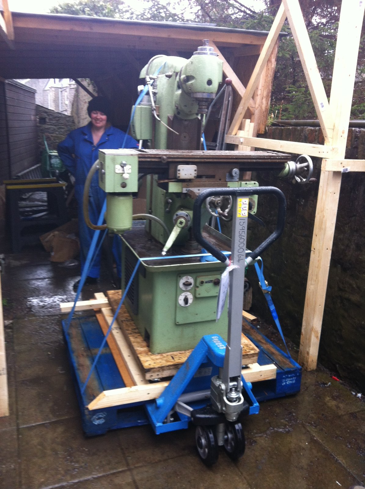

ive got no comment about that wood contraption total bodge up dont blame the mrs laughing at it even id be thinking what the hell are you sure its going to hold on that contraption
but i would have used a 4" x 12" beam

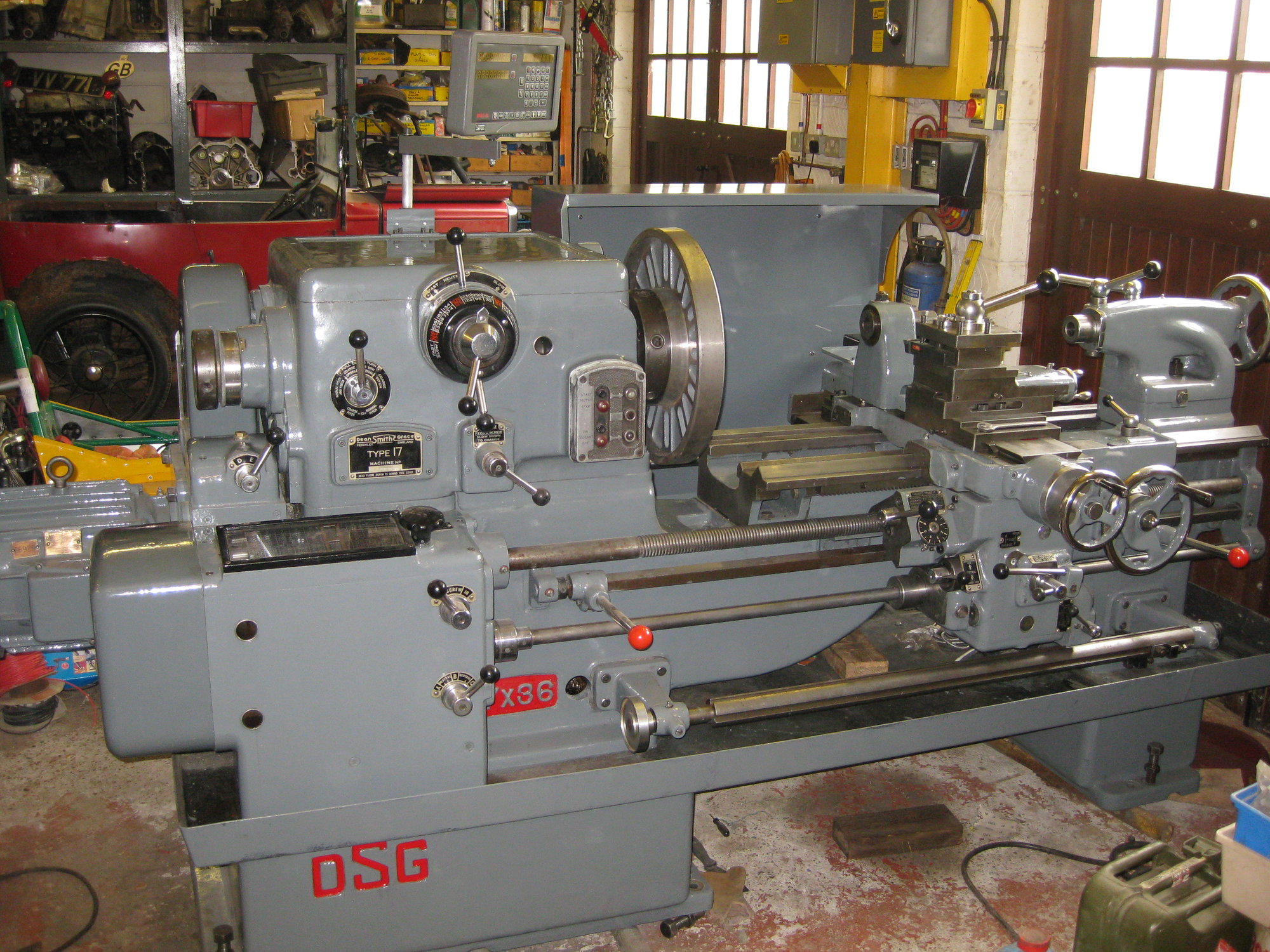

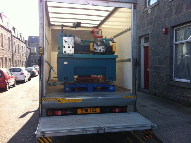

What's the approved method of shifting a DSG? do they have lifting eyes?
Nice looking machine!There's a through hole at the headstock end to put a huge bar through for attaching one lifting strap to. -it's next to "x 36" in this photo- the lathe bed has cast struts between the front and back ways -a 2nd strap through one of these and you're good to go.
