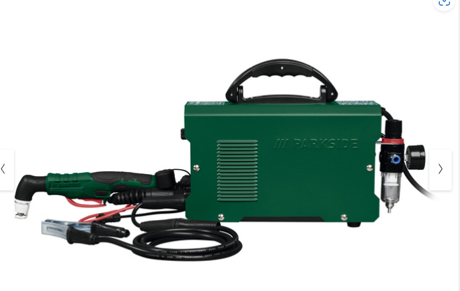

They're back in the NI stores, still the 40a version but it looks like they have a pilot arc torch now.
https://www.lidl-ni.co.uk/p/d-i-y/plasma-cutter/p67580
Unfortunately the price has increased to £149.99!
Is that with the built in compressor?
There was a thread on here somewhere but I think the one with the compressor was £149.99 but didn't come with the pilot torch.
I'm sure someone in that thread found the pilot torch on its own in a German lidl and had one sent over.
Not sure if they will sell the torches individually over here at any point but you might be able to get one as a spare part now?

Hi all,
I've got the 40amp Parkside Plasma cutter. I would like to convert to pilot arc but can't get hold of the Parkside pilot conversion kit (PSPP 5 A1) mentioned earlier in this thread. Has anybody successfully made the conversion to a pilot arc using Non-Parkside generic bits?
