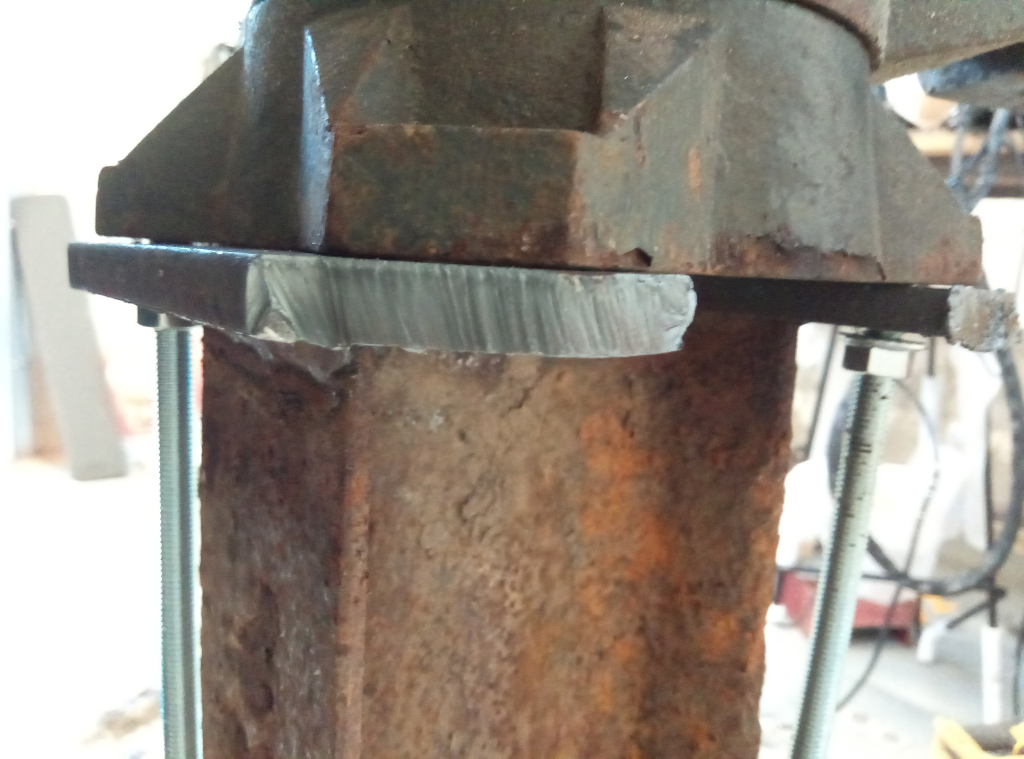

I've just bought one of the Lidl plasma cutters and have a question over whether mine has a problem or it's a characteristic. I'm a first time user with one of these, so am not familiar with the operation;
I can do a clean cut just fine, but the torch wont re-start until the post-flow cooling cycle air blast has completed. If I mis-strike, or interrupt a cut, I have to wait until again until the cycle is over before it will resume. Is this normal for this machine? Air pressure remains good and the connections to the machine are firm and making good contact.

I've done another check and mine certainly won't restart within the post-flow time. Even if mid-cut and I pause for just a second It won't restart. So for anything that involves multiple cuts in different locations (well within the duty cycle) it's painfully slow. I've triple checked air pressure and it isn't plugged into an extension lead. I undid everything and set it up twrice without any difference in behaviour. Current setting doesn't have any effect.
Disappointing, because there won't be any possibility of an exchange at the store as they only had three units, and from the limited use I've had out of it I'm really pleased with every other aspect.
I'd be interested to hear from other owners how their machine behaves. I suppose the only recourse is via the warranty.
