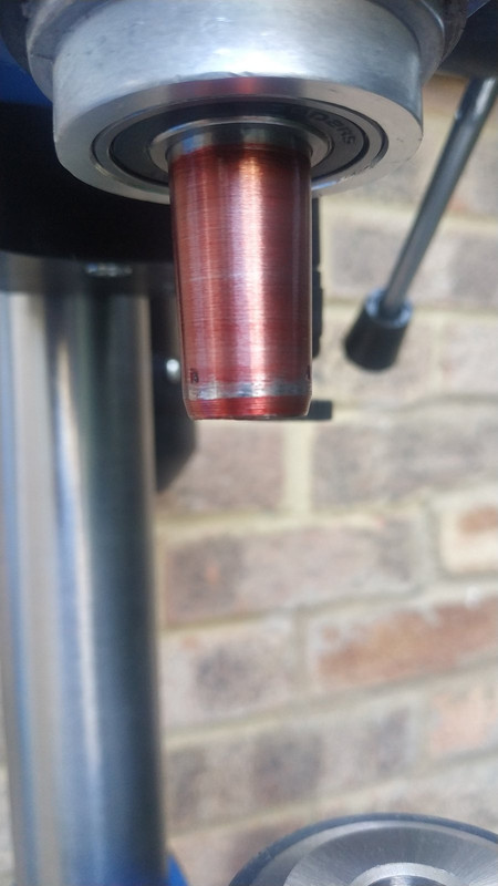

That is disappointing, I have sat in a dark corner of the garage the older version of the Lidl pillar drill I happily replaced it with the Meddings I was practically given but I would not say they were that bad.I got one, set up but not drilled anything yet, quality... pushing the limits of what I can accept, it might go back, or get some upgrades.
First thing are the spindle bearings easy to swap? Quite a bit of noise and vibration from them or something as the quill is lowered. If its easily fixed I will keep it.
The S2 15min rated motor runs hot after only couple minutes, appears to take ages to cool.
Good points the motor does seem like a real 500w with some torque, and assembled it has a suprising amount of rigidity for the weight.
What I dont like:
The base column mounting face is questionable. Every part needs deburring
The tube is pressed into a lightweight turned aluminium hollow casting ring, not sure if tube is pressed square.
Brake cleaner melts the paint off.
The head slops onto the column with quite a lot of play. Secured with two grubs. Starting to doubt if it will get square holes.
The head is a welded plate construction with steel inserts so There is no reason for the column bore to be such a bad fit.
The belt cover locking bracket is bent so the bolt does nothing.
The belt cover safety switch.. I can touch the belt before its raised enough to cut the motor. Its not far out but for a UK shop sold item I am suprised. The bolt has a shoulder so no adjustment without putting a washer in there.
