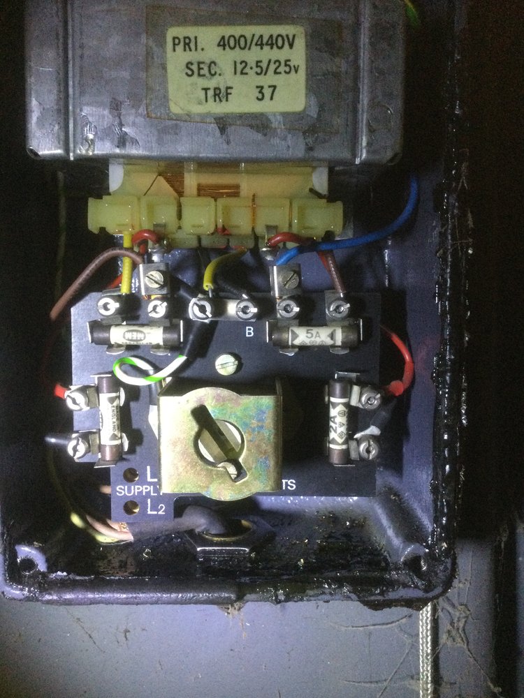

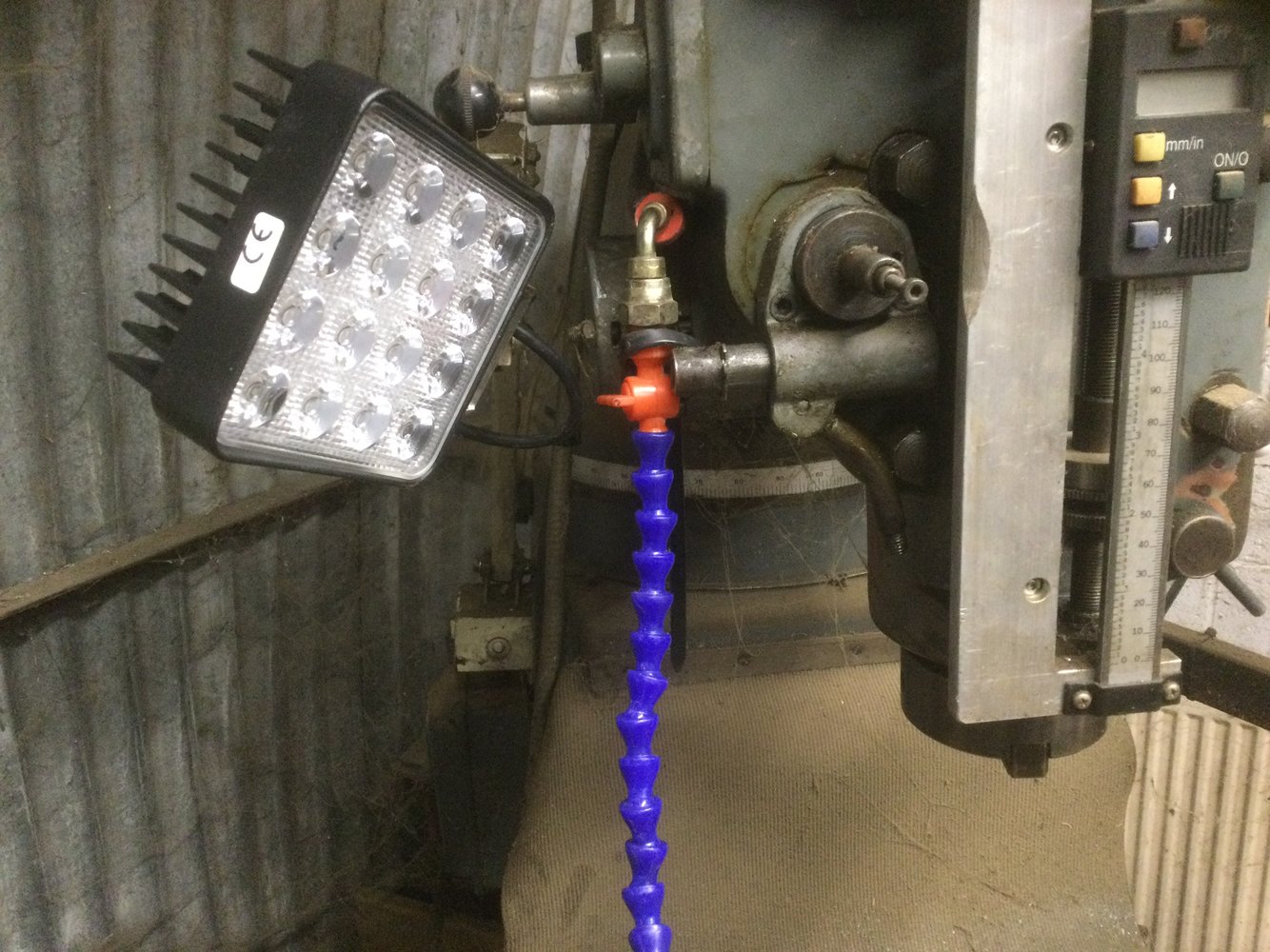

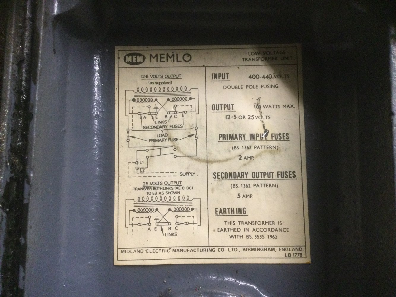

Just swapped the knackered bulb holder on the mill for an LED worklamp, the mill has a 24v transformer. The lamp works but has this horrible flickering going on, is there a way around this or do I need to go back to a bulb?
As always grateful for any suggestions .
