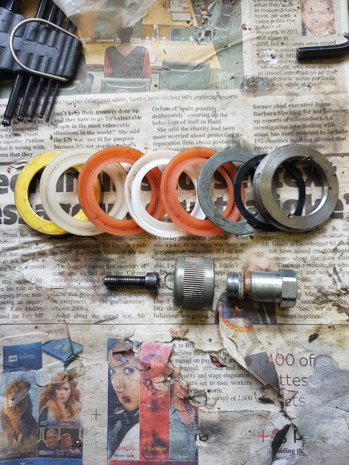

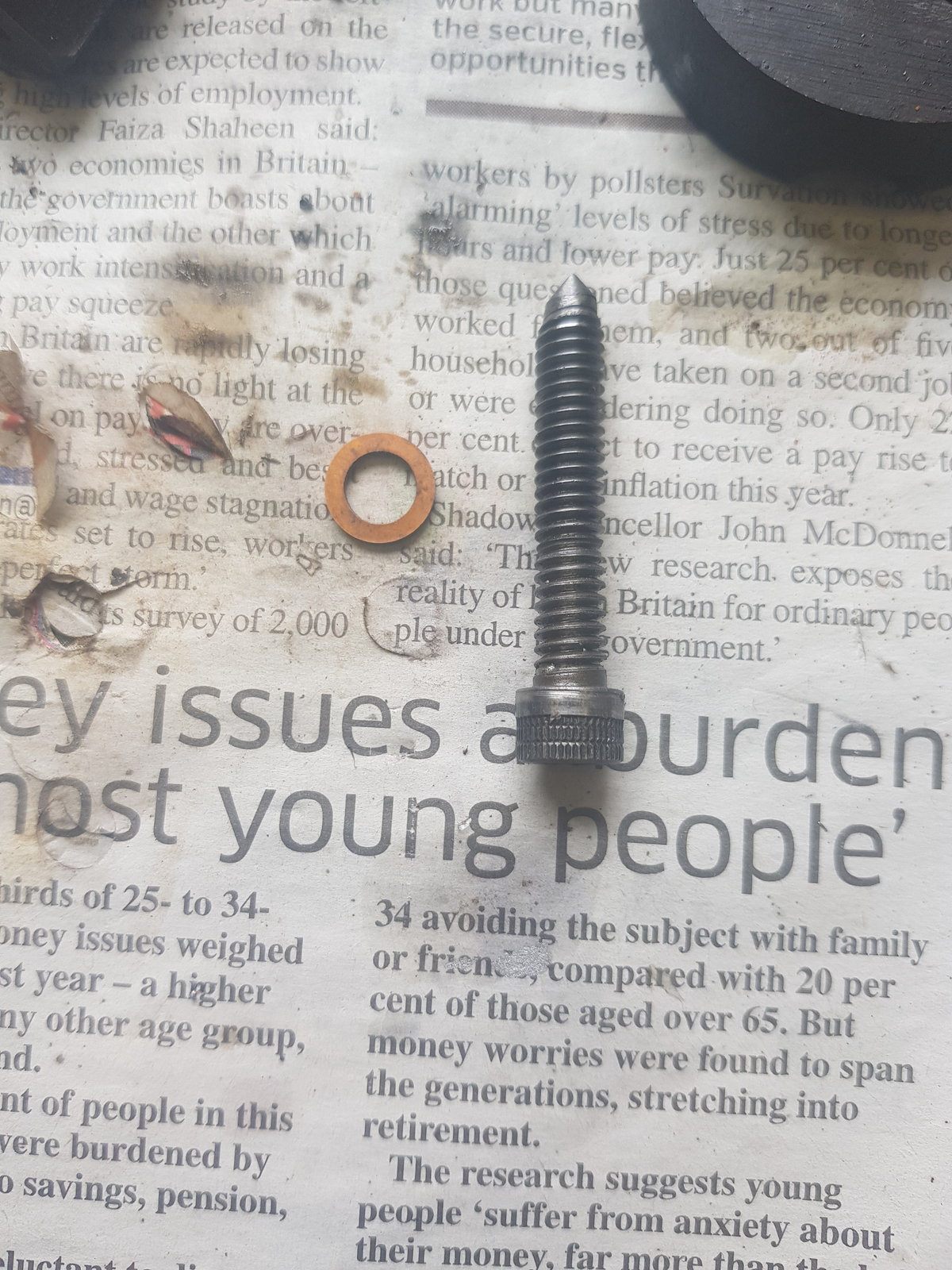

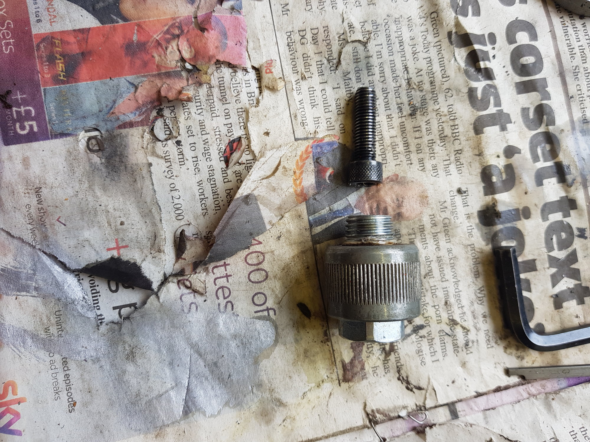

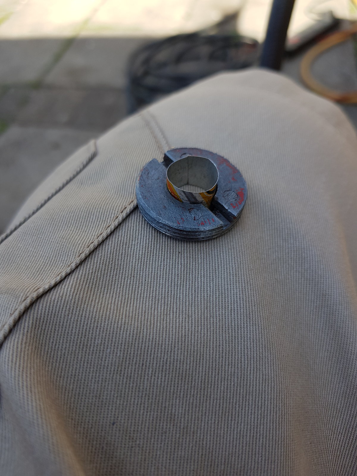

It's a fairly simple matter to disassemble the cylinder. Being single acting, there is a retracting spring and this is retained with a 6mm machine screw which is accessed once the hydraulic coupling is removed. Remember this, because I didn't

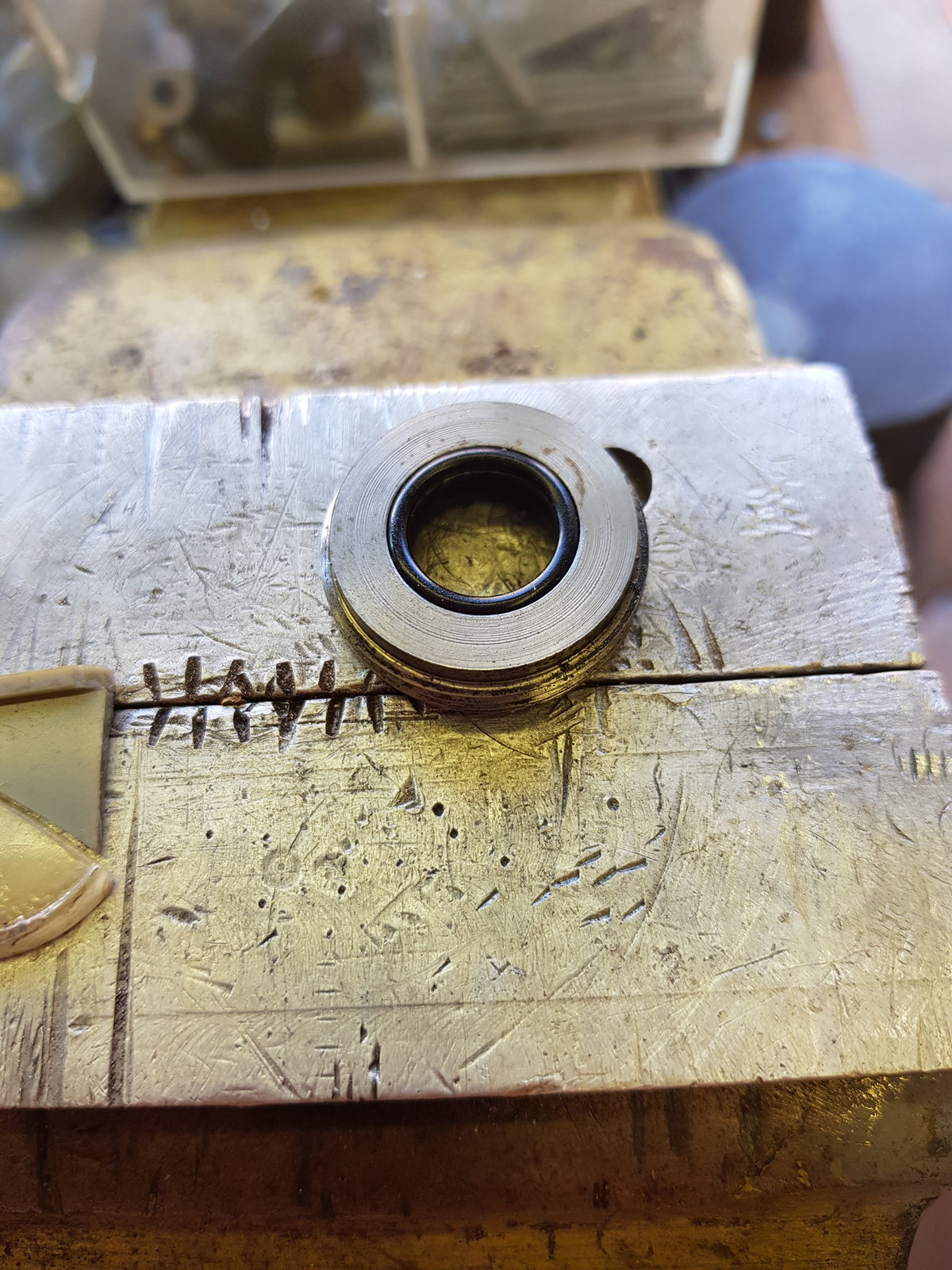

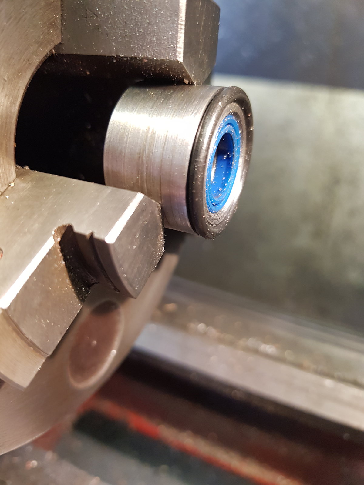

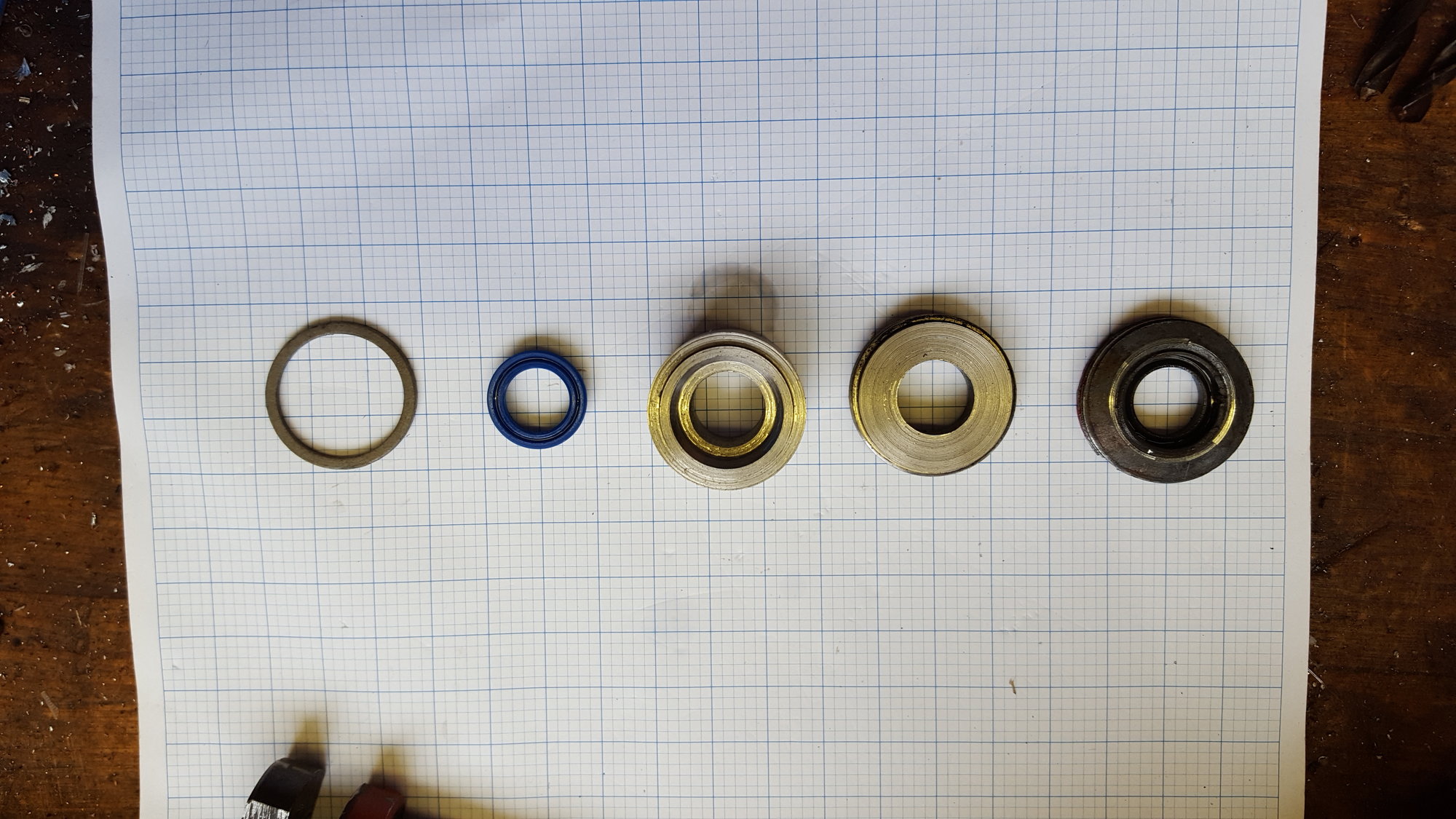

the locking ring can then be unscrewed and the piston rod withdrawn. the seals are retained with a threaded collar, pretty standard practice I would imagine.
There wasn't much wear evident on the sealing lips so I cleaned and reassembled the seal and just tightened the collar down a couple more turns. When slid back into the cylinder there was some slight resistance whereas when I dismantled it it pulled out with virtually no effort.
Job done

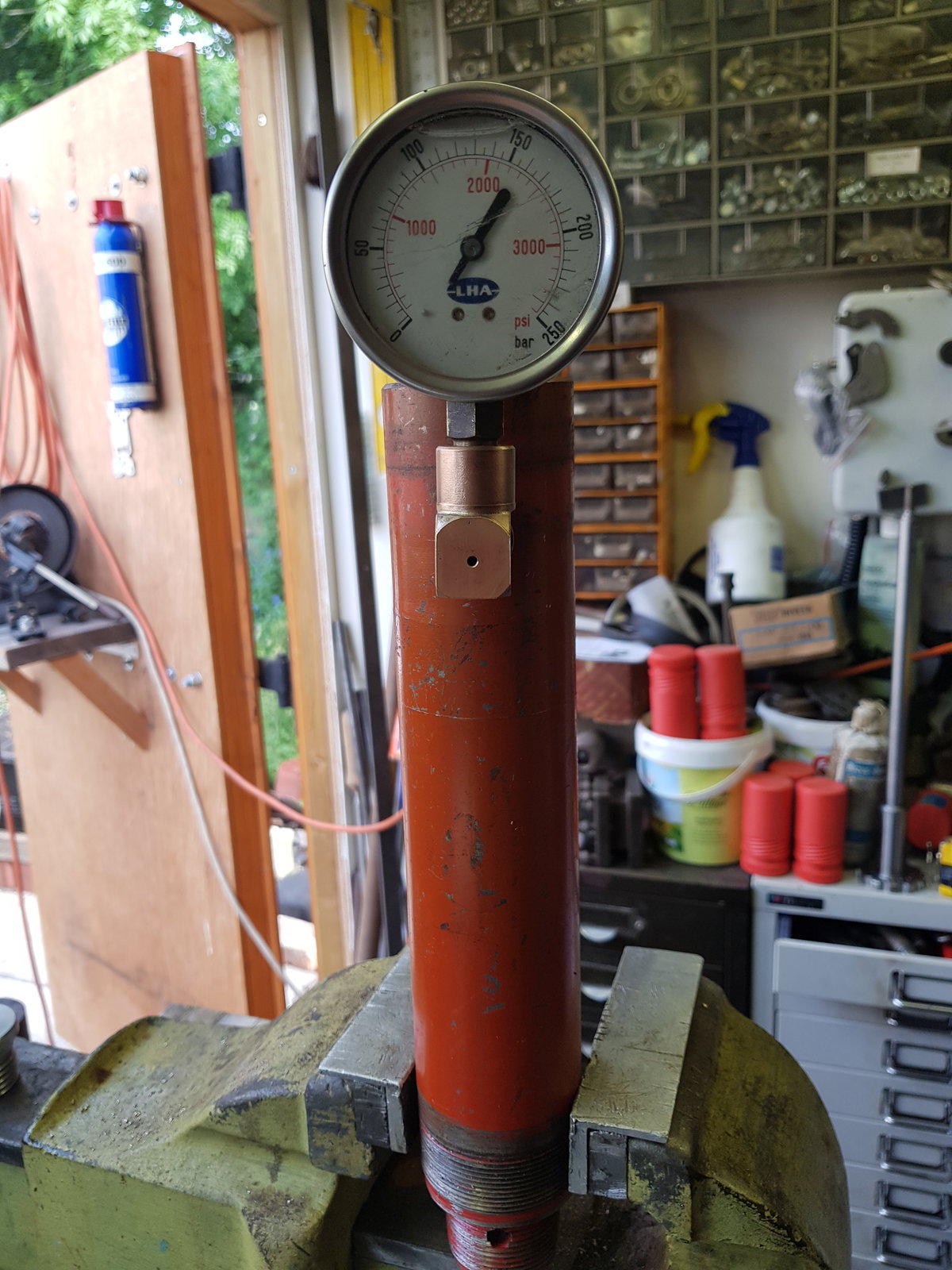

Except, some time ago I did think of fitting a pressure to it, because I could. During one of my tidying sessions I came across a couple of pressure gauges that I'd bought when trying to fault find a problem on my Range Rover back in 2007. Well, there's no time like the present, let's do it.
In my dash to get it done I decided to mount the gauge diametrically opposite the input port...
Popped a pilot drill in, all well and good, but there was decidedly less metal to drill through than I had expected. Any guesses as to why?
All I'll say is return spring and screw
Oh well, it's all fun, isn't it?

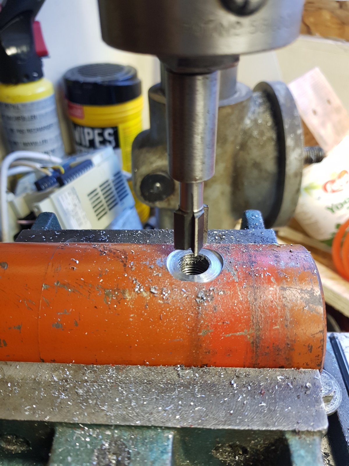

I intended tapping it BSPT and to that end had worked out how to screwcut it on my Boxford since I don't have a die. Good old Zeus provided me with the tapping drill size (for BSPP
) which is 20 thou larger. At this point I should have stopped, had a cup of coffee and a think, but I didn't. Expecting BSPT, I was going to drill through and then tap. Since it was going to be BSPP, I could have drilled part way and then squared the bottom of the port to allow for a sealing washer on the face. Never mind, there are other ways to skin a cat, fortunately.

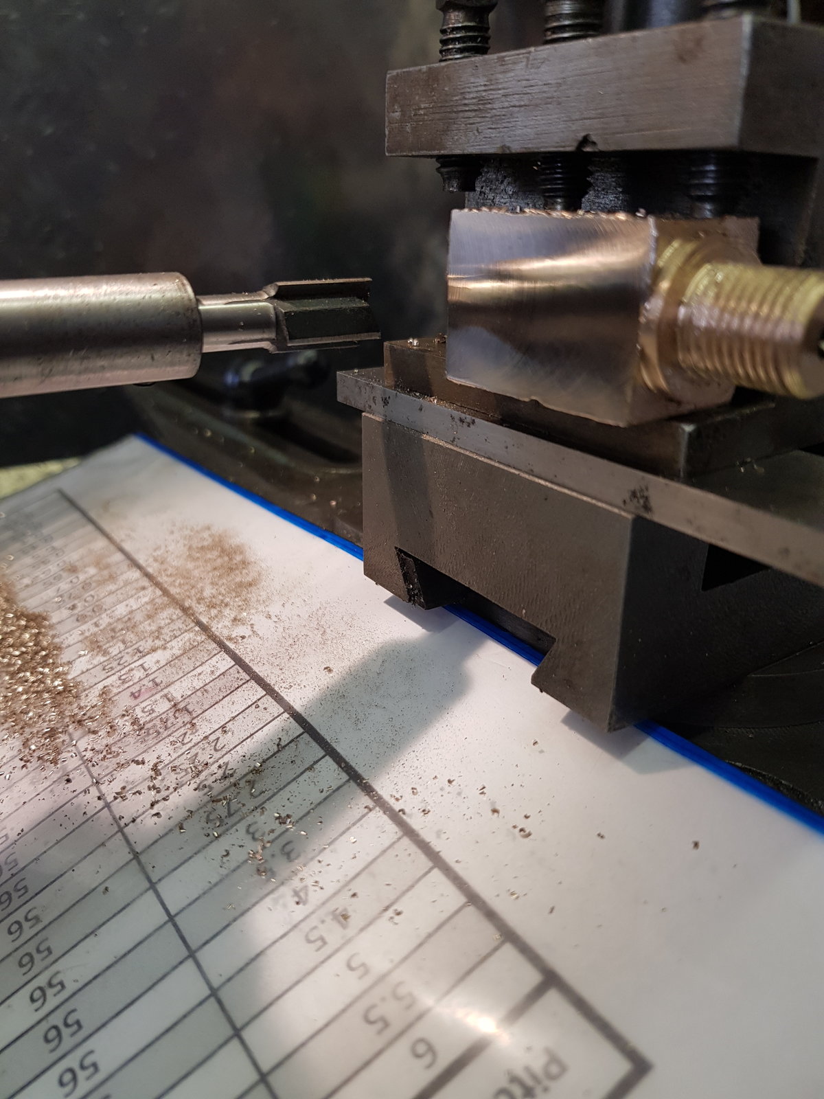

I don't like thread tape, unless there's no other way, so I decided to face the cylinder wall to allow seating for a copper or Dowty washer.
What did I do before I bought a boring head? It only has a limited range but it's more than paid for itself over the last couple of months. Once again the Progress was pushed into service as a vertical mill.

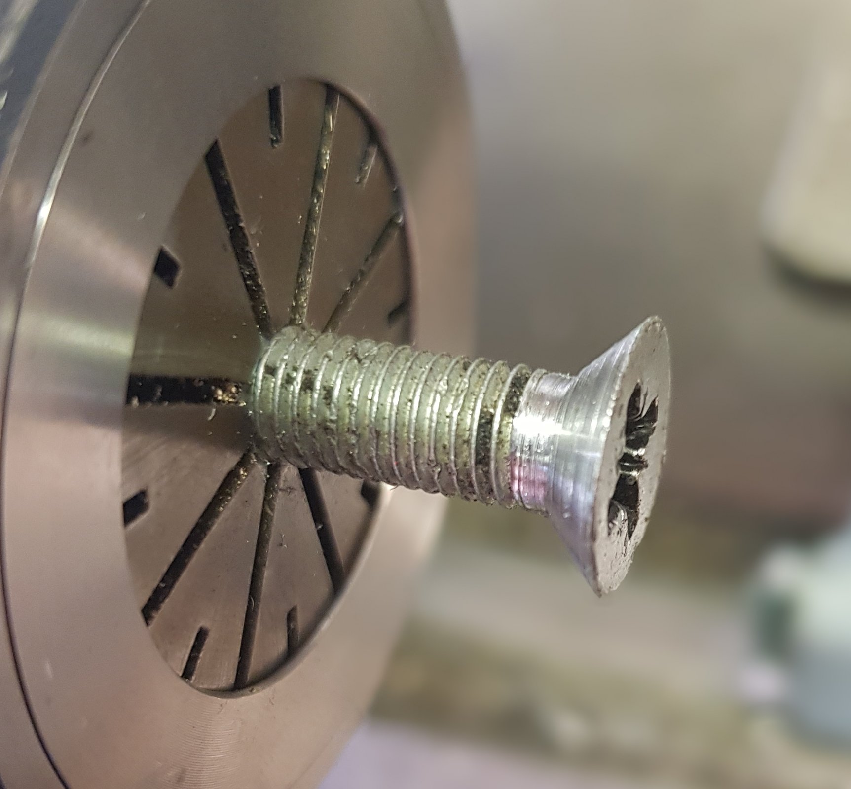

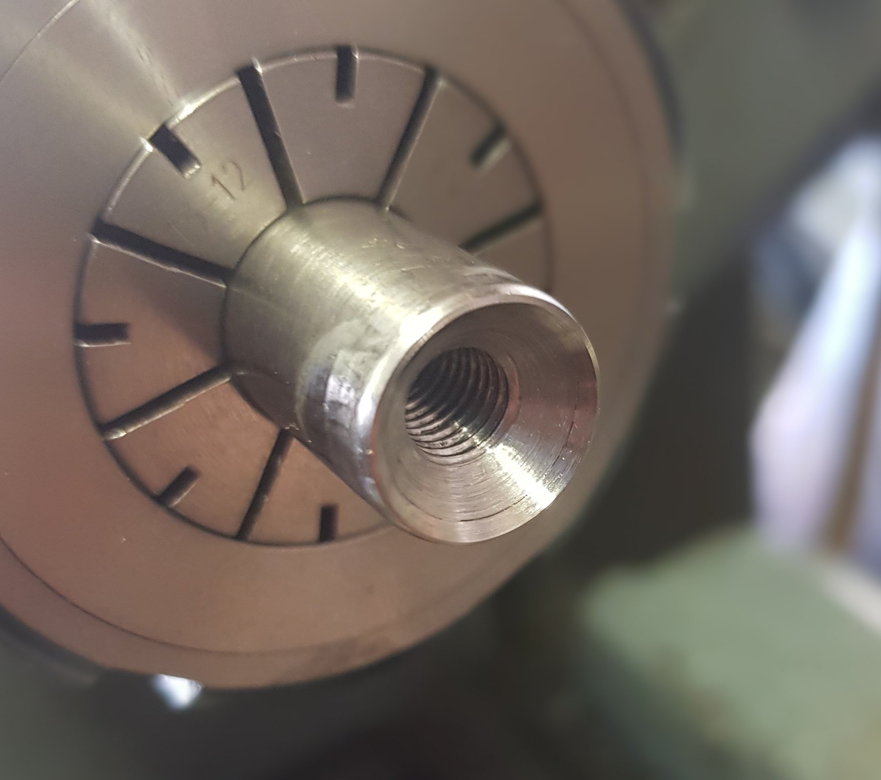

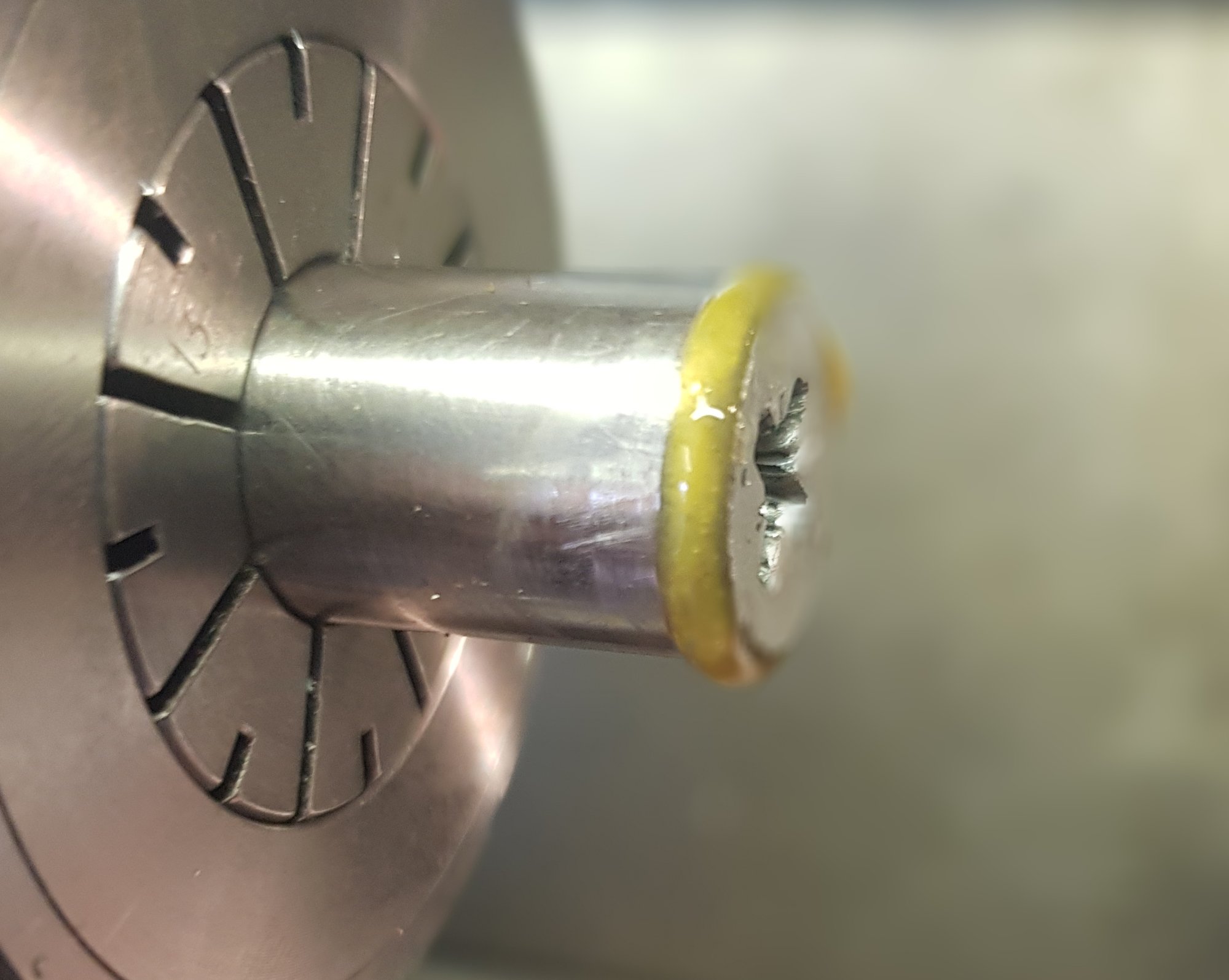

The question of how to hold the return spring was easily resolved. A hole was drilled at 90° to its original position, then counterbored and finally tapped. A handy 1/4" BSF machine screw was tweaked and the whole shebang reassembled with a copper washer as a seal.

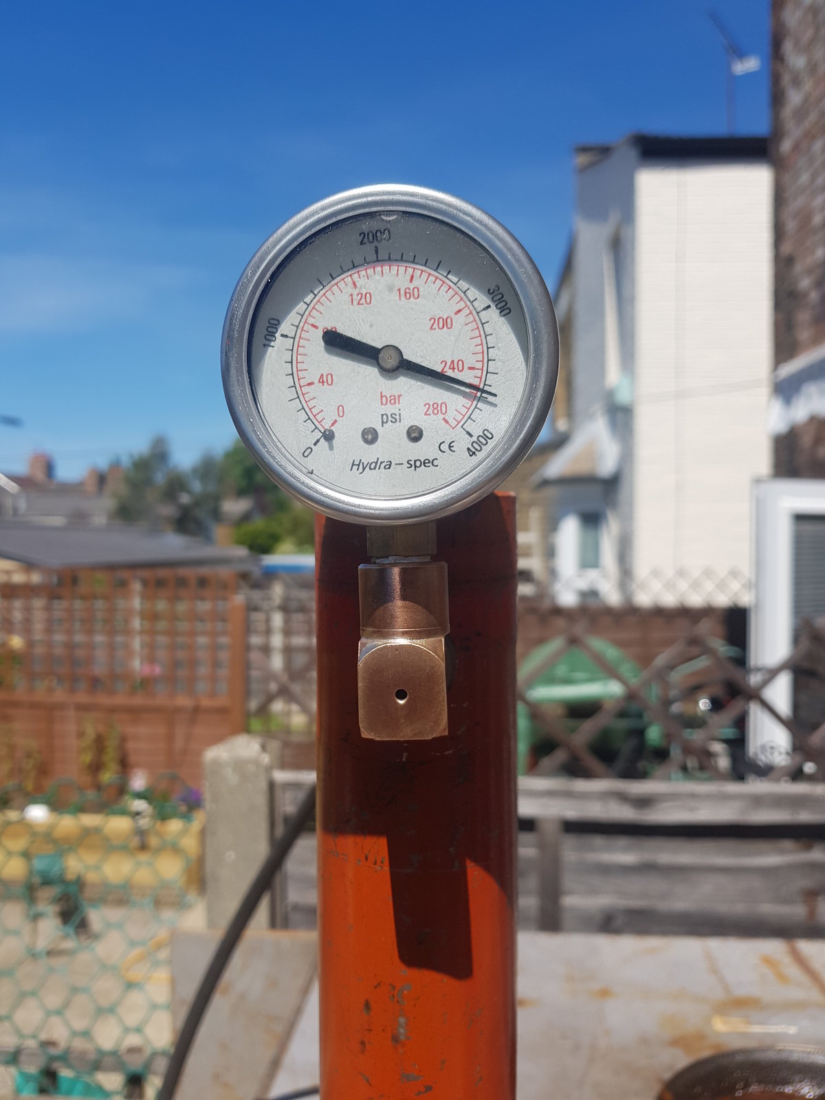

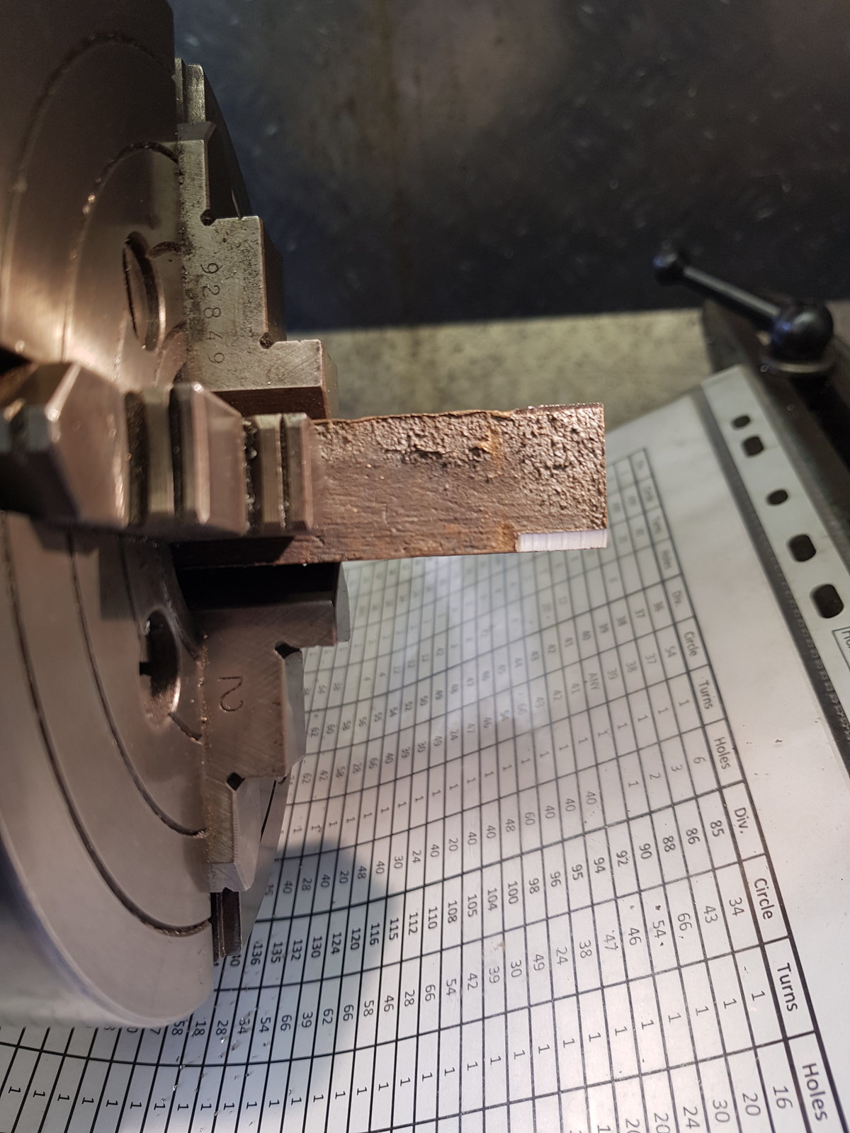

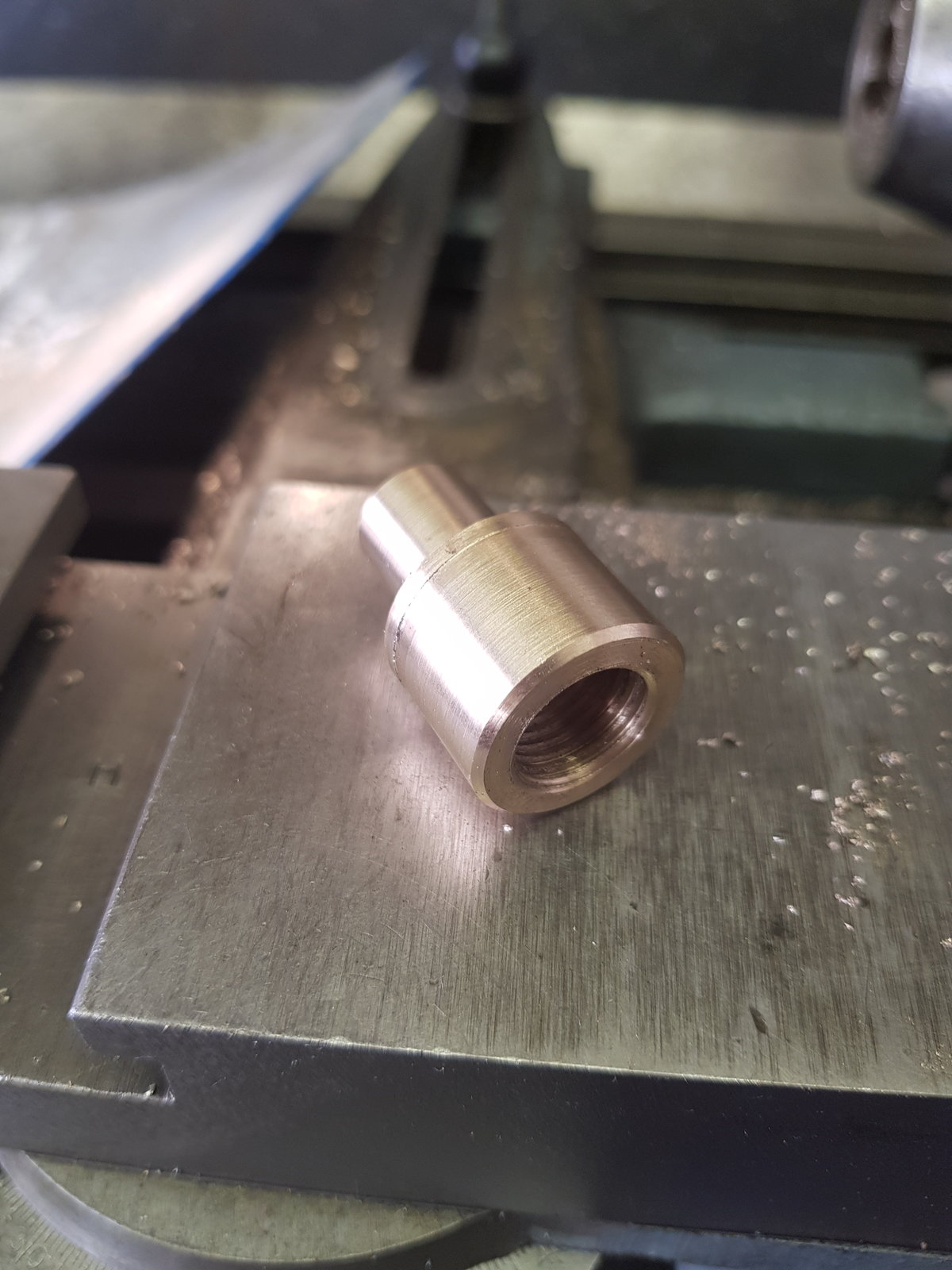

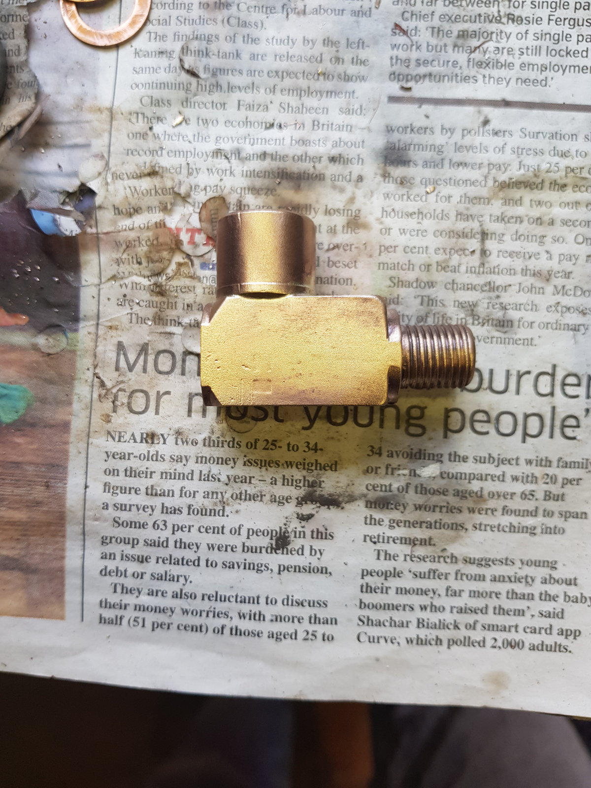

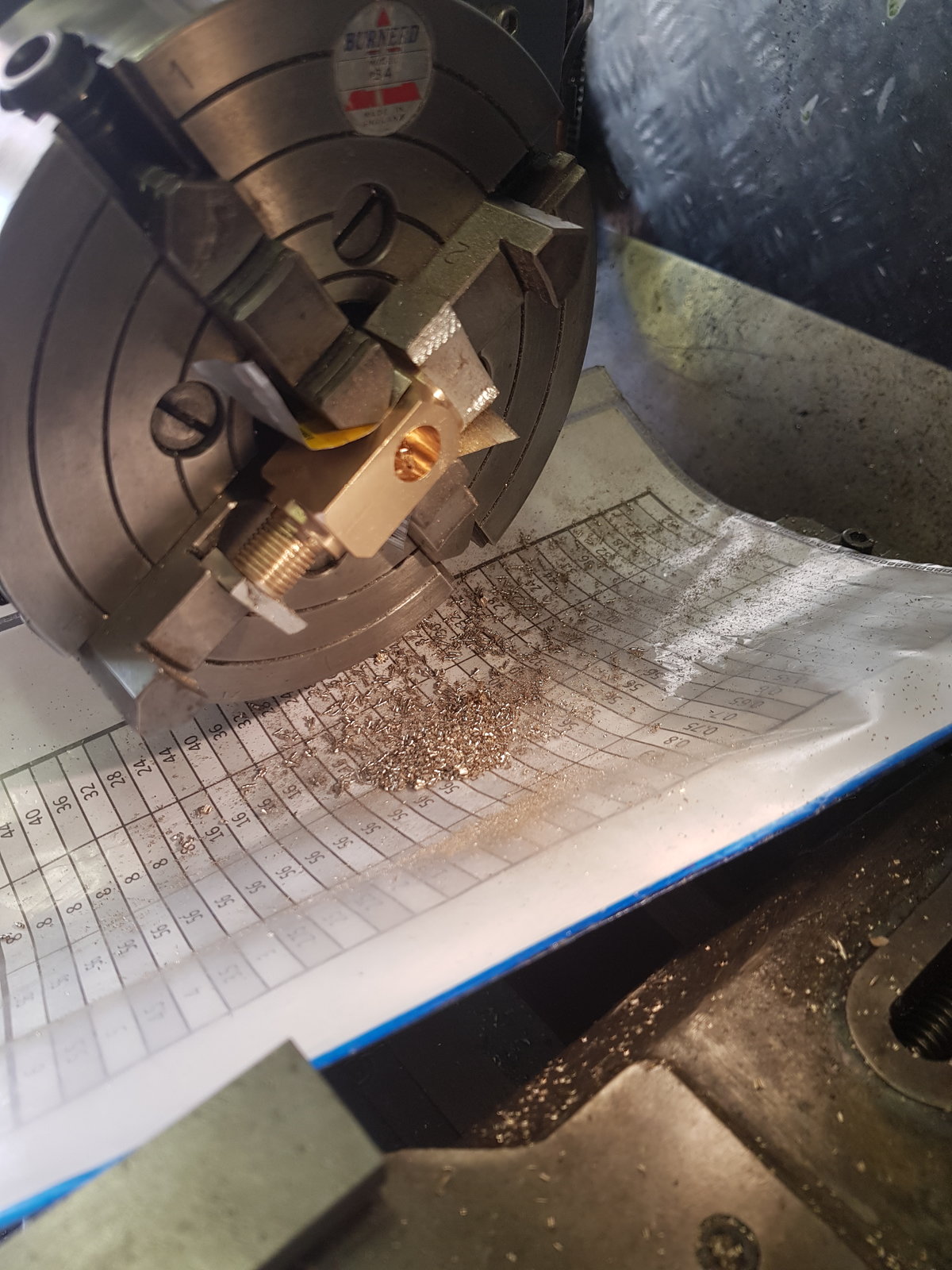

Now to the question of how to mount the gauge. Usually It's stuck in the top of the cylinder but for a reason known only to my inner mind, I decided that I wanted it on the side. Now I needed a right-angled fitting, which I didn't have. But I did have a lump of cast bronze of unknown origin and composition, So I set to to make one.
And some more silver soldering action left me with this

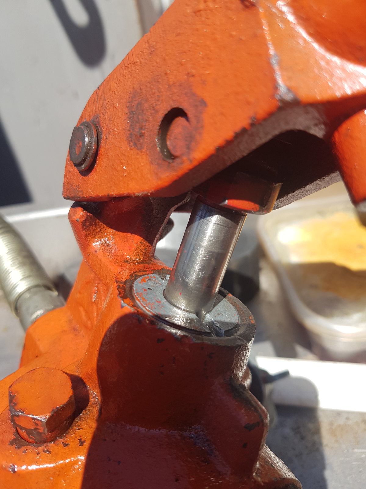

And the finished article, except that I dropped the gauge during the day and it wasn't until I'd fitted it that I noticed a small problem
Oh well, it's just as well I have a spare
