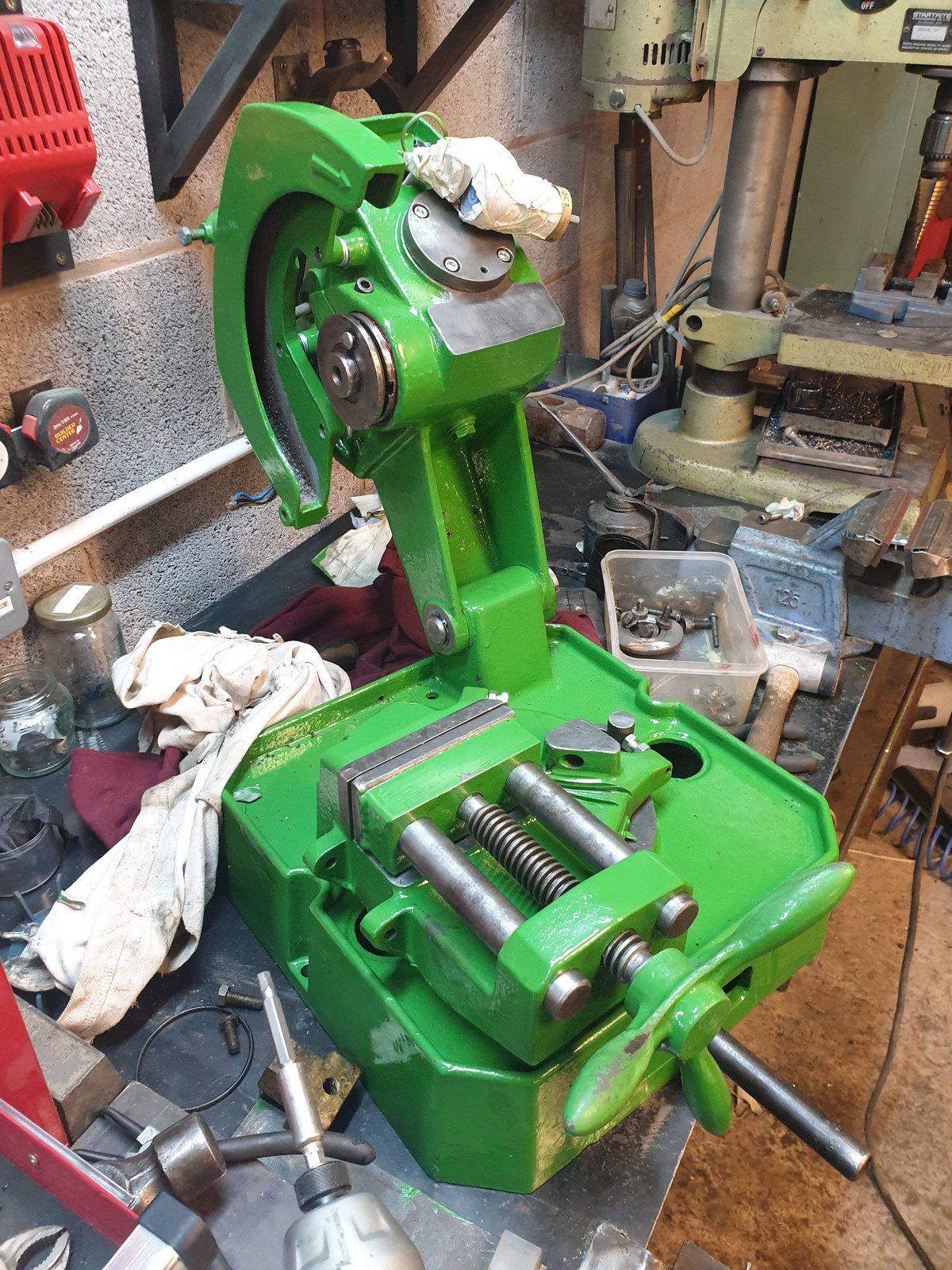

No not on the inside. Could I make one out of something ?No seal on the outside of the bearing?
Yes its the saw, what is groil? Do you think if i just packet the bearing with grease it would work.Jack is that "the saw"? you can always use groil, a cartridge of grease and then top up with oil.
Bob

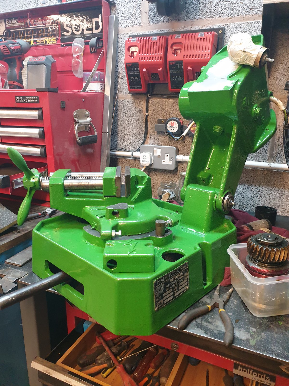

Thanks for that. I have replaced the outer o ring. I have tried that on the bencb filling it up and it does t por ont straight away, it leaves a minute or two, so that's why o thought its leaking through a seal. So you think I should try a puller the blade flange . ThanksJack looking at that hub I would say there should be an O ring in the groove on the outer case to stop oil running along the outside of the hub, there must also be a seal on the bearing behind the blade flange. You could check the one behind the flange by filling the hub on the bench and putting the gear back on a bit quick. The two squares on the outer case are probably for somewhere a two legged puller locates for pushing out the spindle.
Bob
I have tried tapping it but when I do, all the energy is lost through the beafings as the inner seems to move up and down slightly. I have reached the o ring. If I puller it apart would the bearings have to be replaced?I agree with @8ob that central shaft should push out - there's probably two taper bearings and the nut sets the pre-load. Have you tried tapping the central shaft with a soft blow hammer? Looks like you have an o-ring in the outer groove - always a good idea to replace but I suspect this is leaking through the bearing race and there should be another seal between the blade flange and outer housing - potentially just felt.
They look to be angular contact bearings so be careful.?.
Interested to hear your logic on that statement.
The bearing shown clearly has rollers as its rolling elements. I was under the impression that angular contact bearings always used balls as rolling elements.
Also, angular contact bearings are used when there is both axial and radial thrust. On a saw, where does the axial thrust come from that requires an AC bearing?
