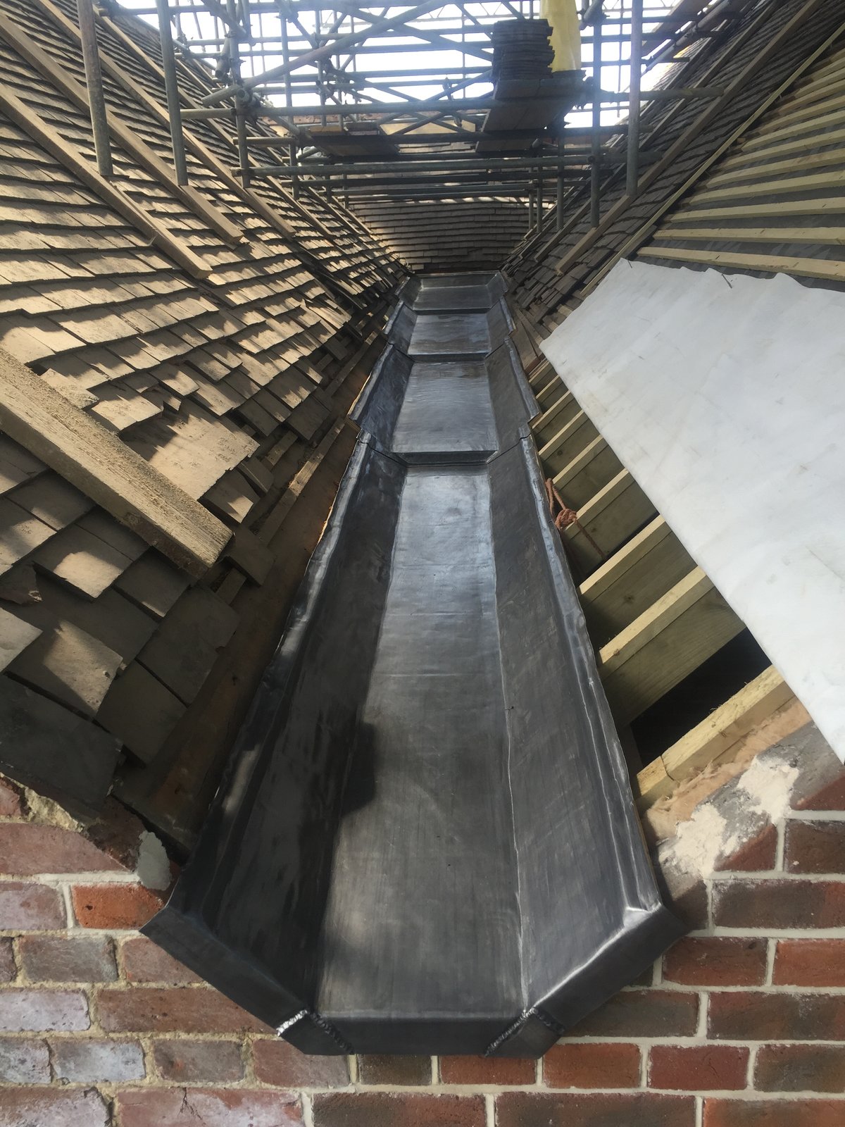

That was me mate and i still struggle to produce work that myself would be happy to pay for and that's why i sub it out...Having the right tools and a head full of youtube clips does not always make you an expert. Lead burning in the garage is half possible but get out on site 50 ft up hanging off a roof ladder in windy conditions and its another ball gameI sold one on here to a member as I would never use it as I already have 4 oxy acet torches![]()

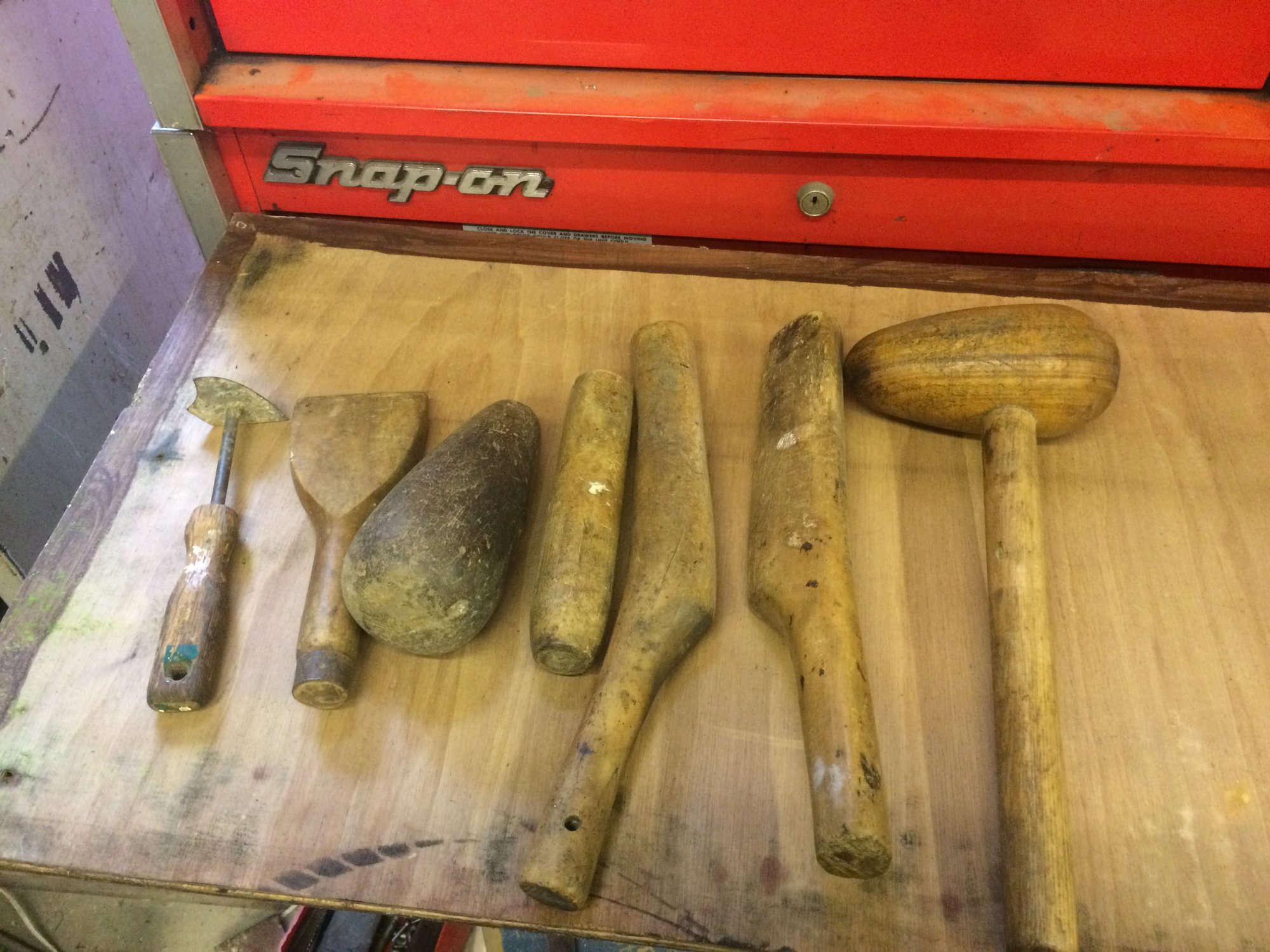

That's where plumbers get their name from chemical symbol Pb, the Latin word for lead is Plumbum. I remember when plumbers did as much lead as copper especially in industry.View attachment 165002 These were my fathers which he used for lead and copper
I was told back in the day when plumbers were tradesmen they would do lead work on roofs etc

very nice workYou can still buy them: - https://www.thewelderswarehouse.com/Welding-Supplies/Model-O-Lead-Burning-Torch.html
I have one of these and it's very good. I use it with a Hobbyweld oxygen cylinder and MAPP gas.
View attachment 189291 View attachment 189294
