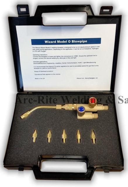

    For flashing into a wall maybe
    Rig Pig and roofman like this.

  7. It’s on mine/ my dads house, I’m an only child so need to get the reroof right he is a chippy by trade and has done roofs in the past but not lead burning. I would like to learn a new skill but not if I need acetylene I hate rental on bottles. Can you use o/p?

    You dont need OA for lead. The melting point is so low you can use a decent blow torch. As for filler just cut some stops of lead and scape off oxidation. Lead is lovely to weld bit like TIG
    I've done it with a little butane torch.

    you haven't got the versatility of a small oxy acet torch. using butane or propane you cant localise the heat . yes can be done but not very good

    I sold a tiny torch quite recently, Fine flame required, (and quite a lot of skill) the correct term is 'Lead burning" When I worked on the steel works coke oven plant we had a full time lead burner, certain area's of the plant had all steelwork covered in lead, A real treat to see him work, Made it look so easy to do a lovely run, None of the dab dab dab that I have seen others use, Good luck.

    I sold one on here to a member as I would never use it as I already have 4 oxy acet torches :)

  17. eLuSiVeMiTe
