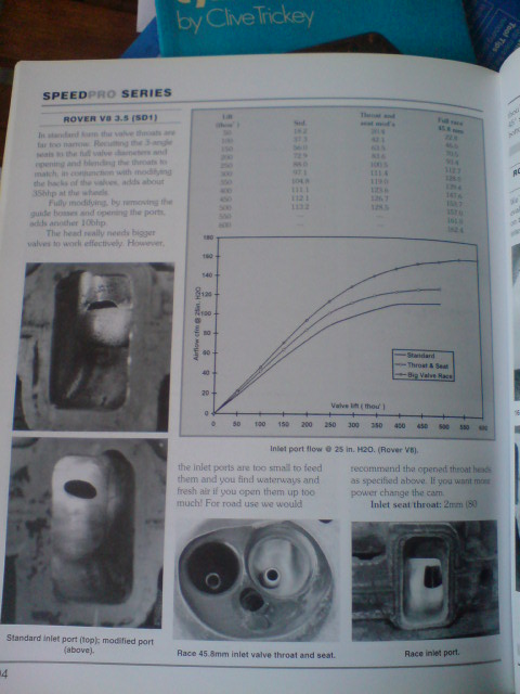

I think the OP 'needs' to do a Rover V8, I suspect there'd be some interest on here![]()
A cracking engine.
