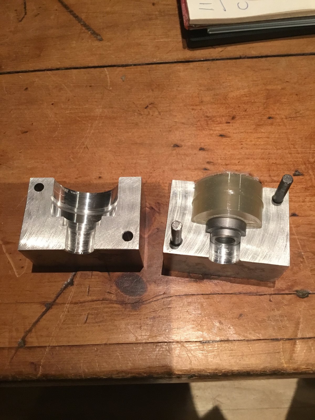

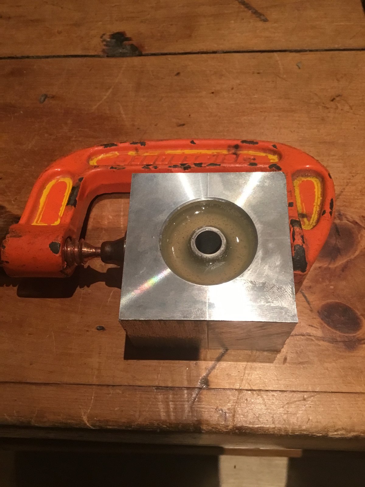

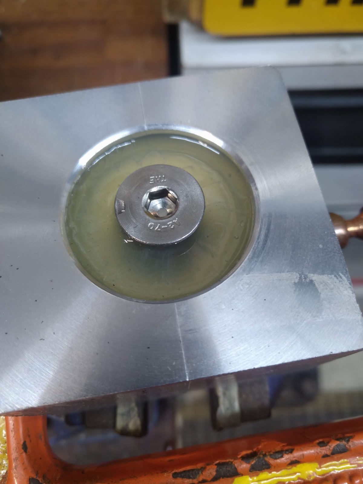

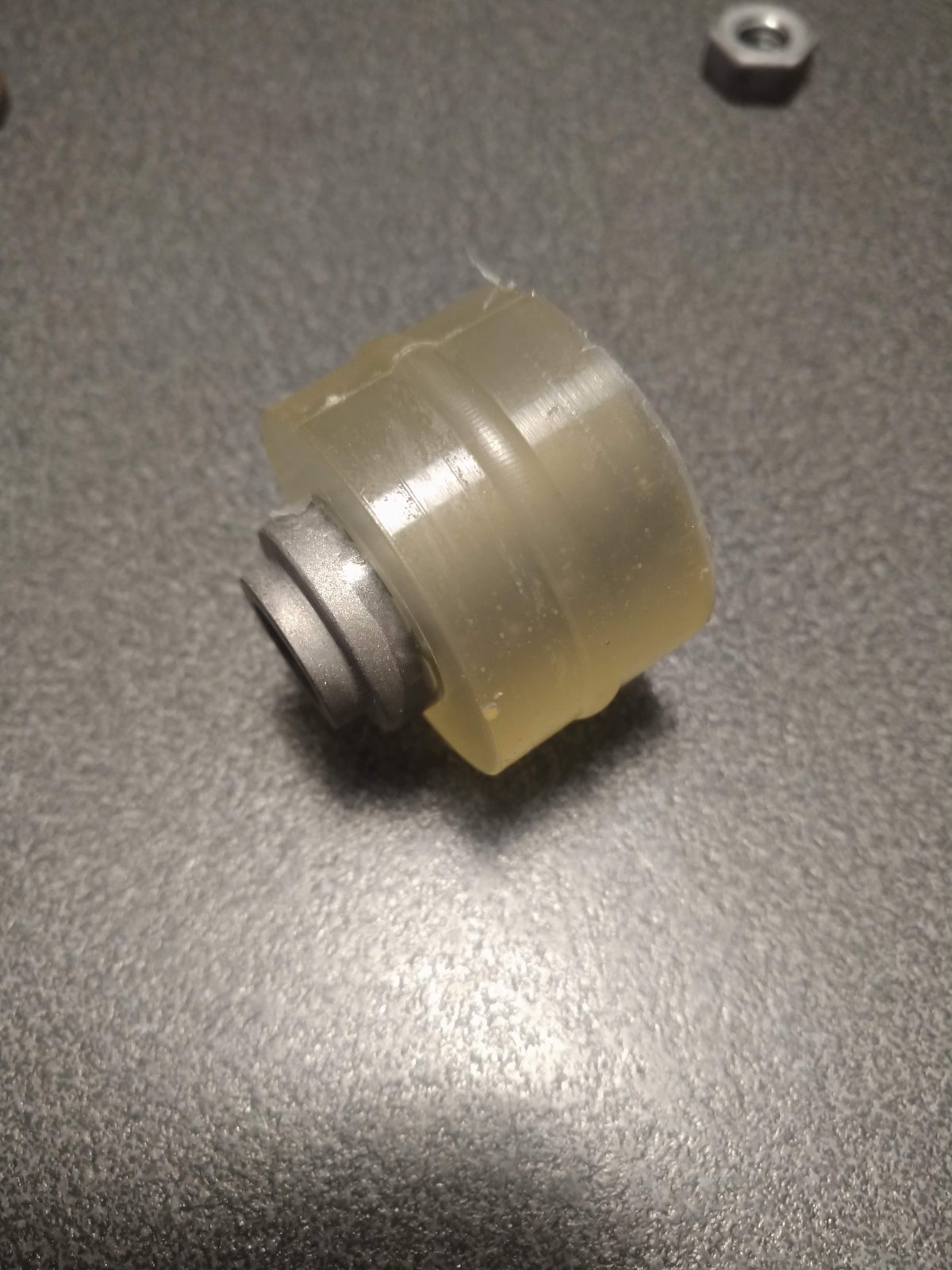

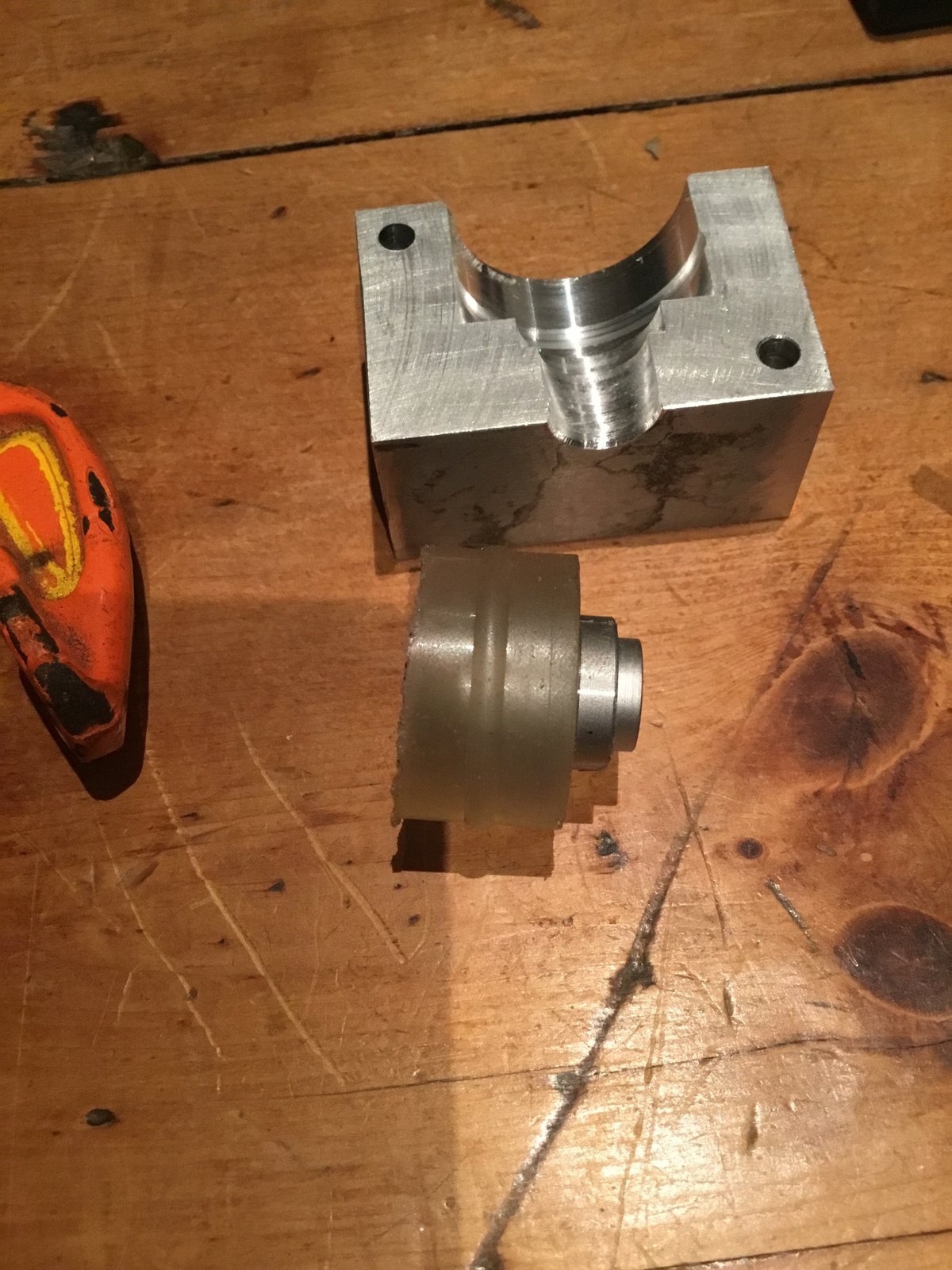

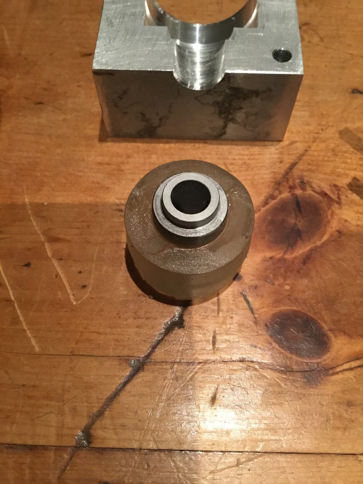

No, something I’ve not required. Wanted a vac pump but not the pot. Had a look on ebay not sure what size pump I require. It starts to thicken up after 3-4mins so don’t want it to take along time degassingAny access to a vacuum pump Shox? That's the usual way you see pourable stuff being degassed. Get the whole thing into a paper cup or whatever you're mixing in and then but that into a vacuum pot and drop it as low as you can get. It'll "boil" because of the reduced air pressure so leave plenty room.
Hopefully the glass blasting will give a good key for the resin
