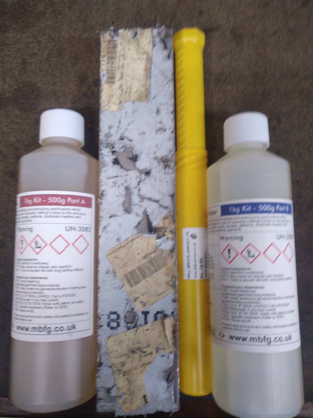

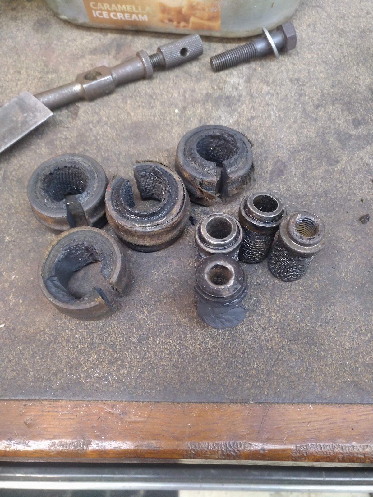

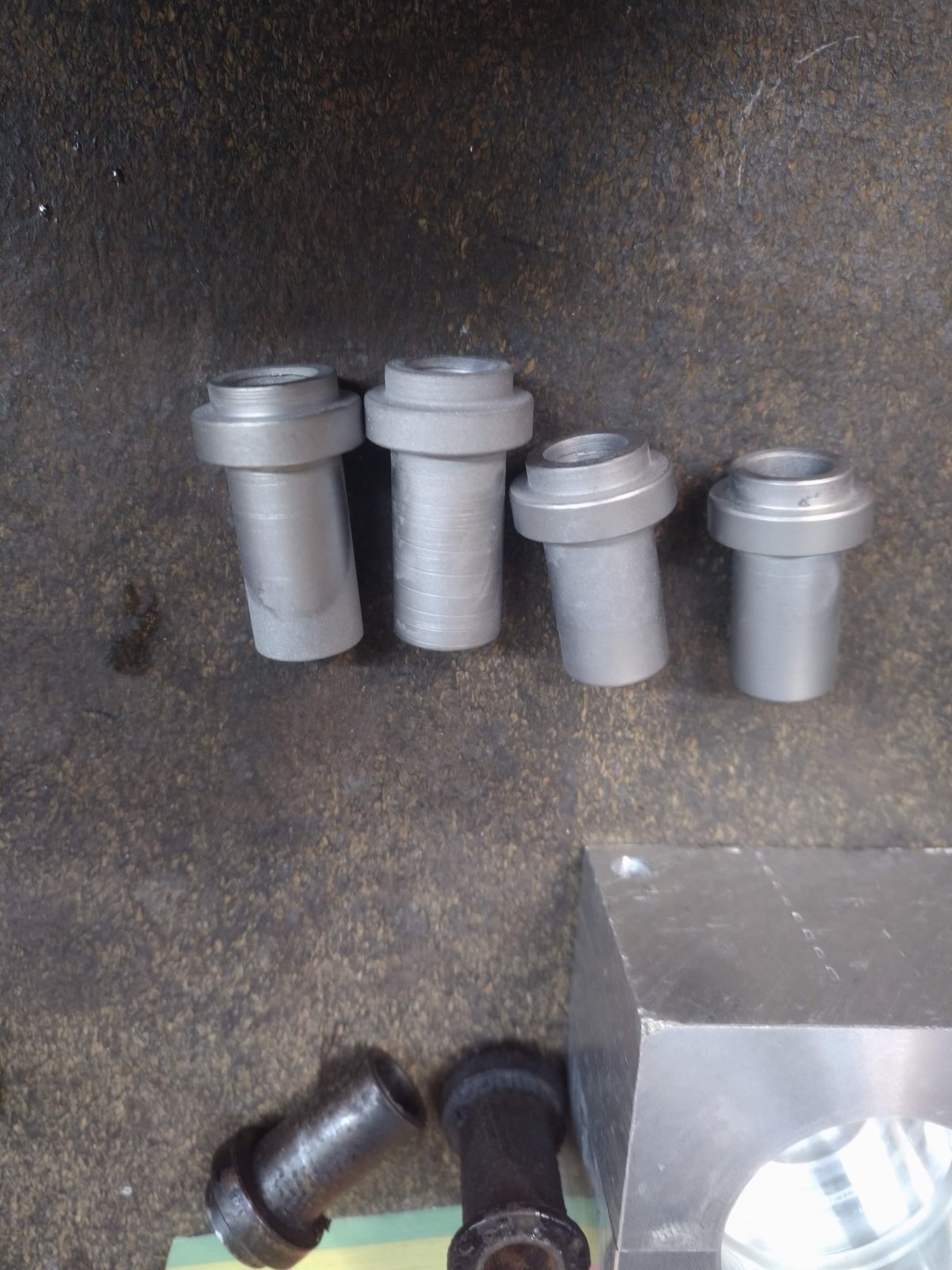

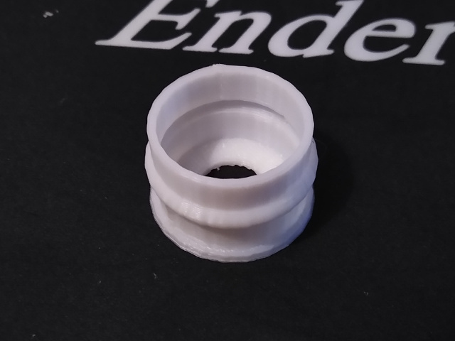

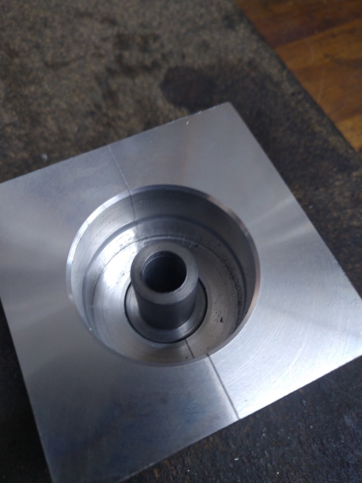

You're only making the bushes to swap out. Easier to keep spare bushes than a whole plate. TBH I would give it a try with the £10 starter kit, turn and tap the inner parts, 3d print a mould. It'll cost you £10 and some time.
You are right of coarse. Its just another job/learning curve to get over.
(Never looked at the drop down, a tenner against 200 is nowt even for me)
