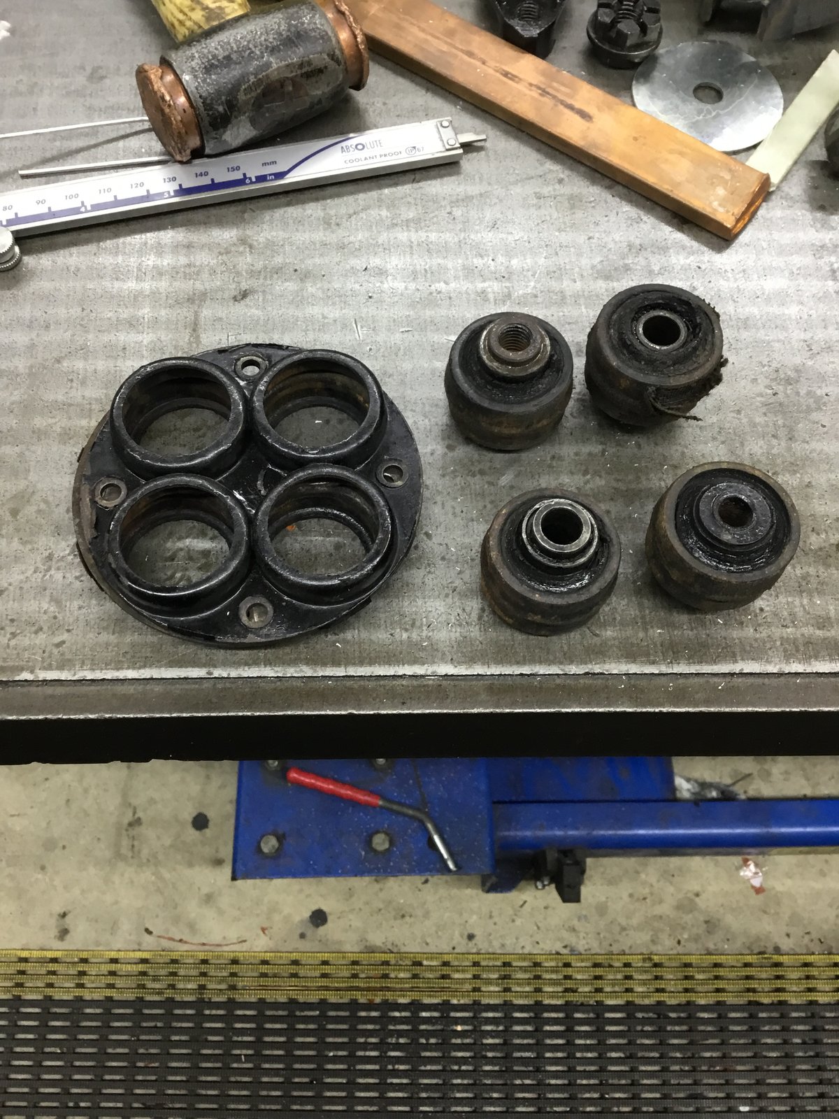

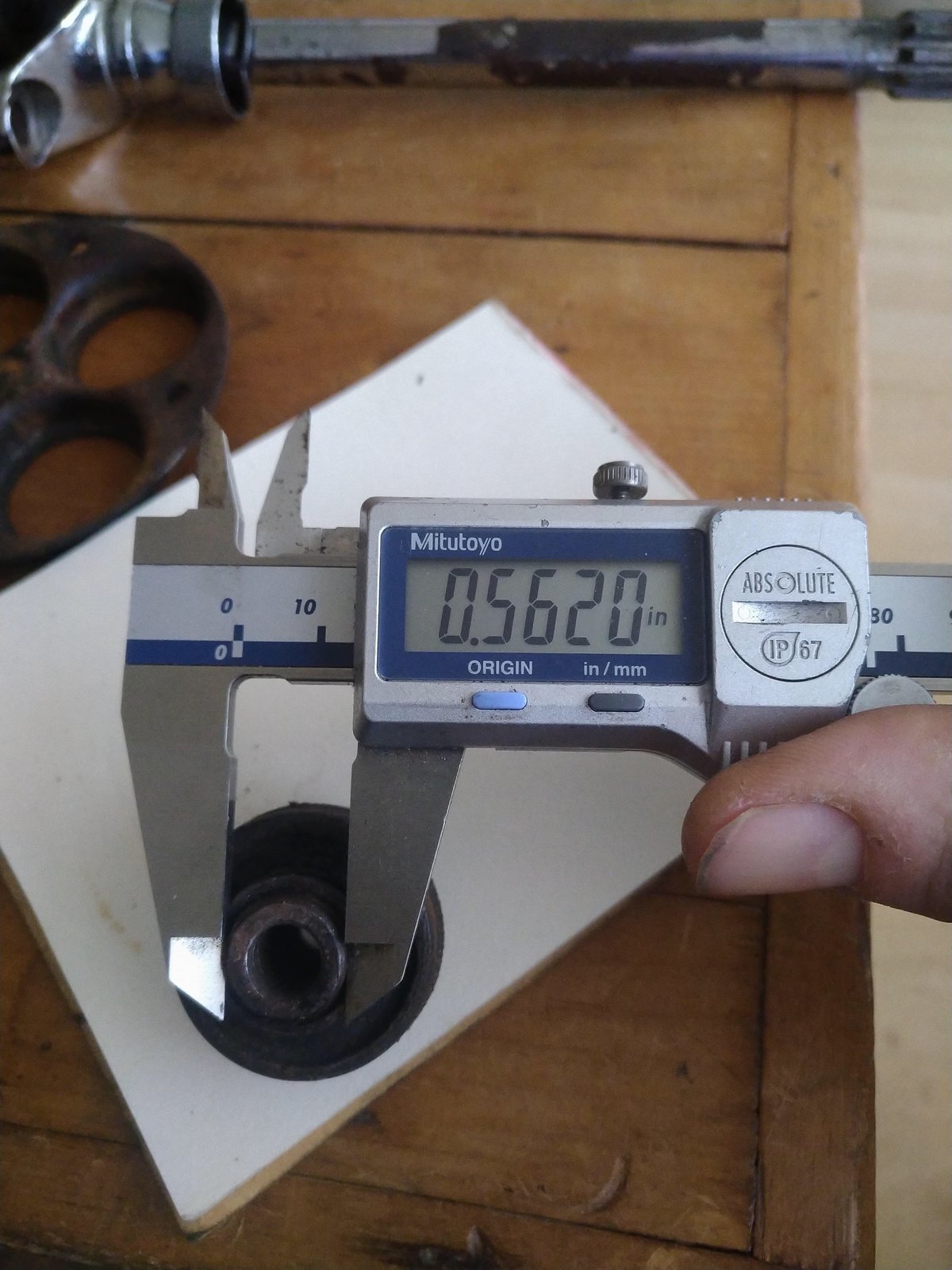

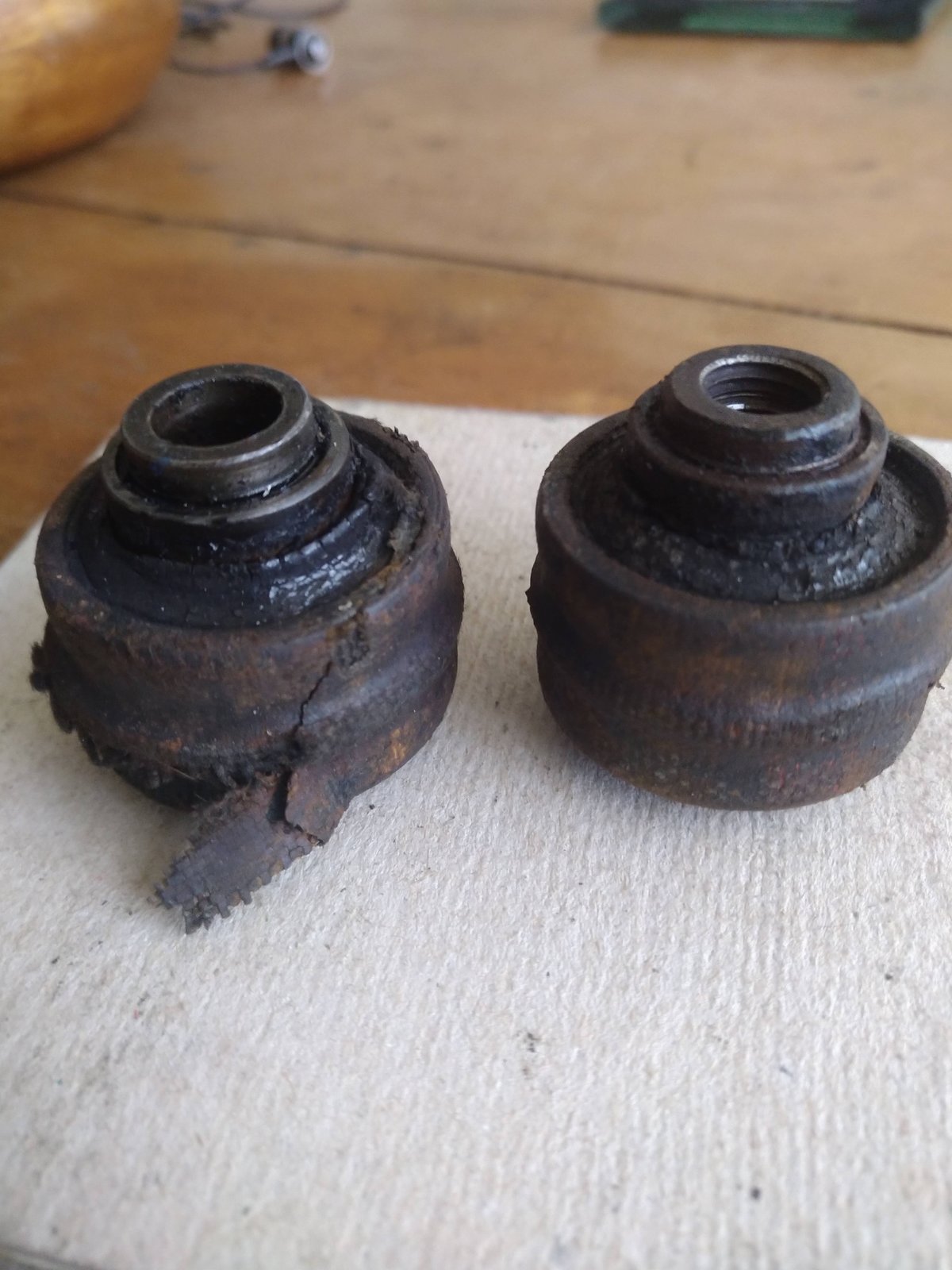

MkIII.
The mold is given a Light smear/polish of Bees wax before a pour. Spilts with a little wiggle. I’ll machine the top to size in the morning. Then it’s product testing
I mixed too much for the second one, so used the waste to coat the handle on a Haywire tool I made a while back. Dried super shiny but dulled off as soon as I touched it. It sticks like .. to anything [barr sleeves
] so doubt it will come off. Might try it on some pliers
