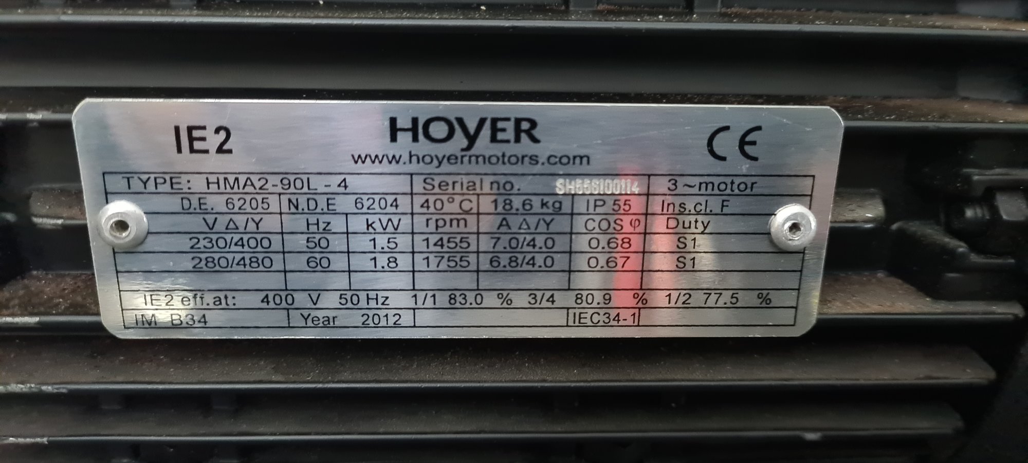

If this is the data plate from your motor then the motor will need a 7 amp supply at full load when the motor is wired in delta.

I assume the inverter is 230V output so perhaps a daft question, but have you got the motor wired for 230 V delta connection?
If it was star connected the performance would be very poor with only 230 V going in.

Is it set at 3000mA? If it is that is 3amps. To run that motor it should be 7000mA. I’ve never used one of these vfd’s. The ones I’ve seen all have the motor current in amps rather than milli ampsI looked at P78 which on this is Main current overload and Default/original setting is 18000 should be 3000mA according to the instructions. I havent altered it incase i messed it up more.
But the motor is rated at 50hz at 230v and 60hz at 280v.well was told 100hz but it only goes to 65
