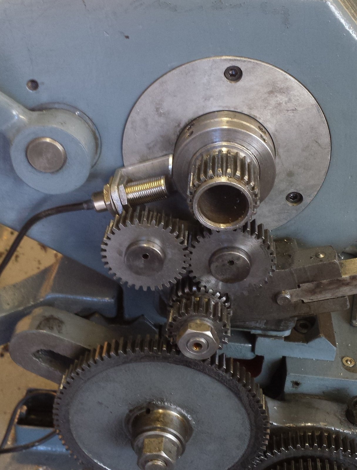

https://www.ebay.co.uk/i/3327021152...1%26rvr_ts%3D2a56e6ec1680a99c2647bcc0fffcc2f6Would there be a way to ad a tachometer to the lathe if I am still using the old motor
How would that work
Same as a speedo on a push bike. Counts the revolutions and displays. Small magnet on the spindle and sensor mounted to suit.How would that work
Is it I'll order one of them thenExactly the same as I posted in my component list.
What lathe is that you haveIt uses a magnetic pickup with a magnet attached to the spindle. How you configure it is dependent on how your lathe is made.
This is how I mounted mine.
