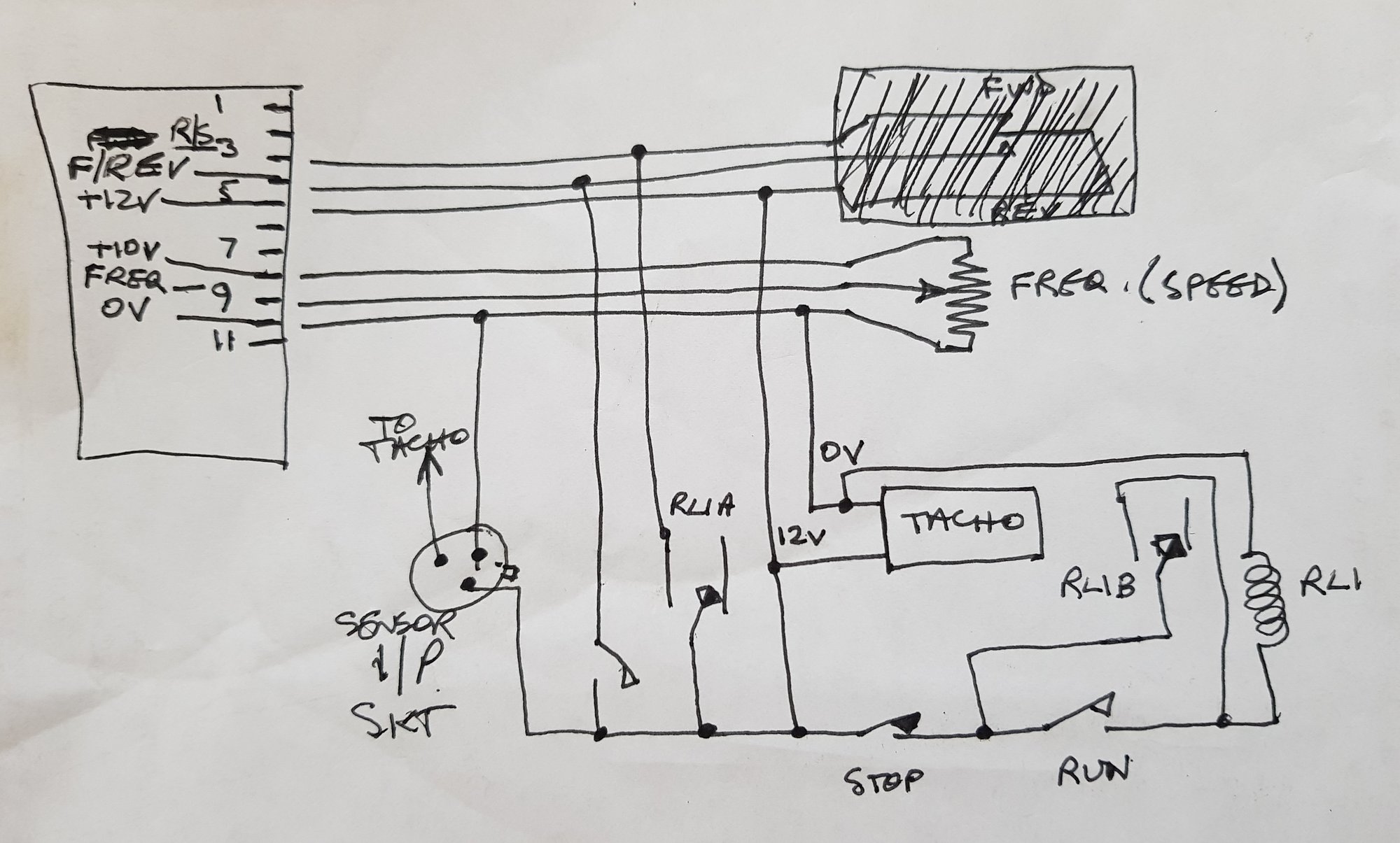

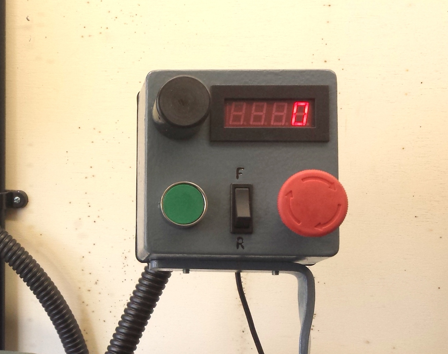

That's a very basic pendant; on/off and speed...You can have reverse and jog functions and, as I said, a tacho, although that's not a necessity.
This is mine, I didn't bother with the jog, but ever now and then it would be nice, it's only another switch.
I take the power for the tacho from the VFD 10V line, with no ill effects. there are a couple of relays in there set up as a latching circuit.
