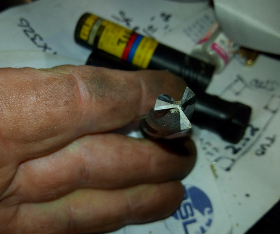

Bushes were also very hard but slowly slowly catchy monkey.If they are hardened then an endmill or slot drill in carbide will be easy
Are The bushes different then?
Biggest issue is this damn keyway. I hate being beaten. Lol

This is my problem. I don't know if I buy things if it will do the job. Most stuff I have is HSS unless it's for larger stuff.You also get 3 flute carbide drills which are excellent, I picked up a few Guhring ones, brand new, for very little money but if buying new you need to be sitting when asking for the price

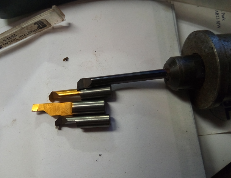

Remind me where you bought these?You do get boring bars that take inserts and go down to 8mm and below. I sold a solid carbide shank one a few days ago that I think was 8mm although may have been 10, the bar was def 8mm. Anyway there are also solid carbide bars that go way down in size, WNT do a set at a good price every so often and are well worth having as you can get all sorts of bars for them including grooving, threading, turning etc, see pic.
Top bar does down to 5mm, I have smaller.
As has been said though a solid carbide end mill or even a drill would work.

I suspect I don't need such small increments since I increased the cutting speed and was amazed how well it did actually cut. I only had to open an 8mm hole to 12mm.9 and 11 are not normal sizes, maybe 3/8 and 7/16 would do? Then again not sure how easy it would be to get imperial anyway.
I was amazed the way it collapsed and crunched when the cutting speed was slow but cut like butter when the speed was higher.

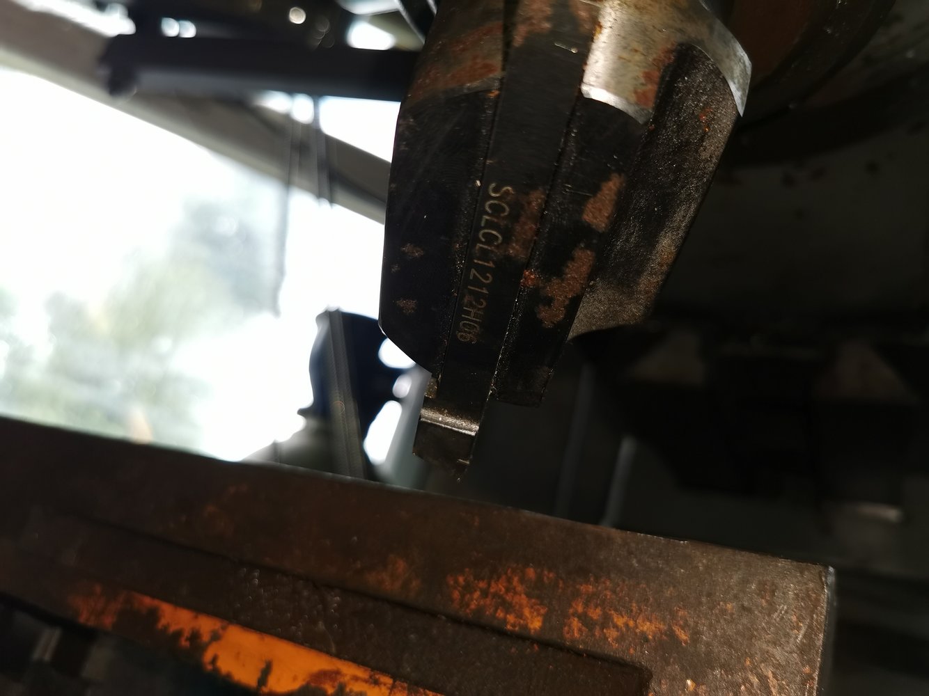

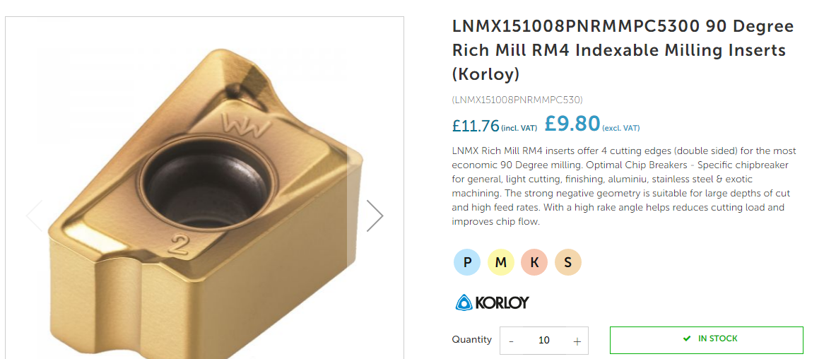

Facemill. Although no carbide really likes an interrupted cut.Me again.been a bit busy during the last few weeks but I have just been asked to take 10mm of some steel bars with approx 20 of 30mm holes in it.
Definately hardened and my fly cutter ain't too happy at cutting it.
Would you all use a tipped milling cutter or get some CBO tips for it...assuming they are available
