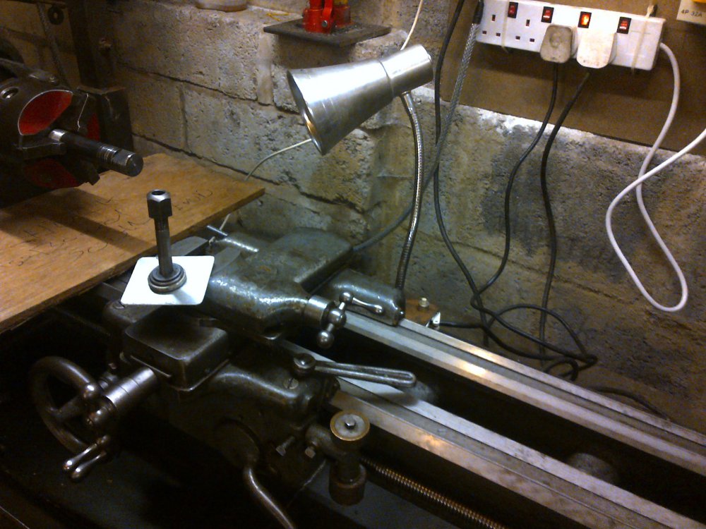

You cant have enough light above a lathe, i use two from ikea.

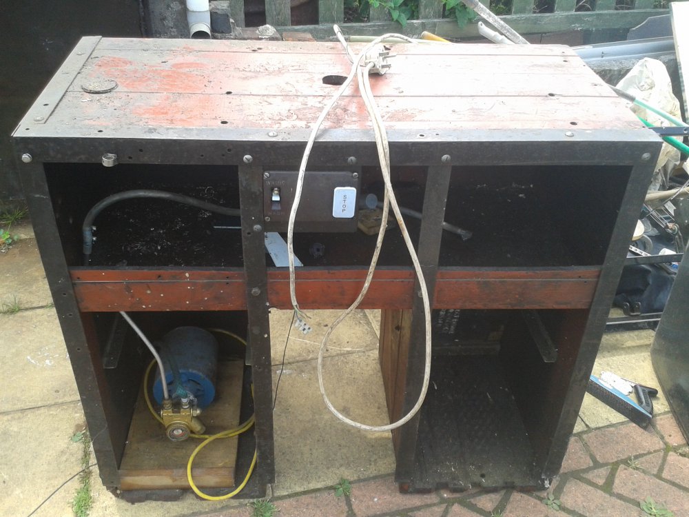

For levelling just use a bolt through a nut welded on to an angle iron foot, level, the bolt down. Small machine like that will vibrate a bit if you use it, near its full capacity. Of something offset in a 4 jaw chuck!
