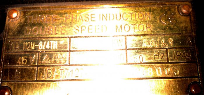

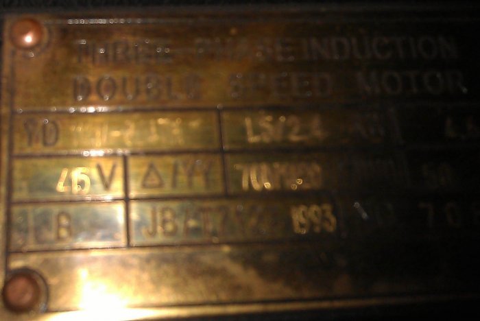

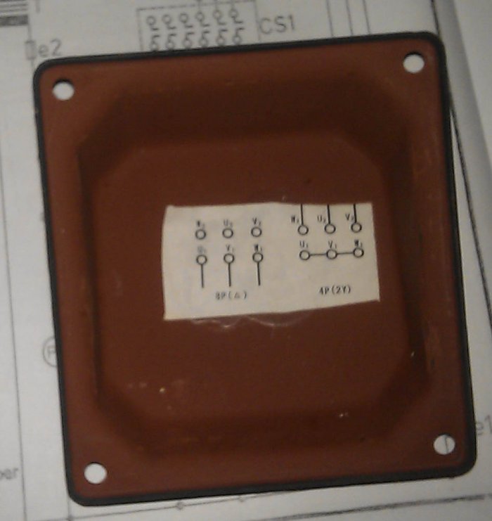

Only warning I'd give is beware of multi-speed motors

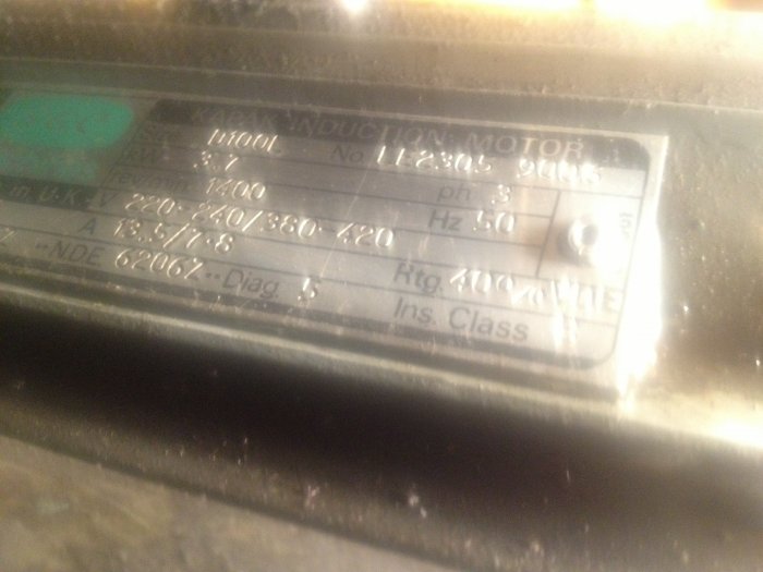

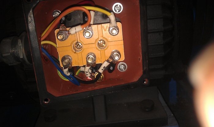

seems to me that replacing the motor with a 220v 3 phase and a 240 -220v inverter is the much cheaper option, or am I missing something?
Why would you go this way and have to buy a 240 volt 3 phase motor and inverter why not just buy a 240 volt motor?? I think I know the answer but I will await replies with interest
Realistically, a 3-phase motor with or without a VFD will be quieter, smoother and will give a better finish to the work - a good (non-Chinese!) DC motor can be better, but costs come out a touch higher once you factor in a decent DC controller. Single-phase motors are ok, I guess, for less critical uses, but no speed control, dynamic braking (a real bonus) etc.
A good addition would be an external braking resistor, so when you pick your VFD see whether it will take a simple resistor or needs a "brake unit" - they'd be a lot more expensive as they're VFD-specific (so manufacturer's prices, not generic Chinese £30 from eBay) and have a "brake chopper" built into the unit, not the VFD.
