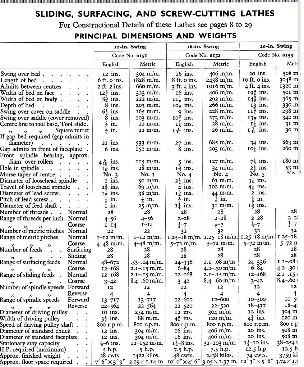

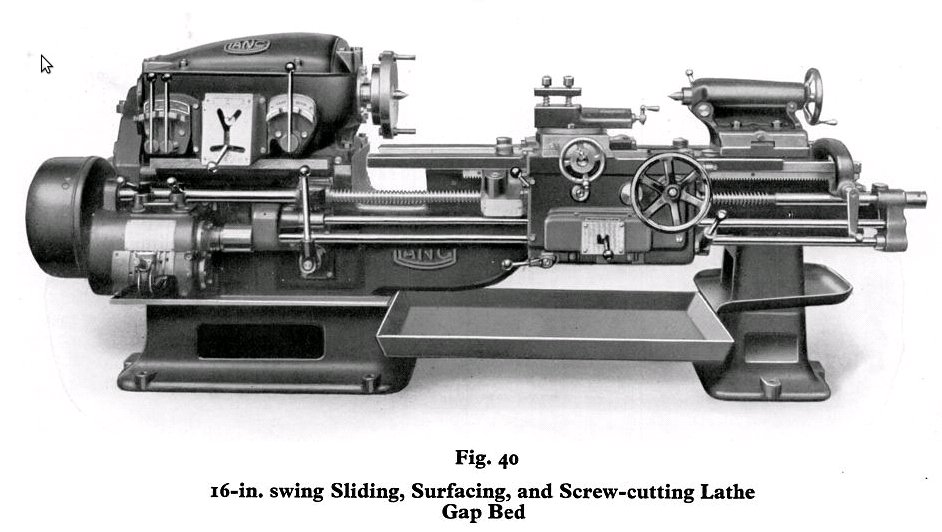

Even Lang Junior lathes weigh over a tonne; this isn't a Junior, it looks a lot like the 16".That lathe is never going to be 2 tons. 650-750 kg about 3/4 of a tonne.
It does look like it should have a gap piece but I wouldn't be surprised if it never had one. Its a very short bed with a very long throw, a specialist lathe in other words. It would probably make 350 - 450 on eBay so 150 - 250 would be a reasonable offer to a mate.
When/if you are picking it up, take everything you can. Any odd bits, clamps, vices, angle blocks, stock - everything.
