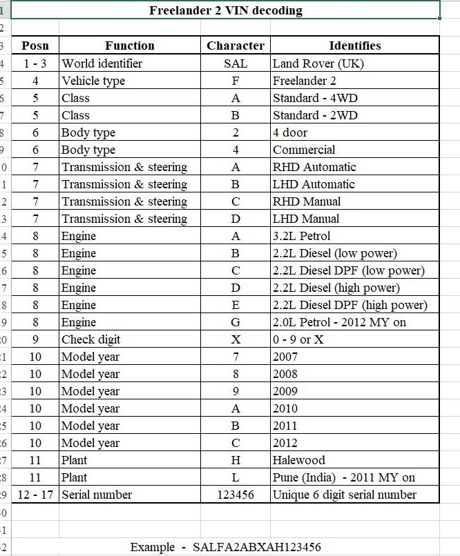

The 8th digit in the VIN will tell you if a DPF is fitted, i knocked up a decoding spreadsheet when I was looking for an FL2
You got one of them for a D2?![]()
