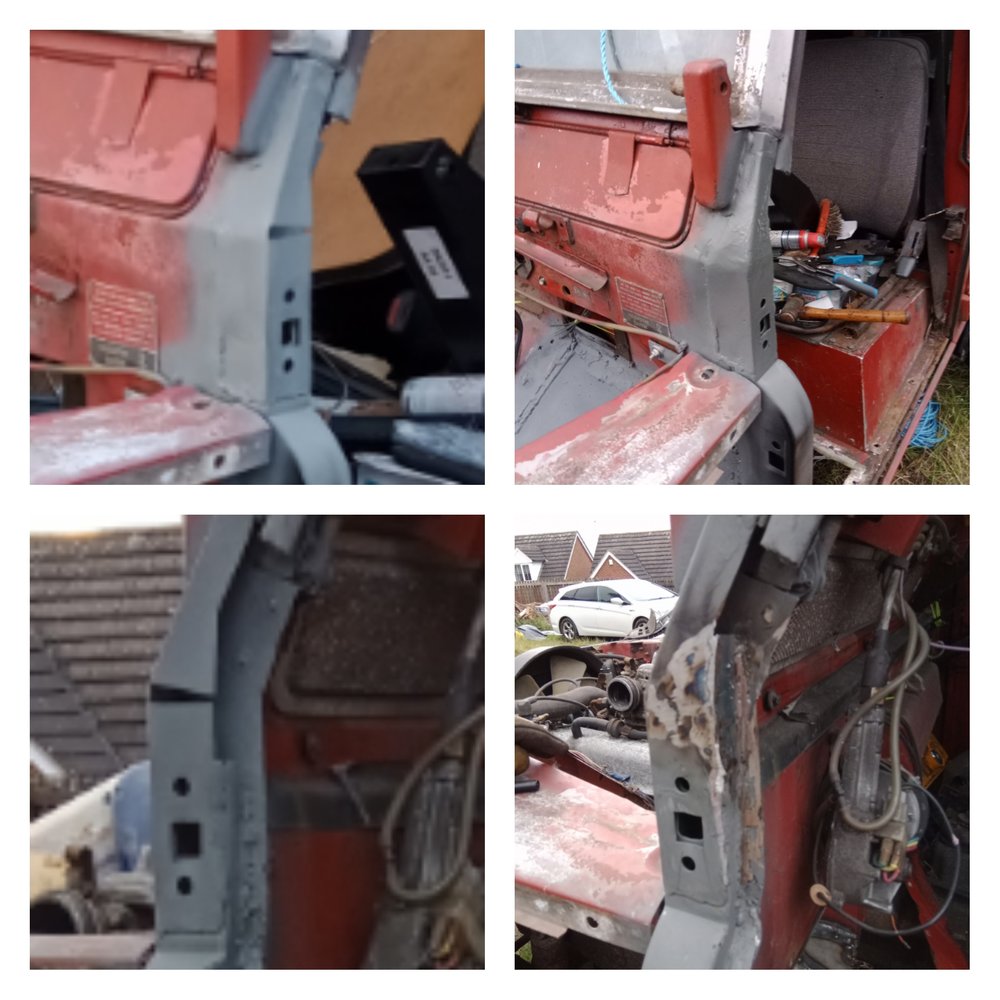

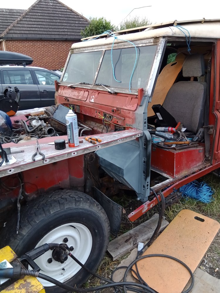

Ideally detach the windscreen from roof, but you might get away with probing with a BLUNT screwdriver or similar. Scraping the paint will not be good.
Problem with 10.5 pistons, is that its too high unless you have modern engine management to cope with it. You can alter the static timing to be about right, but the mechanical distributor advance weights are not really suitable.
Better off with 9.35 pistons and use a Range Rover distributor which works.
