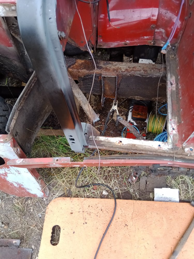

• Stripping out the original fitted sound insulation, and dash to get at the electrics revealed that I seriously underestimated how much welding was needed on the bulkhead.

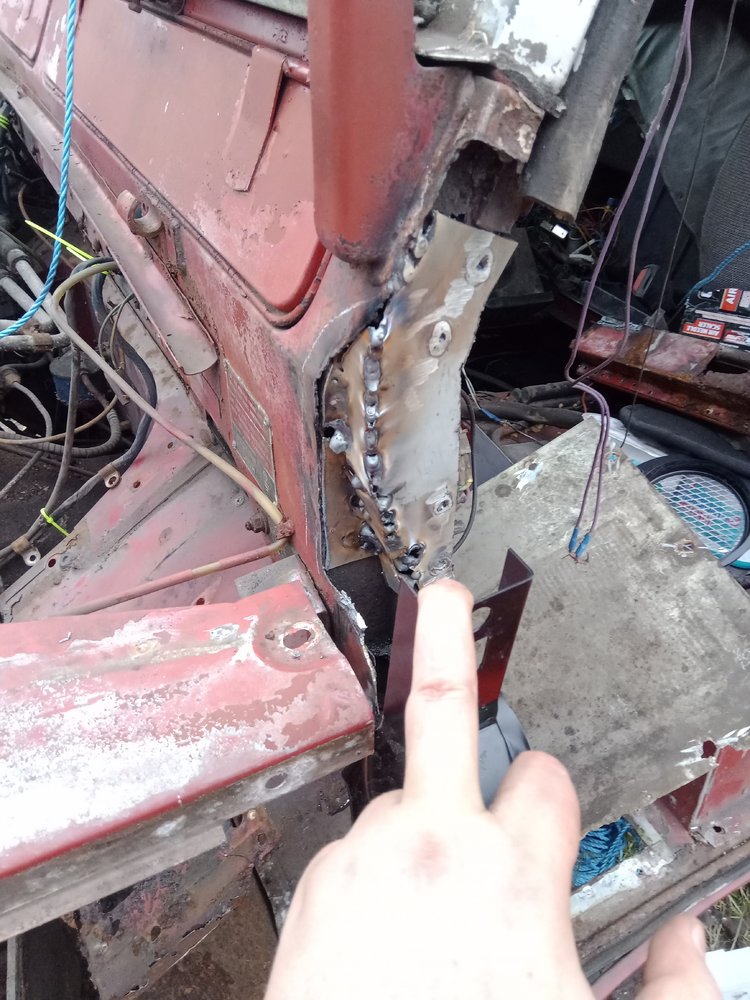

This is the "good" side that doesn't need as much work:
Excellent use of the time honoured technique of [checks notes] crudely tack welding a plate in with a stick welder and slathering it with seam seal from the wrong side so it forms a gigantic rust trap... Which has helpfully eaten away at critical stamped components.

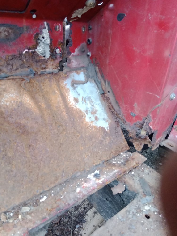

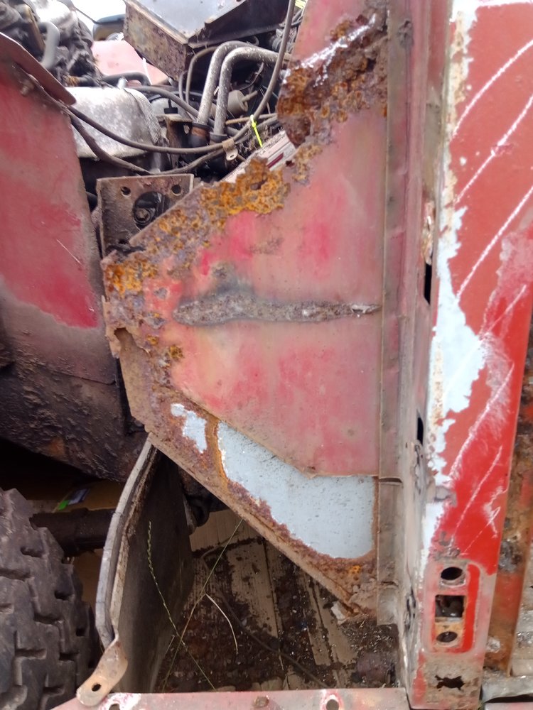

Less bad, but same deal.

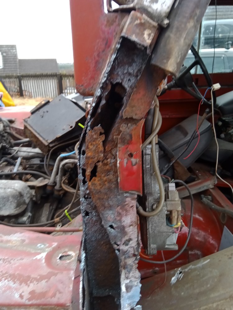

And the pièce de résistance, the a-post and bulkhead skin had rusted through at the weld...
Which had been ground back and packed with body filler, camouflaging it well, whilst also directing water down the inside rusting out more sections until it had all the structural rigidity of a jelly snake from the woolies pick-n-mix!
