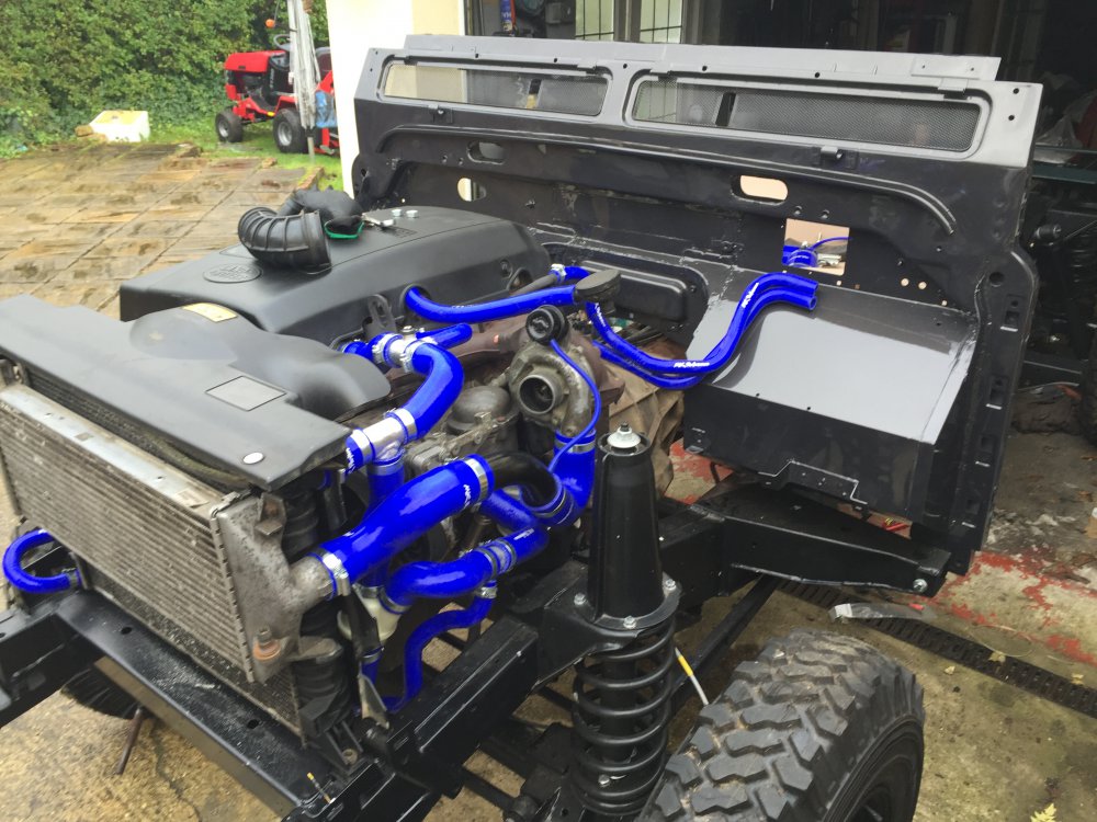

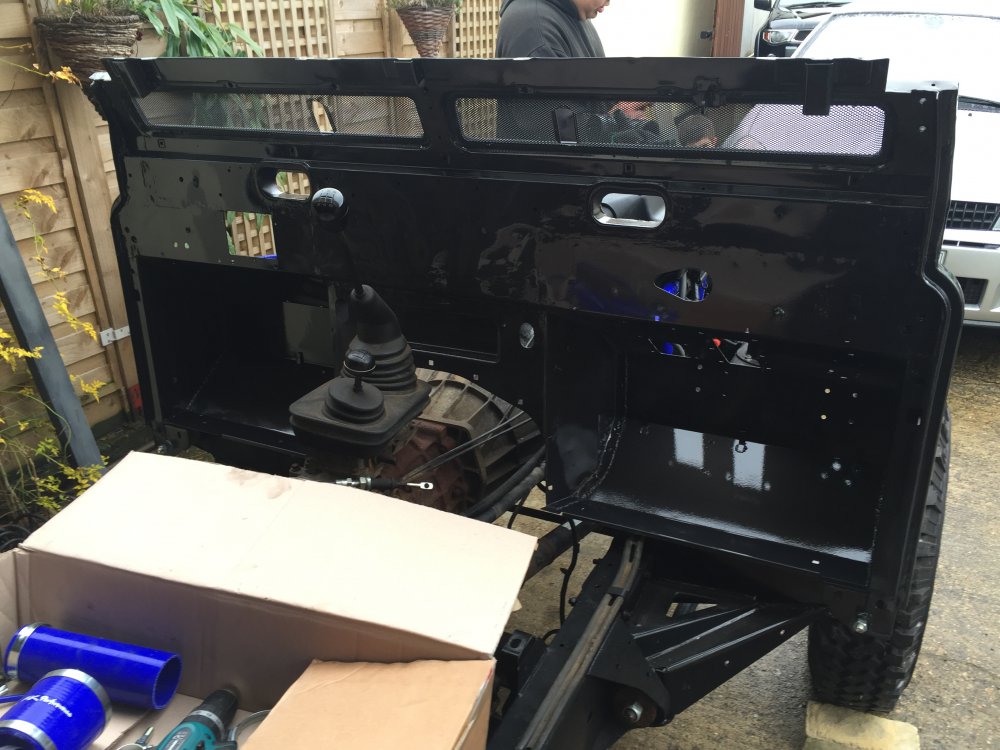

#Are you going to Waxoyl or whatever the hollow bits ?
Good stuff Kim, I bet it looks stunning. Wrap it up well as you install it - don't want any scratches.

Or dintrol.![]()
Yes I have a big compressor. No gun but can buy oneI have used both, but i prefer dintrol. I haven't done any long term or scientific testing though. Its Likely either will be fine. Do you have a compressor and shutz gun? If not they do dintrol in aerosols.

Yes I have a big compressor. No gun but can buy one![]()
) gun for £55 which I think is brill

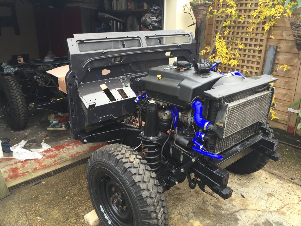

Ordered a load of that actuallyWhat sound deadening are you using?
I used to install lots of car audio and found Silent Coat very good for road noise
some were saying it's not so good on Lr forum then another guy was like if it can greatly reduce the noise on his 7l odd v8 then it'll be fine on Landy. The other stuff which is reflective was so much more expensive. I couldn't justify it.
