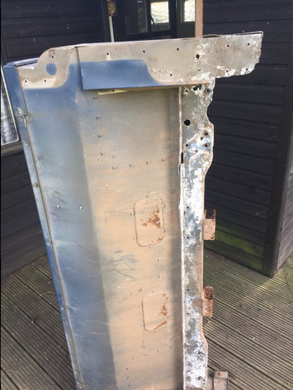

Also Im right in doing the sealer and filler before paint ?

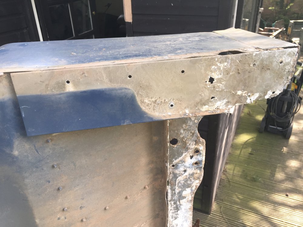

Brilliant I will do that. With the seat belt mounts that's rotted out can I bolt that in where it's been spot welded ? And I'll paint that at the same time seperatelyHi, yes rivets will be fine. If you paint it all before fitting on the steel cappings or fitting it to the chassis it will seriously cut down the electrolytic action that has done so much damage already.

Hi colinHi, if by the the seat belt mounts you mean the presently rusty lumps hanging on the bottom of the flange, then yes. As long as the part with the nut is the other side of the panel from where the belt bolt is, then how it's held in place doesn't matter. Are you buying the mounts or making them from a nut (7/16" UNF) welded to a steel plate?
