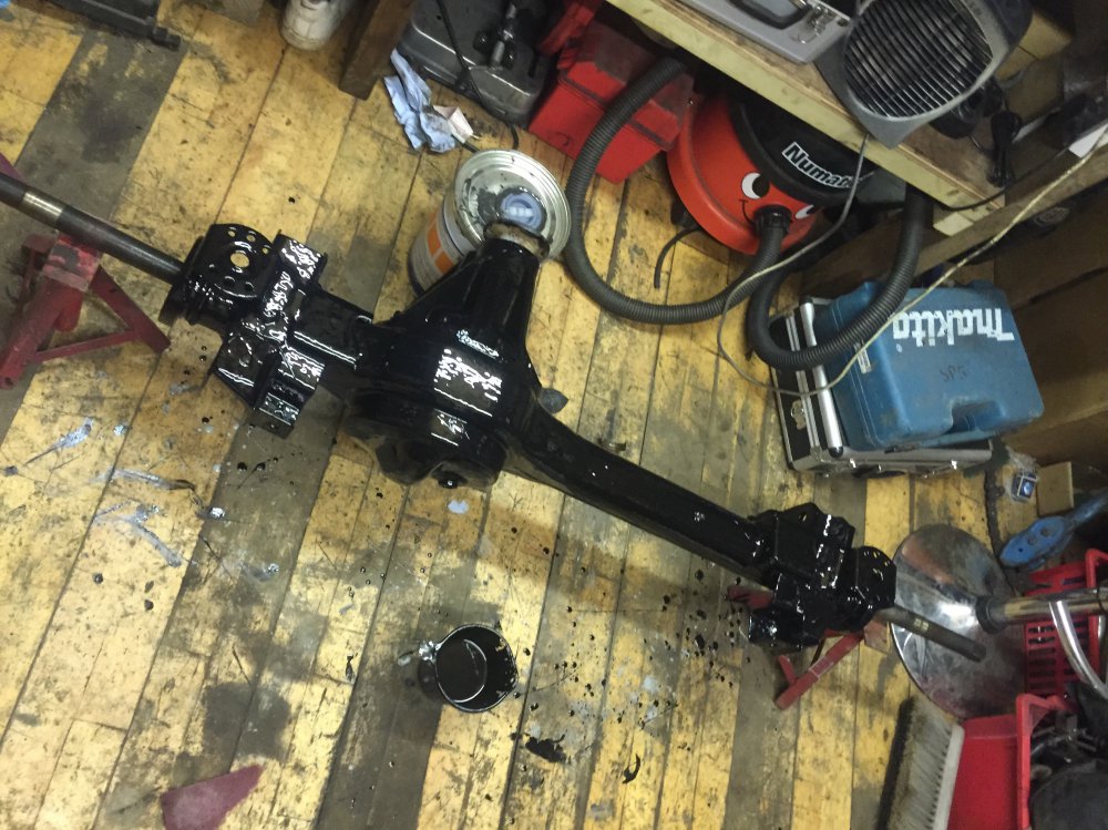

then after sorting that I realised it leaked really badly, turns out the oil seal pinched and snapped
wanted to leave at 6am this morning but didn't do that! Anyway left at 1 today not long got back and we have a brand new chassis

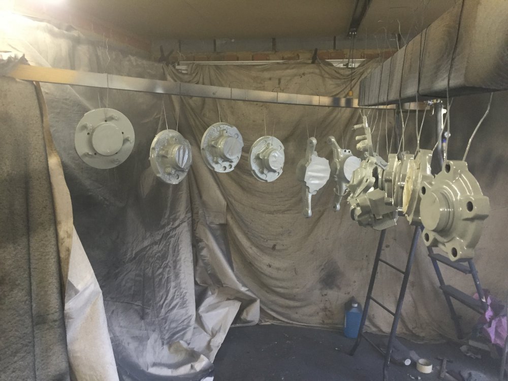

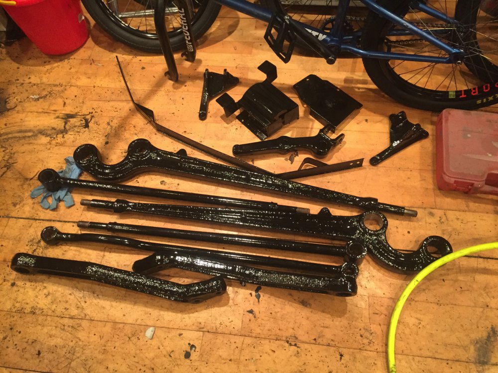

Well thanksHi! Just started reading this thread and you have done a great job so far! Just going back a little can you tell me where you bought your paint? and what you bought? I looks like good stuff, i've read about jotun before but have never seen it used.
Also there is a very good website www.landroverworkshop.com which I use all the time, if you go to the diagrams section at the top of page it will give you every part on a landrover; then compares prices of all the main sellers in the uk. You can get some massive price differences, and the diagrams are very useful to.
Cheers steve........

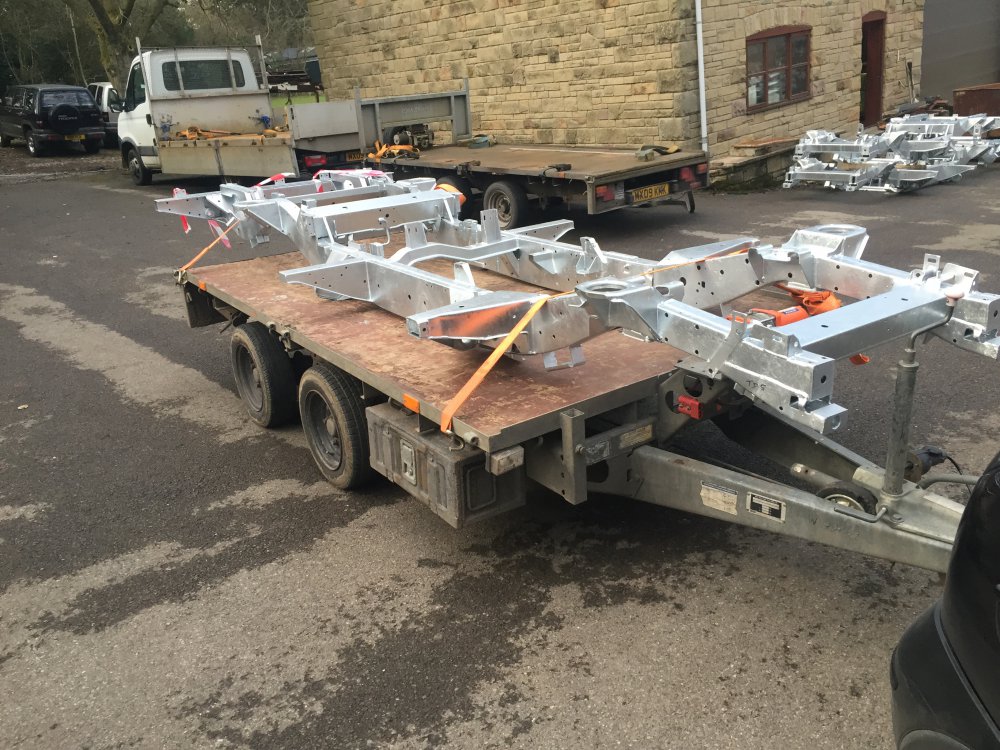

I would always suggest that galvanised chassis are best painted.
Not simply for additional corrosion protection, but so that they don't stand out to the scum who walk round who's little brain goes 'ere, that landy got shiny chassis, worth nicking that'.
I understand people use something to prepare the galvanised surface prior to pain, perhaps the Mordant solution Kim mentions.
500ml of primer everywhere! I was not even remotely amused.
not seen him for 6weeks and deserve a break I think!
Mordant solution is meant to turn it black so I'll show the process when I do it maybe tomorrow.I'm not too clear on it myself. I've read plenty of posts on it as I've got a serious mental health issue (I like series landies) but as I've not yet gathered the motivation to start rebuilding mine it hasn't been too important to me so I've not studied it or had much reason to remember.
I think that the galv has to weather a bit or the paint won't get on with it - flake, bubble etc.
I think that treating it with Mordant solution is quicker and possibly better than leaving it out in the weather for a few months to alter.
People clean them, treat them, rub them down and so on to do a good job.

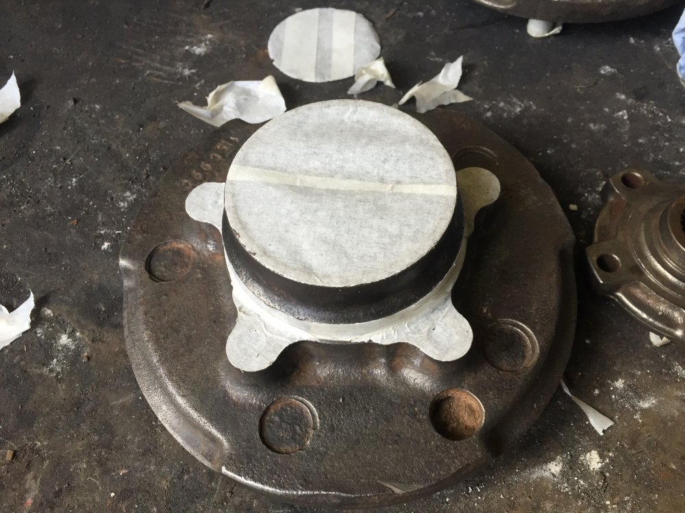

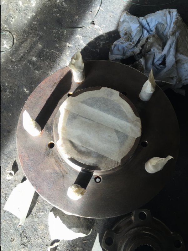

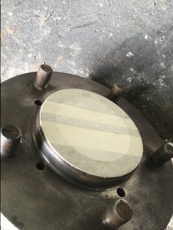

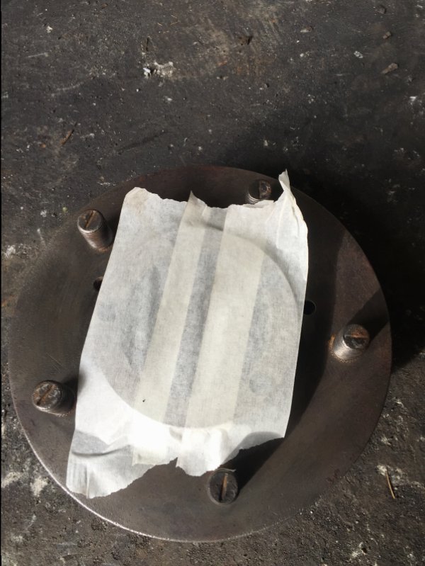

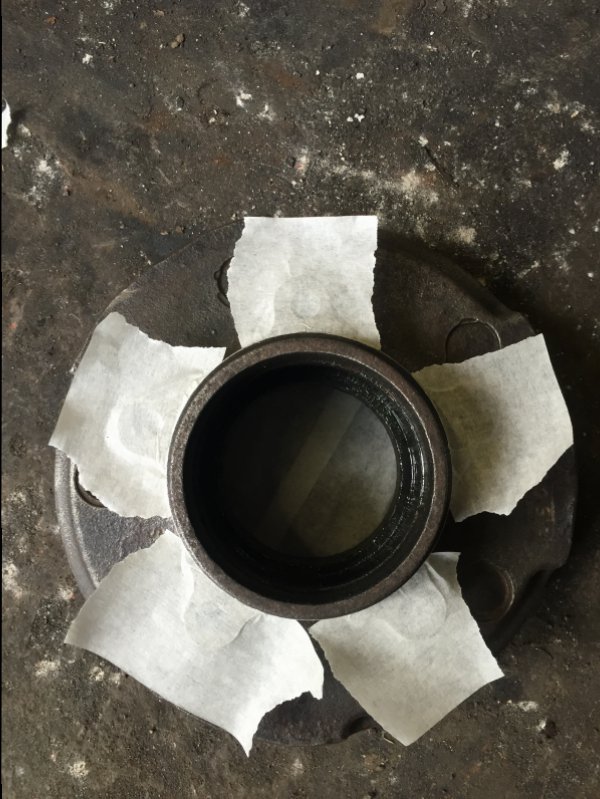

I did that as well but preferred the knife most of the time.Kim, you probably know this already, but instead of using a knife to trim that masking tape, you can gently tap it with a hammer along the machined edge and it gets cut very neatly. Those bits where the hammer head won''t reach you use a knife on. Same method for making gaskets.
A small ball pein hammer is best. The ball can be pressed into holes and rotated to make a cut.
hammer is equally as good though
