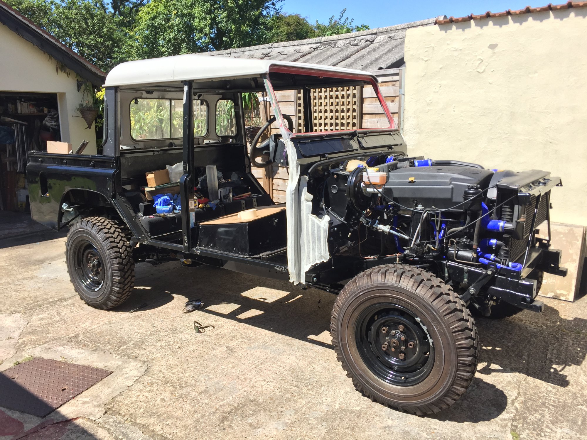

Get the rest of the body work, trim and fluids in and he will sit a bit lower.As I said. Id do some on Lou. Swapped the B posts firstly. That was so easy with new posts. They literally went straight on. So glad I bought new. Now I need to send these old ones back!
Then I found out my brother was here so we put the roof and windscreen mount on
I'm so pleased

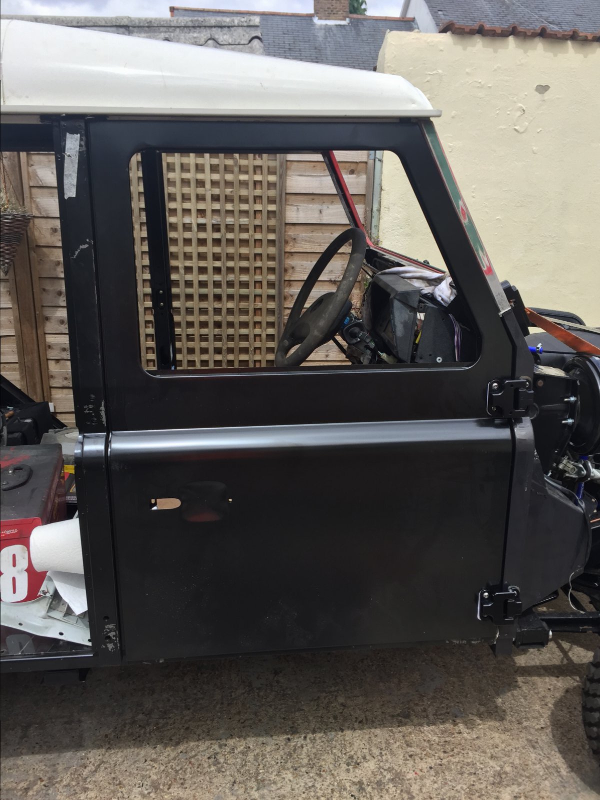

I'll fit the doors at the weekend then I can strip it all down for galvanising.

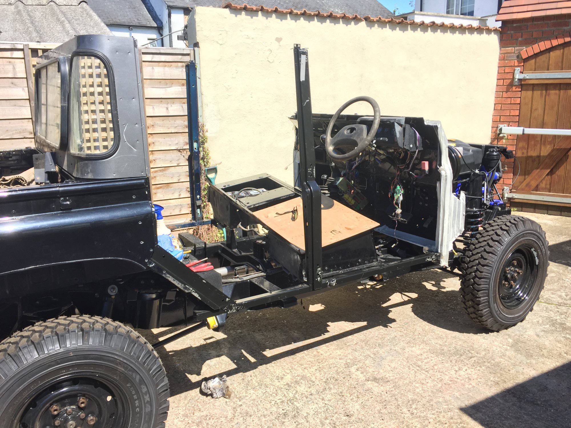

I'm also going to weld the b posts a bit better. They only have three spot welds on either side and bend so easily!

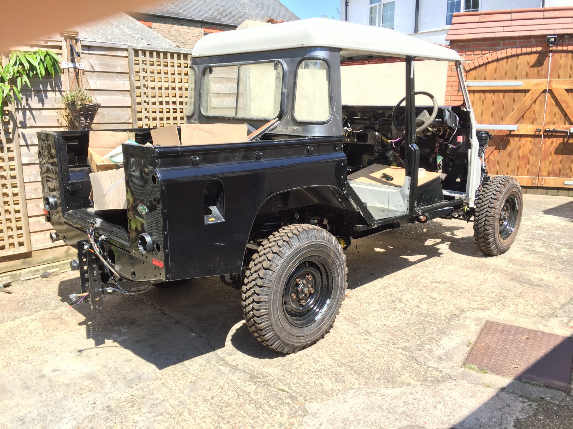

It was a major pain getting it in the garage. Had to let the tyres almost all the way down. They should be fine to the weekend I hope haha.
? There's no arches on, they make it look much to high.Get the rest of the body work, trim and fluids in and he will sit a bit lower.

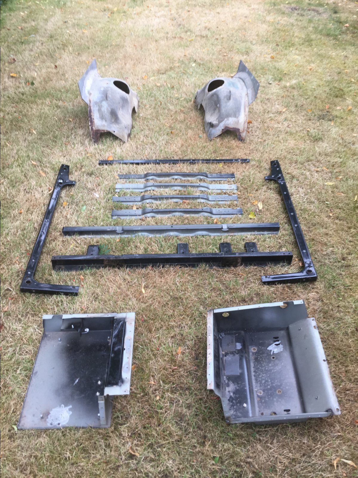

So do I, I did the pics like that so I could see al the parts.The way those bits are laid out reminds me of the way forensic archeologists lay out a skeleton for diagnosis
I hope that your stripper and galvaniser don't loose any bits as I expect that they'd be a b****r to replace.
