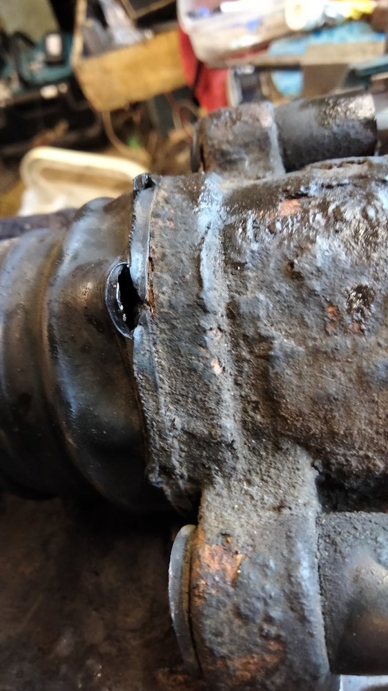

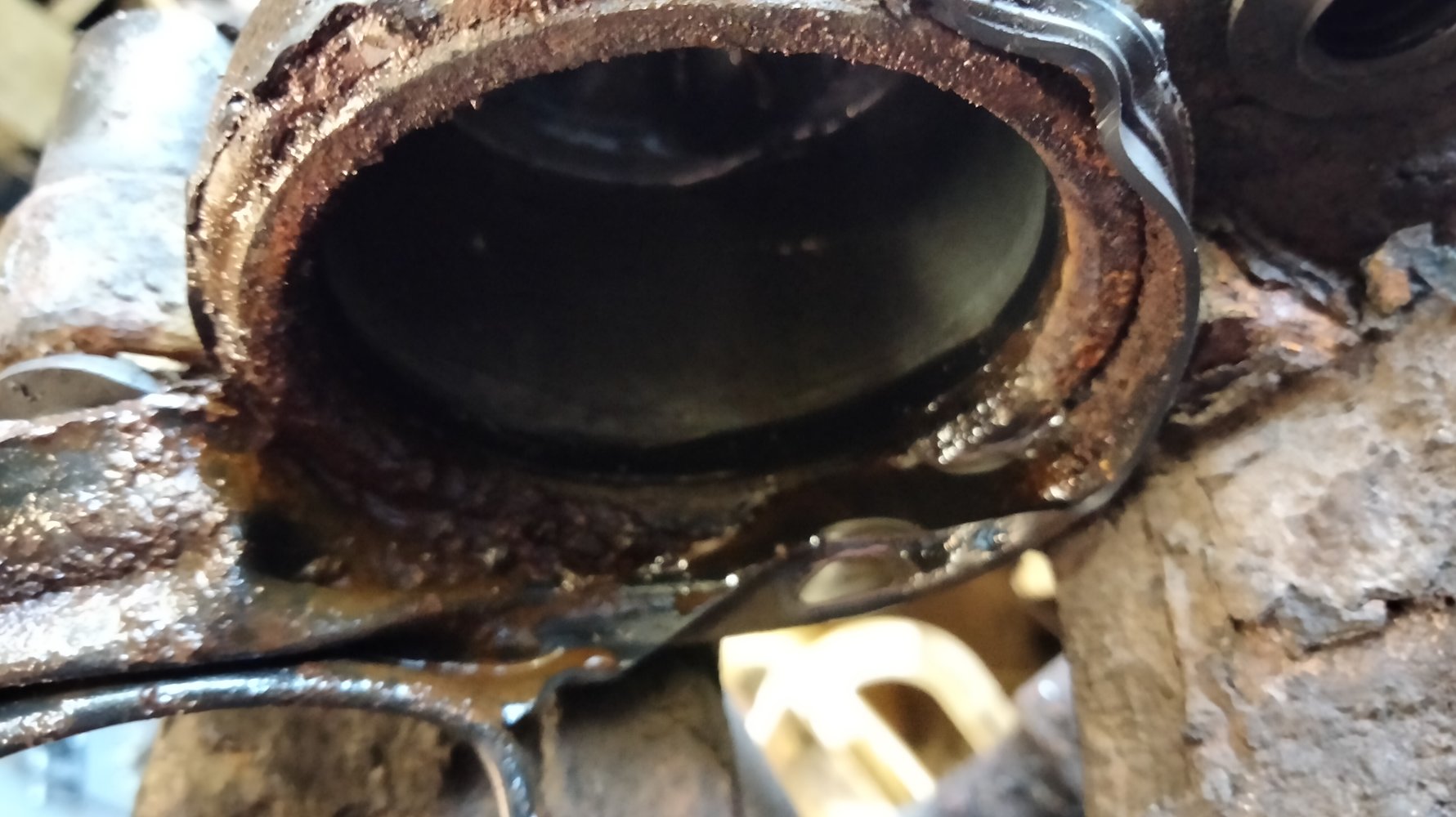

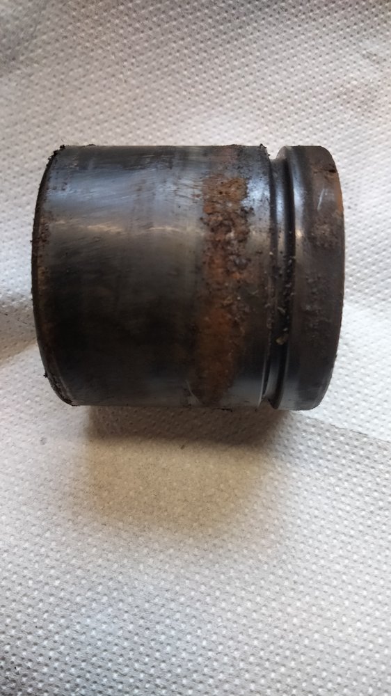

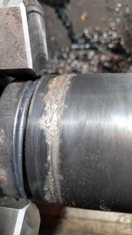

View attachment 383837View attachment 383838View attachment 383840View attachment 383839
Front Offside is a classic rust due to a knackered gaiter. I'm almost pleased that's all it is. Was solid when jacked up and wheel hard to turn. Piston pitted so it's to the bin. Either repair kit or replace caliper(s) next. Rear nearside still to be investigated. That one's <2yrs old,
That was my immediate opinion also...But it cleaned up remarkable well. Ordered a kit 1st class post includes new piston as well as seals. Royal Mail????Exchange calipers - forget about repair kits - it would be "gods own work" to reseat boots in that rusty dead core I am looking at in the photos.
