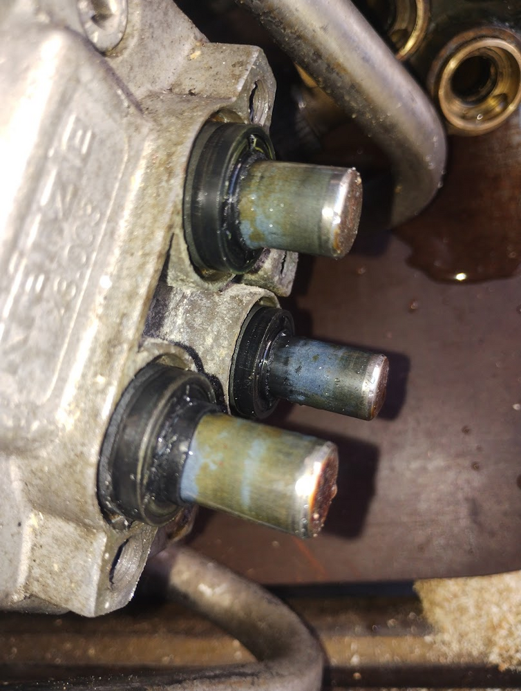

The kranzle pistons have a thin ceramic coating that is in the wear zone so will definitely not look like a chrome finishTry polishing them with metal polish to see if the hard chrome is still there
The pistons are discoloured, but i can neither see nor feel any other defects on them at all -
Discoloured isn’t a problem, if they were damaged you would see or feel it.
