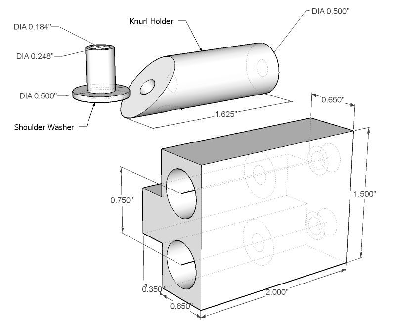

    I read an article in a magazine recently about making your own "cut knurling" tool. I'll see if I can dig it out and will post a reference to it.
    Kram likes this.
  13. Dr.Al
    Dr.Al Forum Supporter
    Messages:
    784
    Location:
    Gloucestershire, UK
    Kram likes this.
