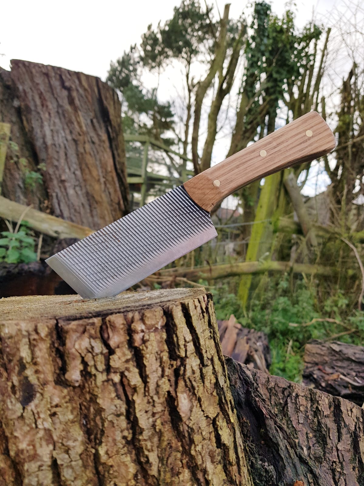

Iv been meaning to pull my finger out and make a knife for a while
do you just cut with a grinder and shape with a flap disc then sharpen on the belt sander?
also how do the brass pins work?

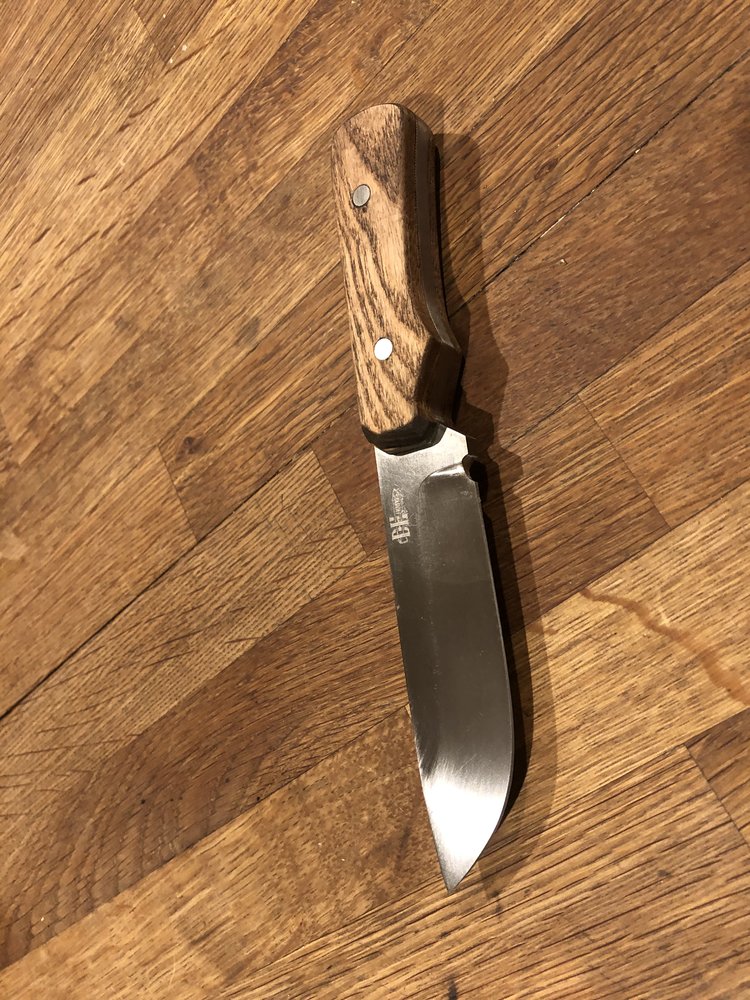

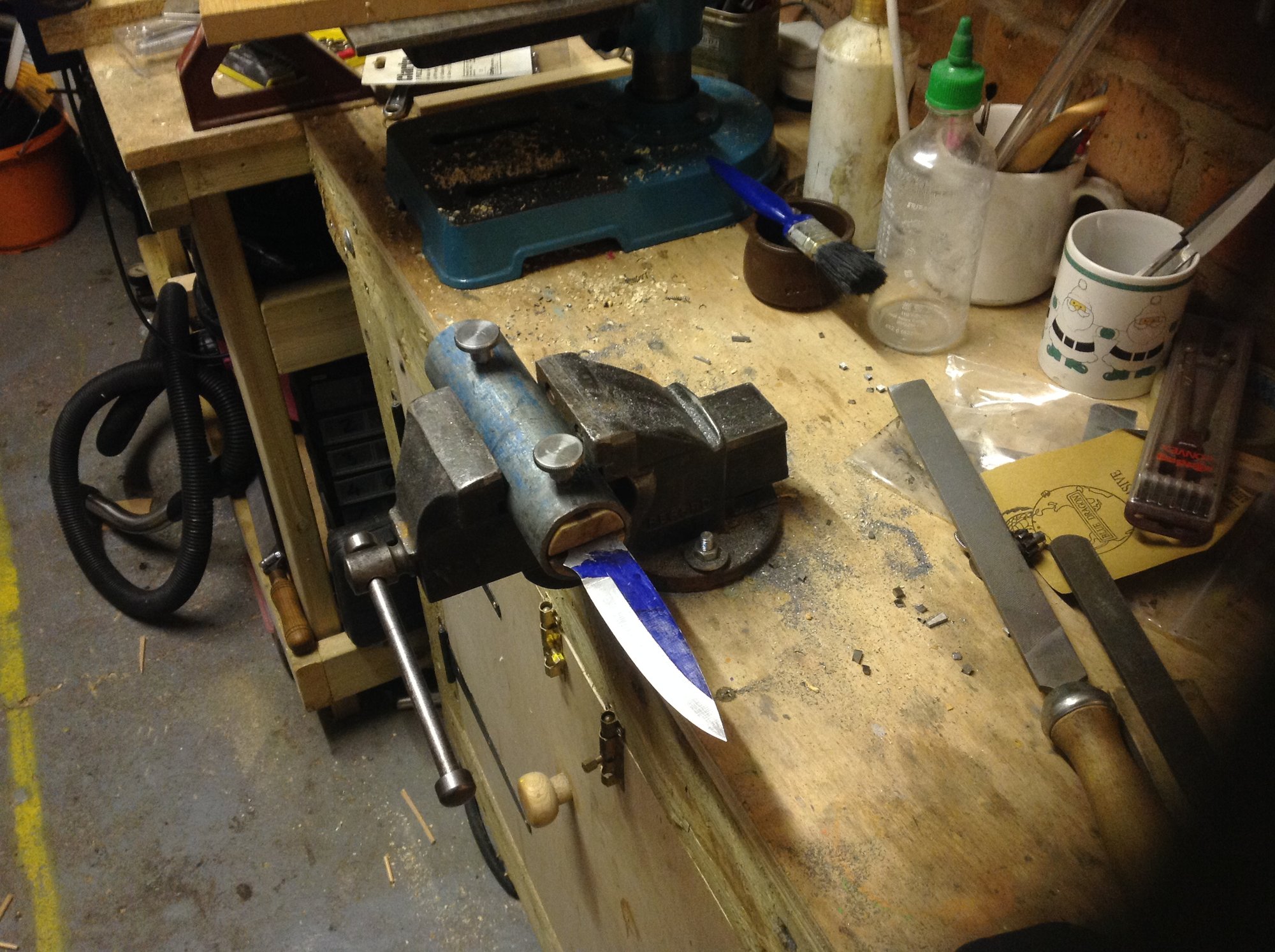

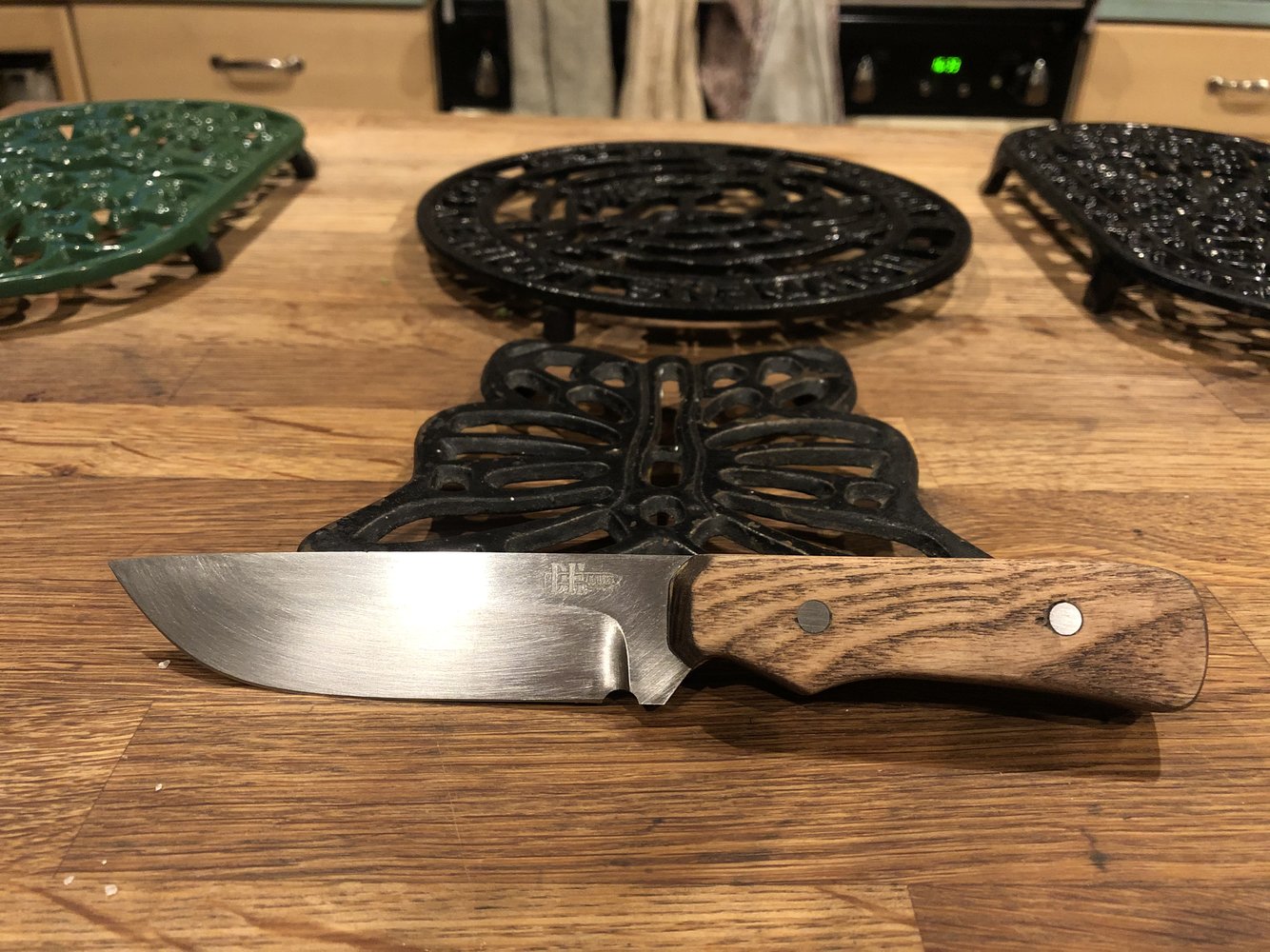

Basically, yes - my first knives were cut with the angry grinder, then shaped AND sharpened on a Bosch pbs60 belt sander, held in the vise.
Bit of hardwood pallet wood for handles, held on with poundshop poxy and a couple of copper nails with the heads cut off.
The brass pins are just dowels that strengthen the Pixy resin which is what actually holds the scales on.
I'm not even sure if they are needed, really, for small knives, but it's traditional.
