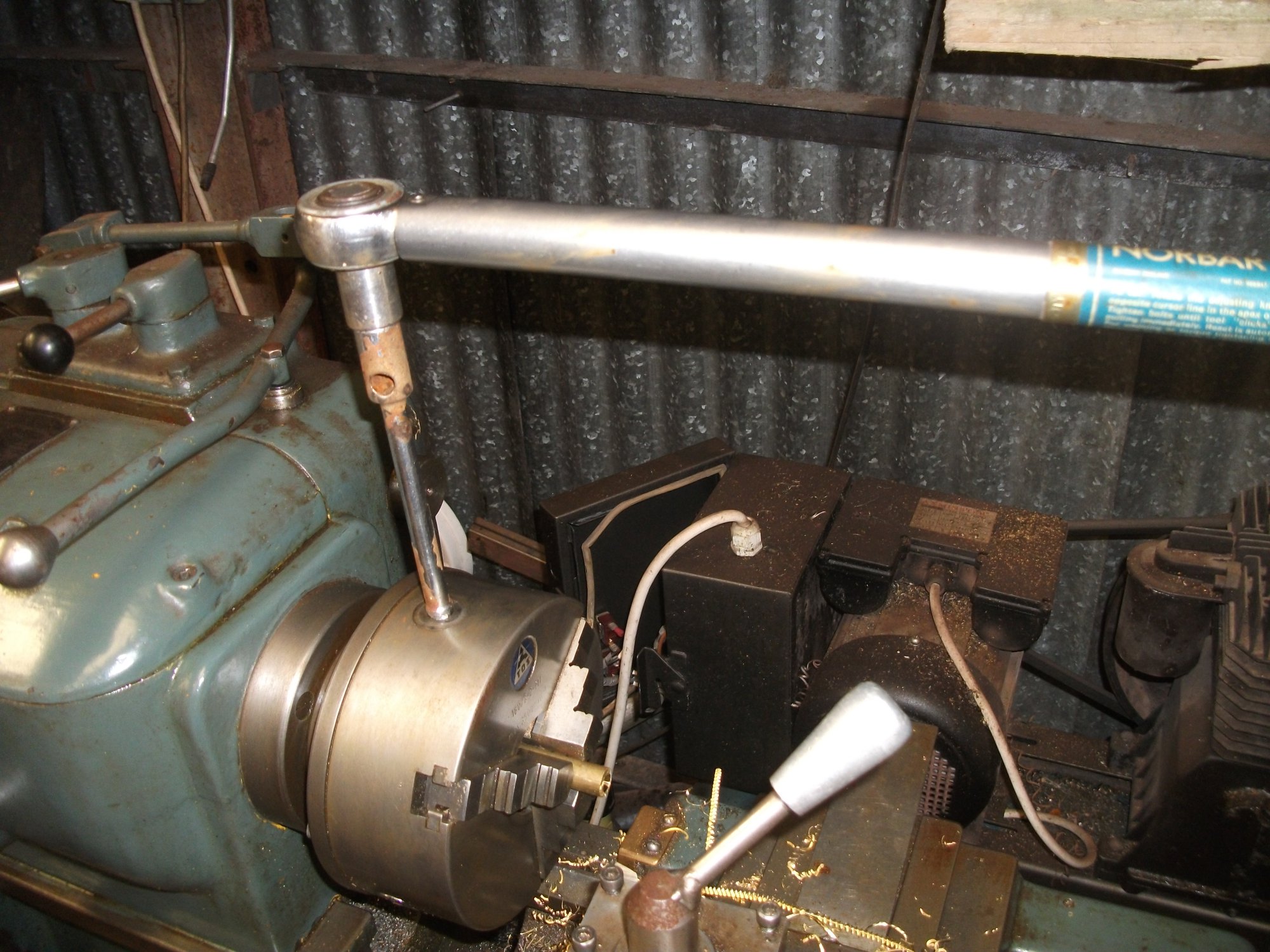

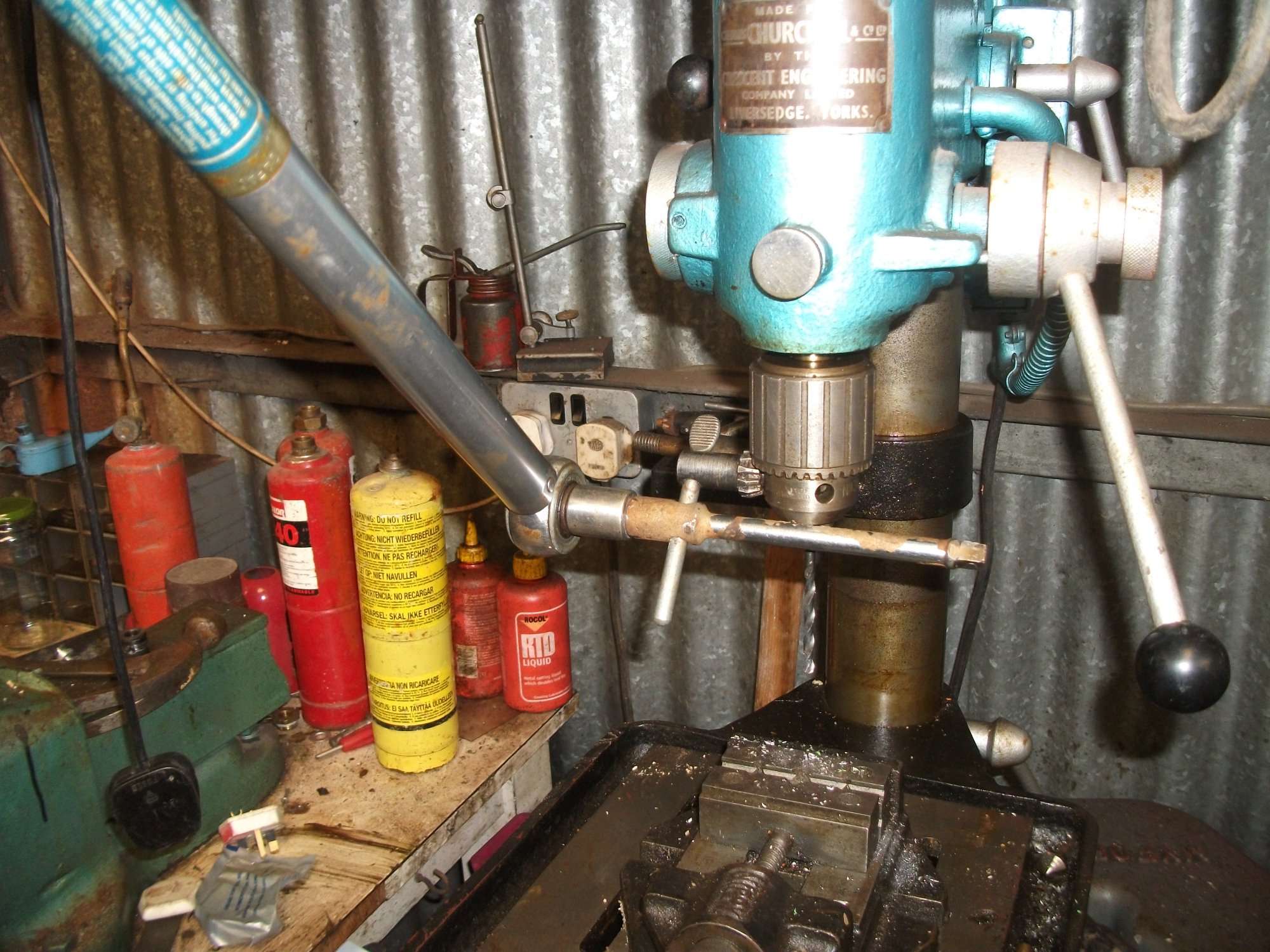

test on tightening chucks up . a Jacobs chuck on the drill I put the torque wrench on 1st hole and tightened a drill up till the click stop activated .went to the second one and it further tightened till click stop the 3rd also tightened till click stop went back to 1st and just a click . the 3 jaw scroll chuck on lathe. tightened the 1st till click stop the second hole turned then click stop but the 3rd just clicked and was tightened enough . well better go do something more constructive
