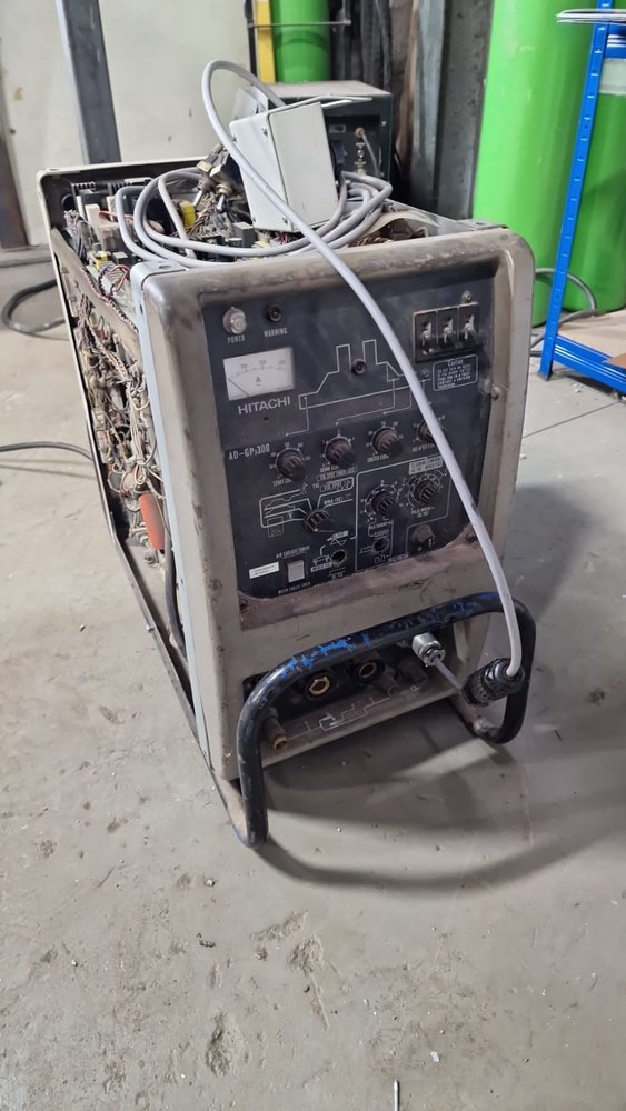

To be honest, it's a mode I've never tried so I made an assumption about the snap-out. I'll try it and see how it behaves. As you say, it is odd, but I couldn't figure out how they would do this from a single button.Weird having to snap out, on the Parweld you just hold the button down for a second or so and the down slope starts, release again when at end current and the arc extinguishes. That is all from one button.
