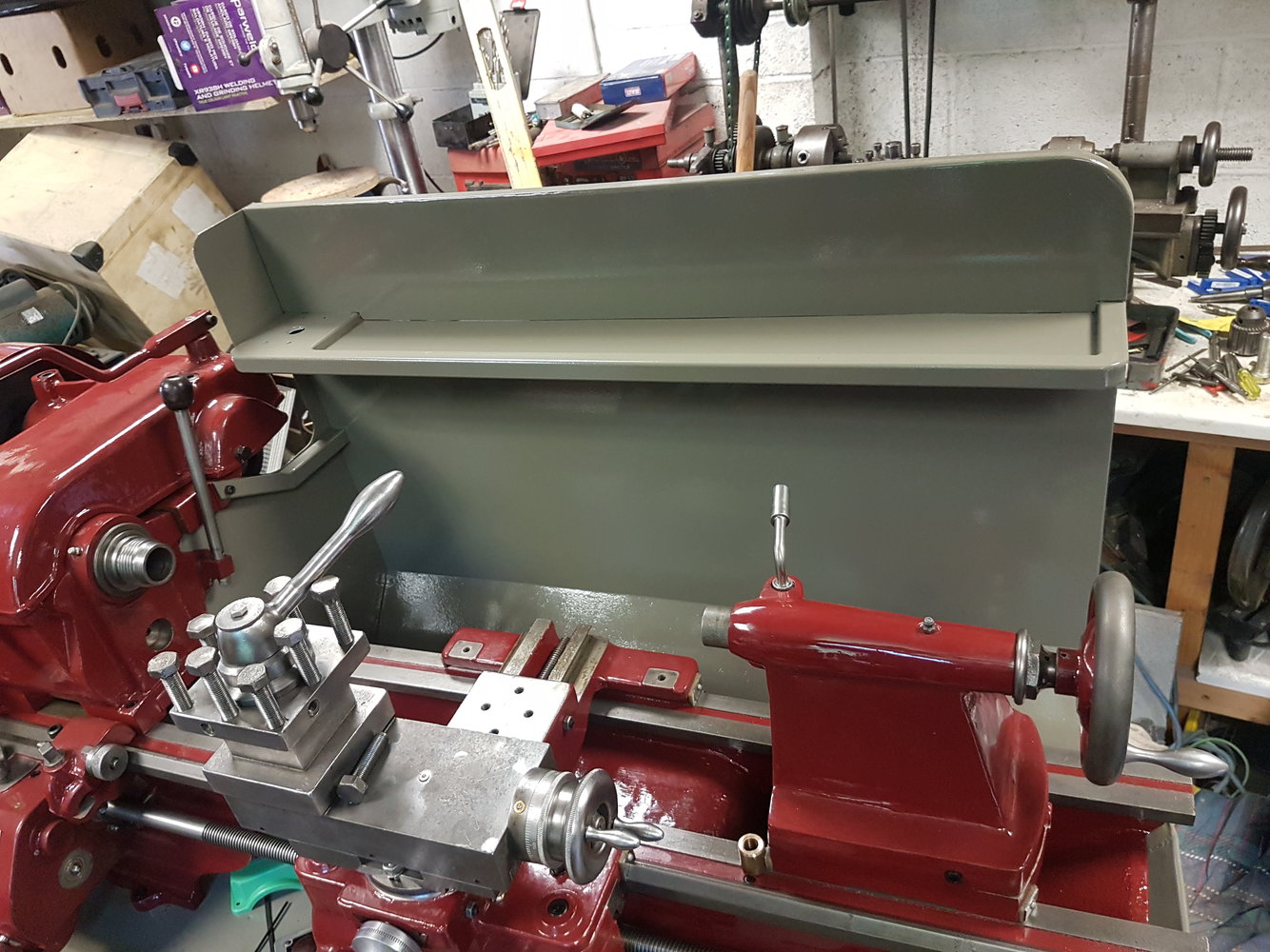

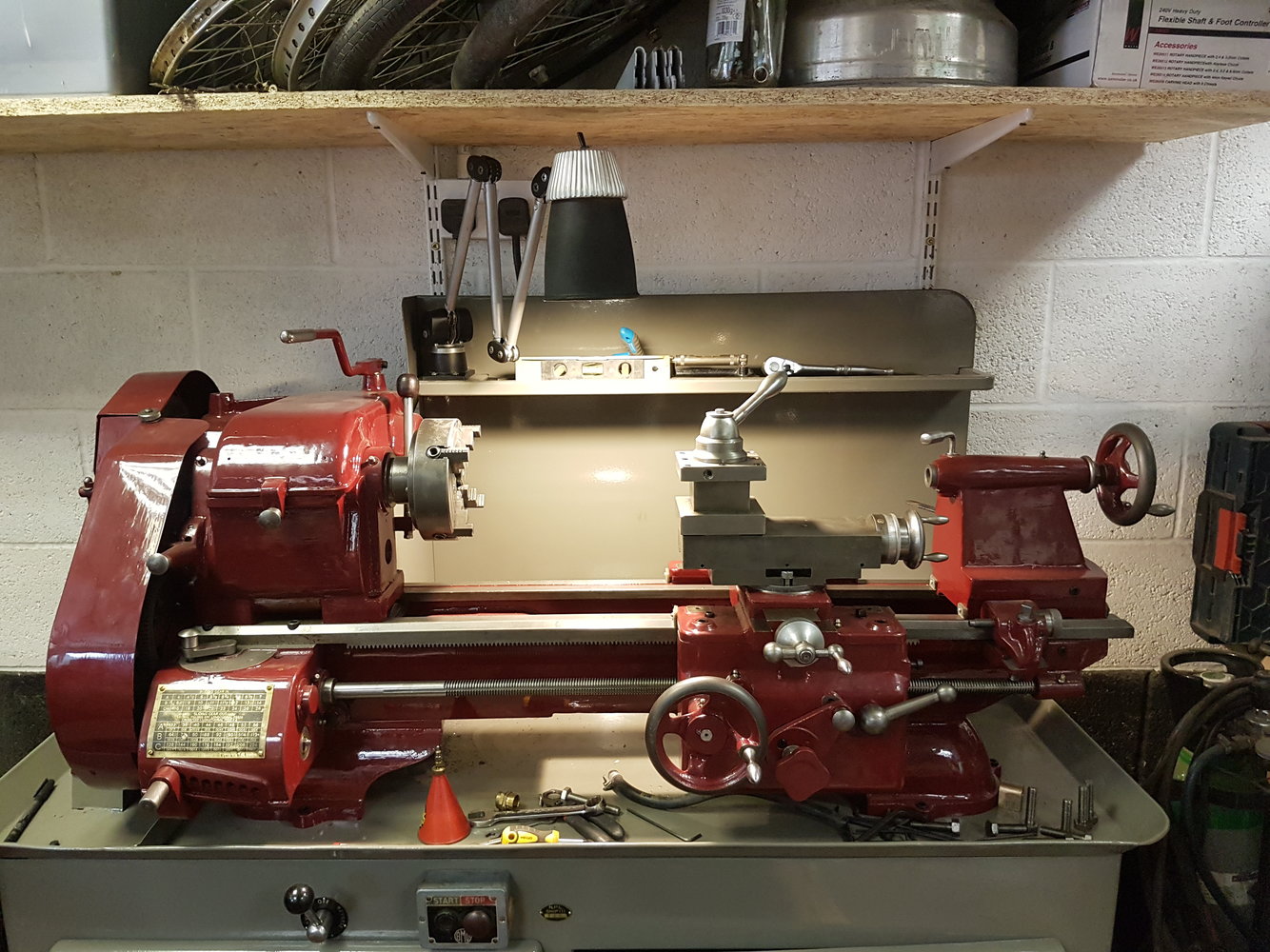

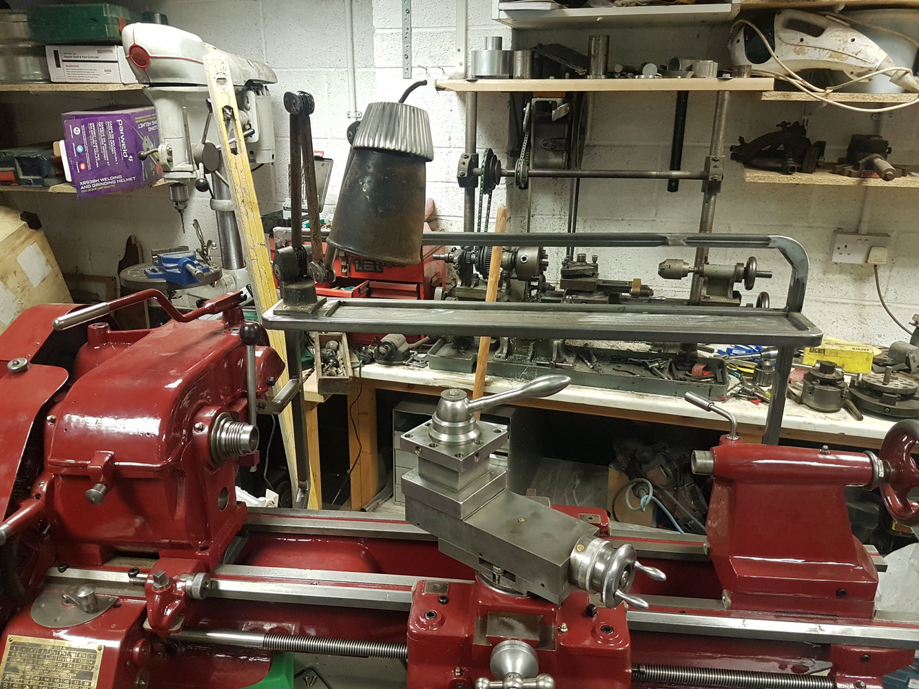

Got the frame and shelf for the splash guard made.
I slit the inner face of the shelf tubing and put the sheet steel in the slit. Nice and neat, and gives a lip so stuff won't fall off. I'll probably put some holes in the shelf to put tail stock chucks etc it.
Bolted the lamp on to see how it looks. The lamp section of shelf is capped top and bottom so the wiring will run inside the shelf and out the back.
Just need to panel it up now.
