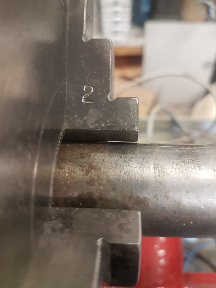

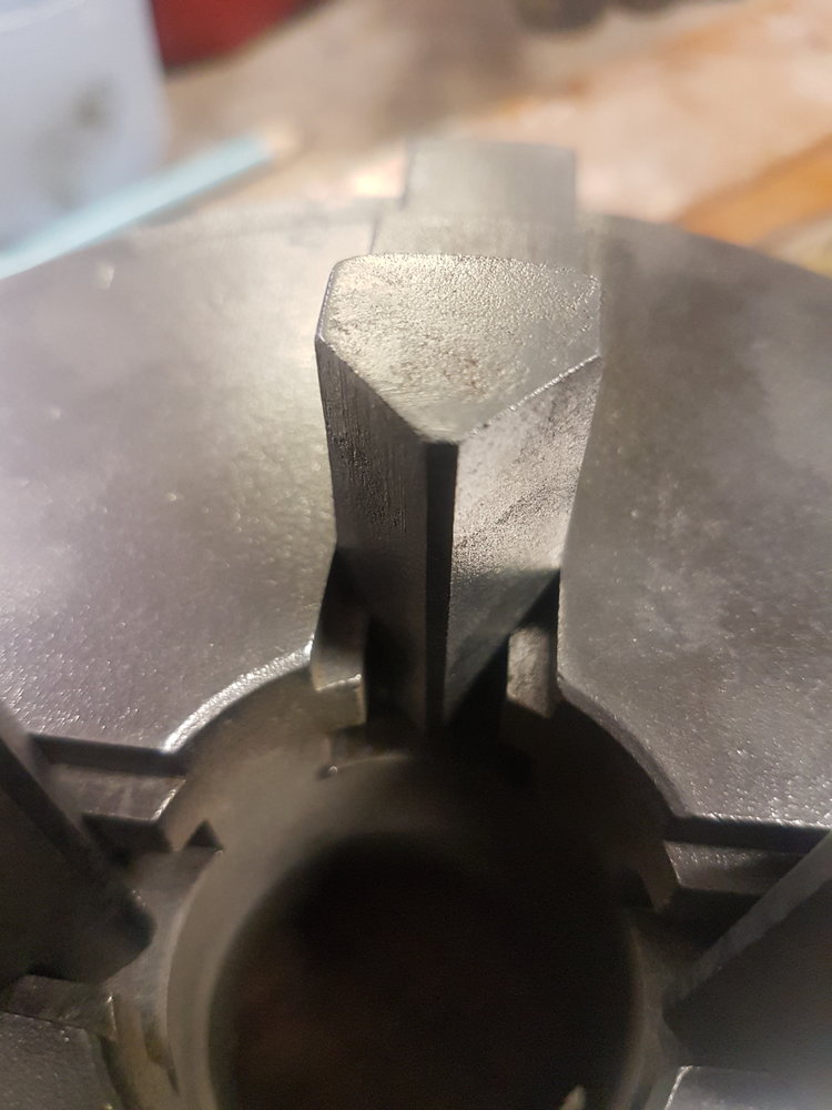

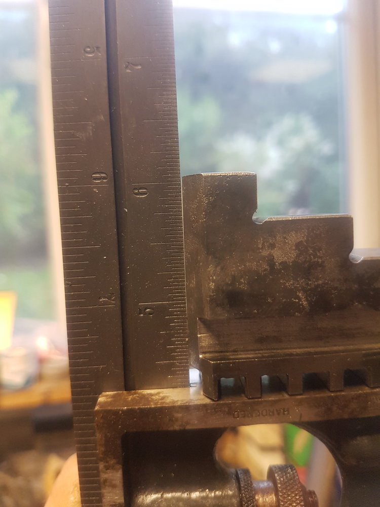

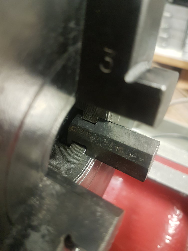

Looks like the chuck is bell-mouthed.
As said above by pete. Chuck bell-mouthed. Jaws normally wear towards the back

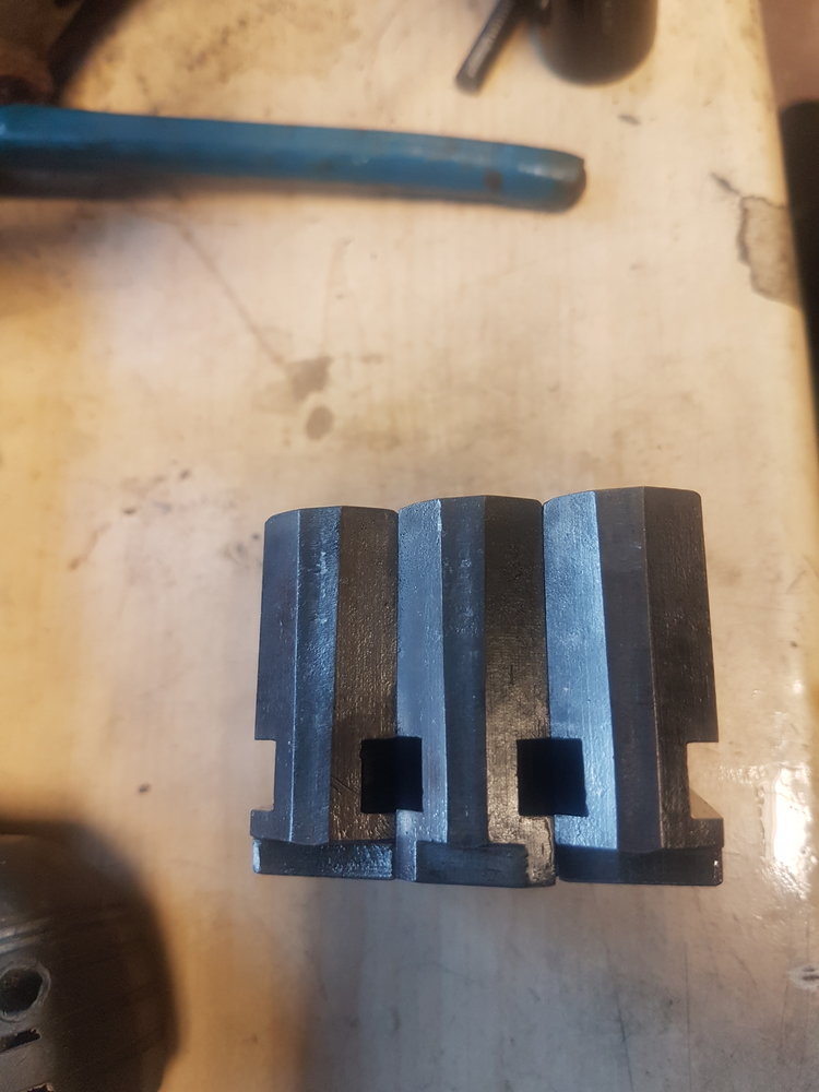

No it's not worn, the chuck has been clamped down tight on a part held only on the end of the jaws and it's bent the guides for the jaws. There is no way in hell anyone is going to bend steel jaws with a thin cast iron chuck face, it's the iron that gives. I had a chuck that was exactly like this. I took the 'bent' jaws and put them in another Pratt chuck, and it was perfect.
They have indeed been re-ground. Badly.

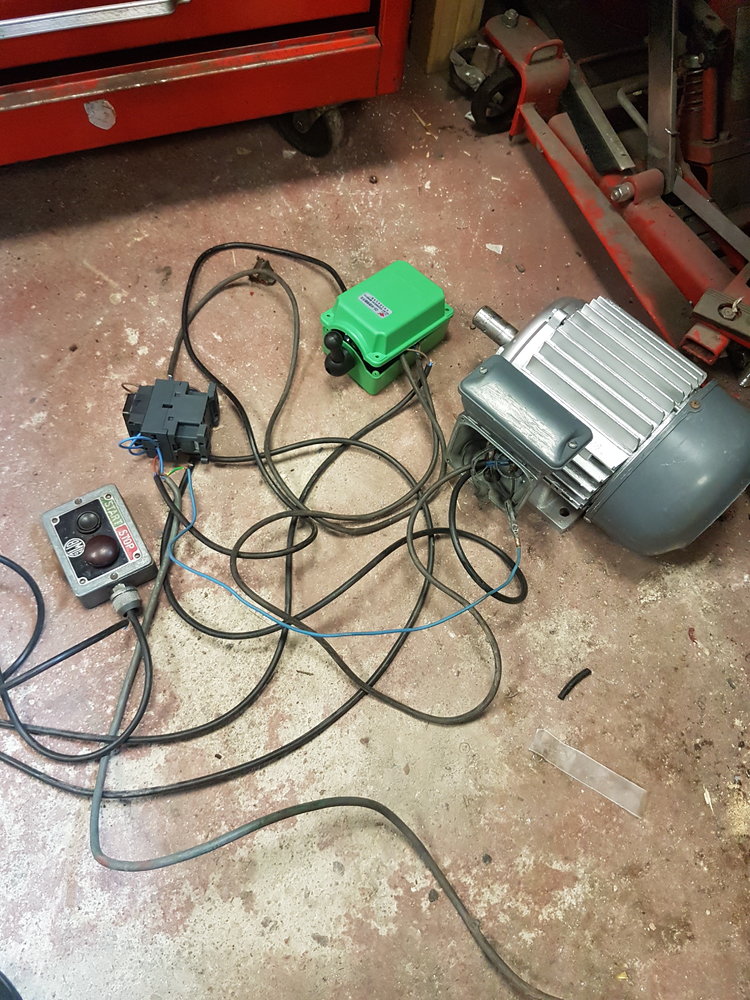

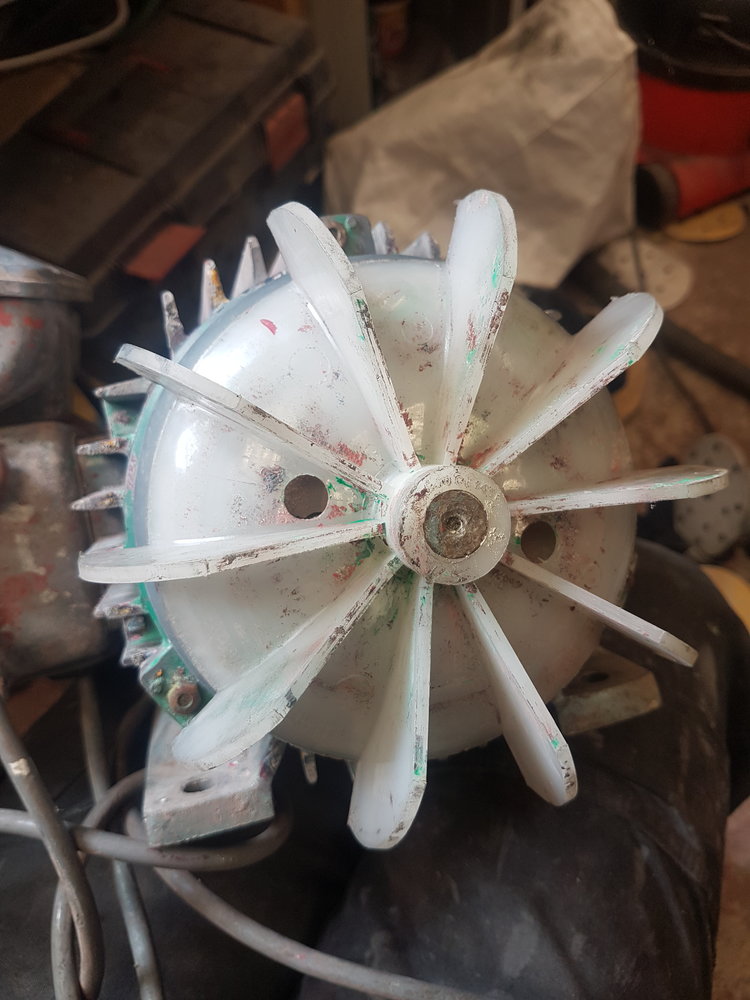

Those fans usually come off very easily. I normally use a couple of flat wrecking bars, with care.Would really like to get this fan off so I can get at, and inspect, the bearings in this motor.
I assume it needs a 2 leg puller though, which I don't have.
If you do break one it might be worth knowing they are cheap enough to buy on AliXpress. Most of the sizes are available, but the search system doesn't help.This one needed alot of pulling!
Fan wpuld ha e broken before it moved. Interestingly, the splined shaft it mounts on was covered in factory grey paint. Might be why it was so tight.

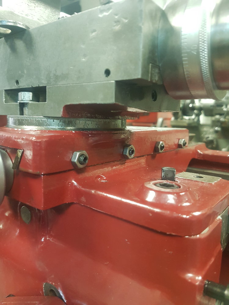

Nice job.Ignoring chuck jaw issues, the grub screws and nuts for the cross slide gib turned up today. Cut the grub screws down and pointed them to match the 2 originals that were remaining. Replaced all 4 though.
This site pleases me more than it should. Something about the red, with oil blacked hardware and silver nuts.
A new feed nut is on its way too. I'll have to make a holder for it, but that should sort 95% of the wear in the cross slide.
Now I can adjust the gib I can tell there is very little wear in the cross slide ways either.
Nice job.
