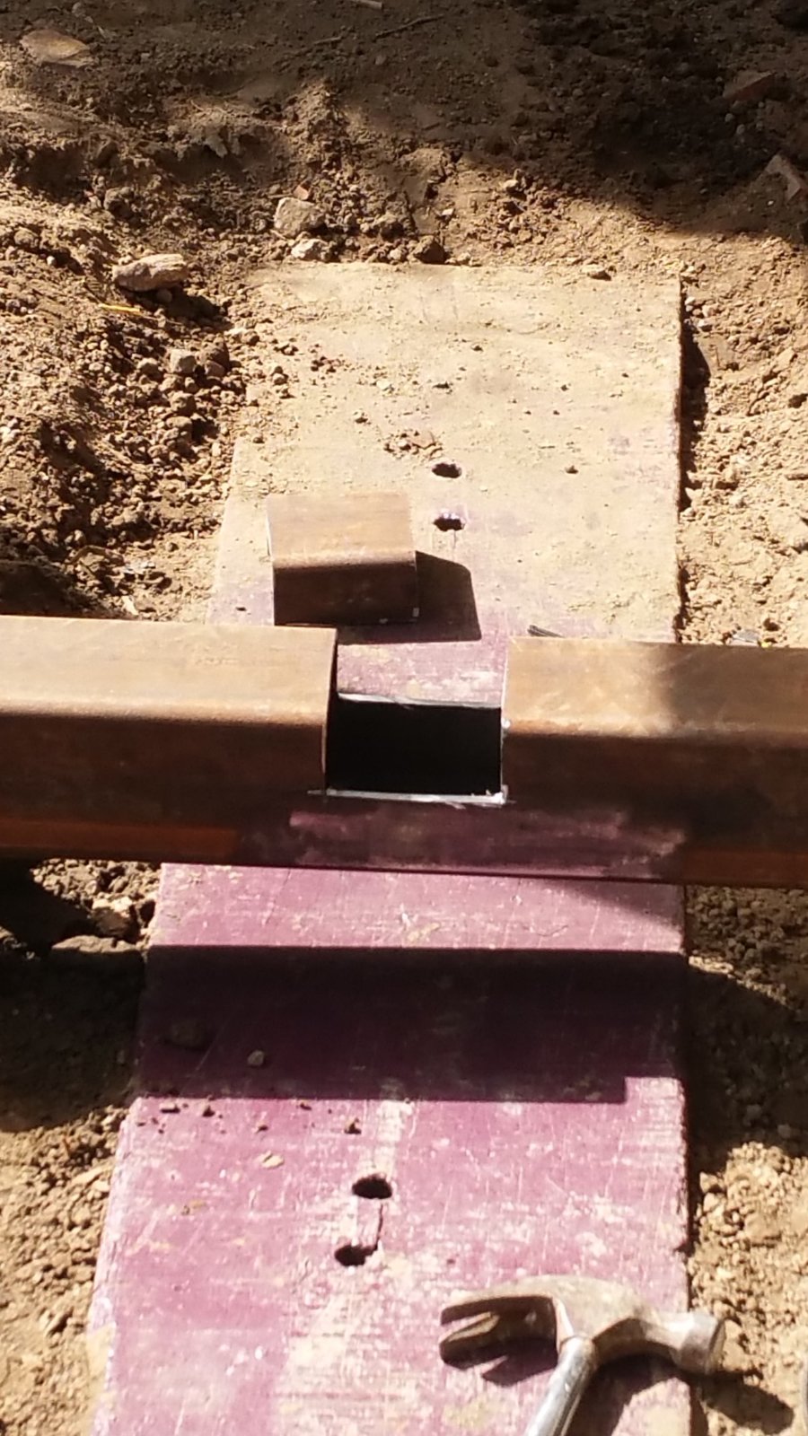

put a cup of motor oil inside the tube before finally closing them up. the heat of the welds should vaporise enough of it to coat the inside.
